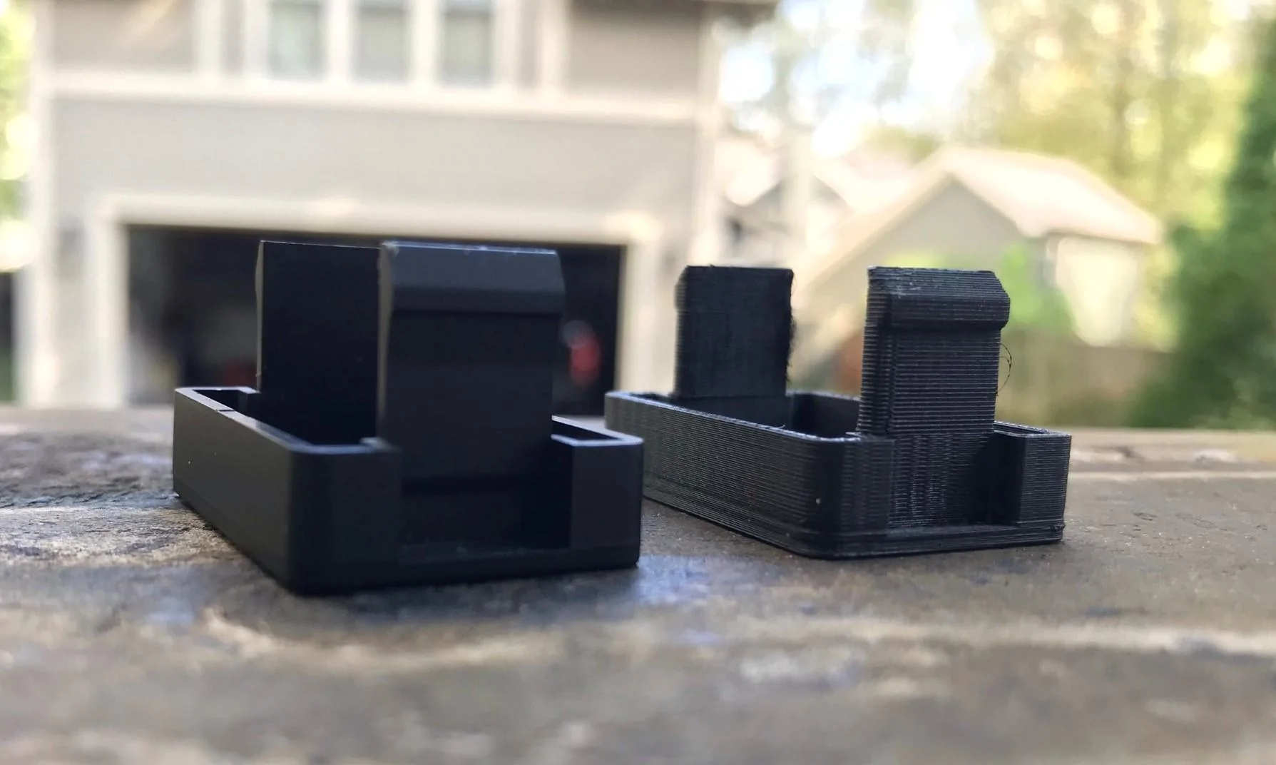

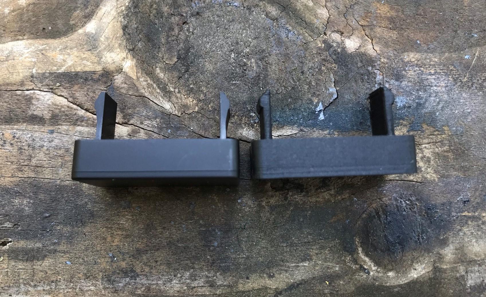

After many prototypes, I finally got something that I'm satisfied with...
The clips and their associated support structure took the longest to fine tune. My insert clips-in and holds more firmly than the stock insert.

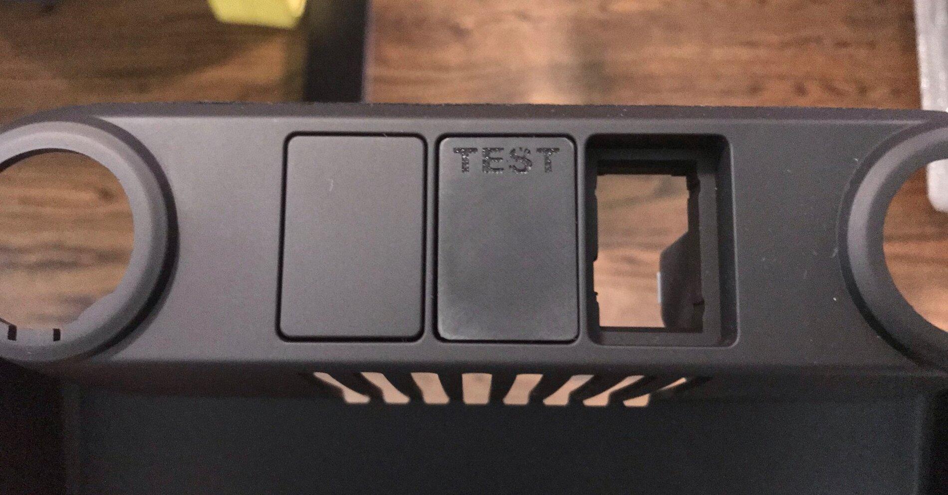

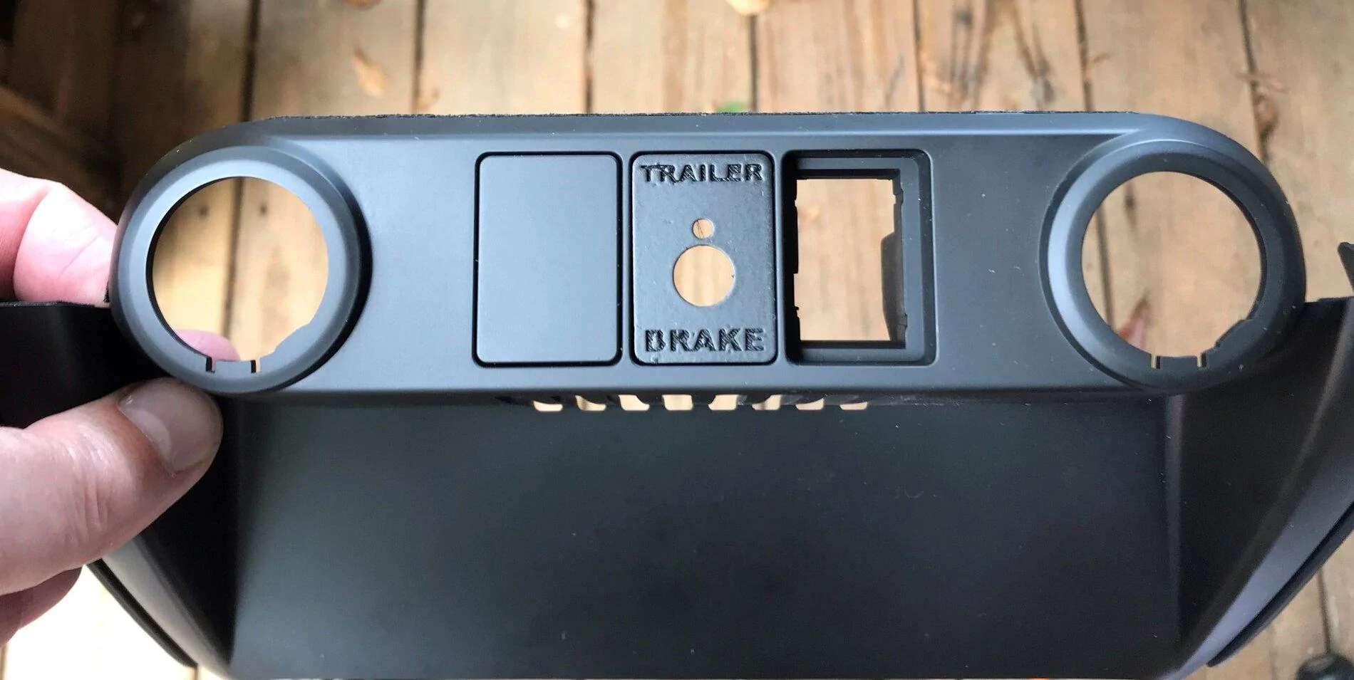

The Trailer Brake insert was next on my list. I'm struggling with the engraved text on the inserts, so I might remove that and try a vinyl sticker instead. Still, I'm very please with the results. The hole placement might also need some adjusting, but I'll work that out when I have the controller installed. The insert pictured below has been sanded and painted flat black.

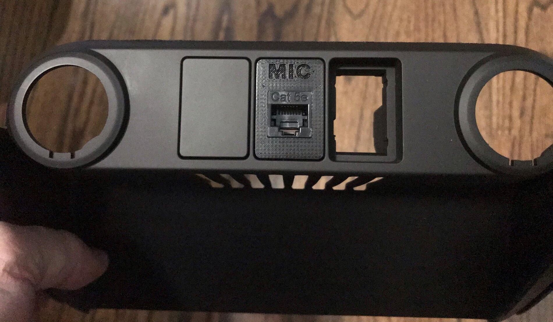

And finally, the reason I started this project...the RJ45 insert. It is still a work in progress. While the insert is mostly done, but I am still fine tuning the keystone clip for the RJ45 passthrough. Here's a preveiw...

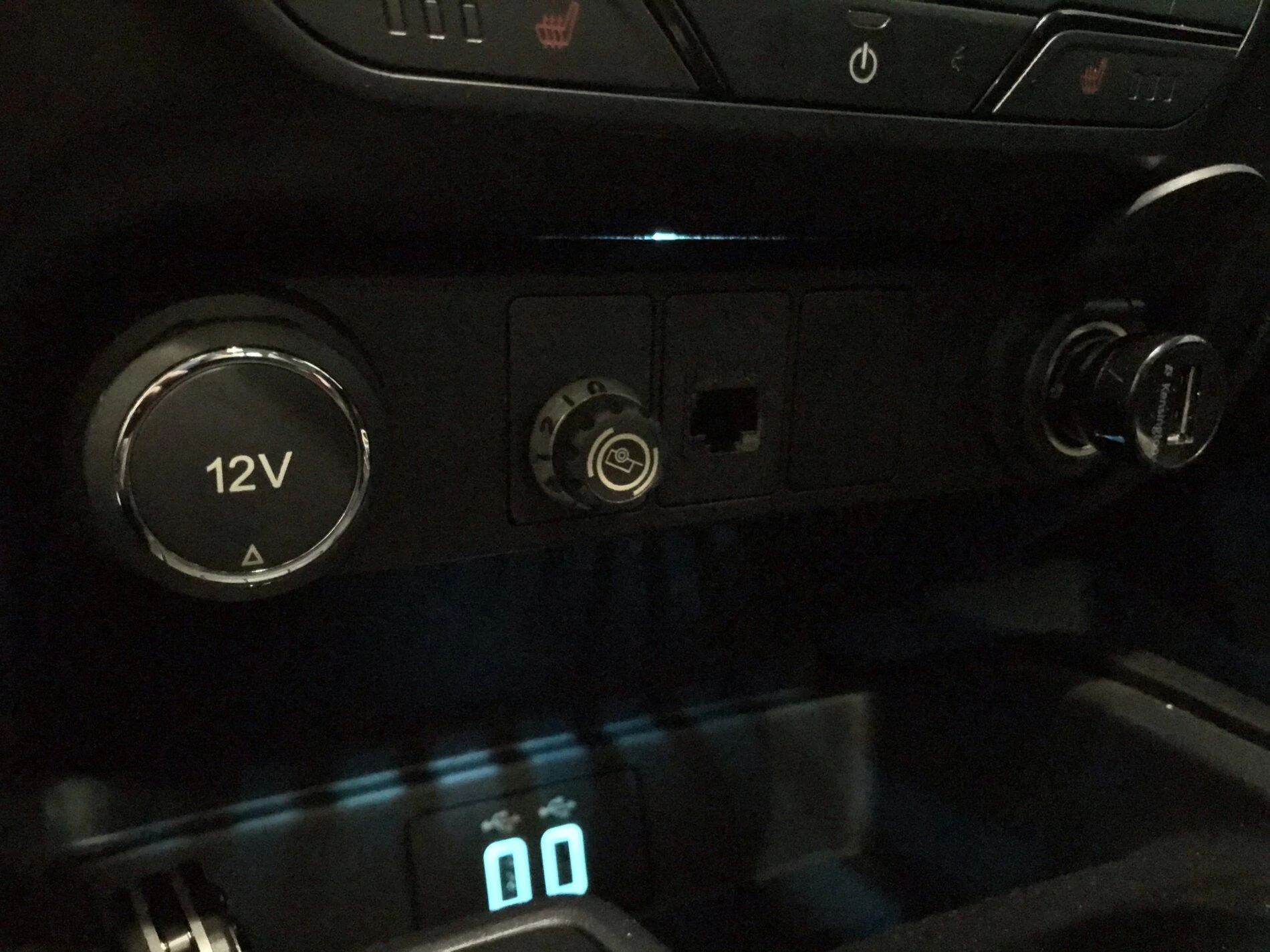

I just recently had my trailer brake controller installed and the dealer used my 3d printed prototype for mounting. Here's a picture, which is not great, but you can see the control knob in the fascia.
I have attached the STL file for my model.
