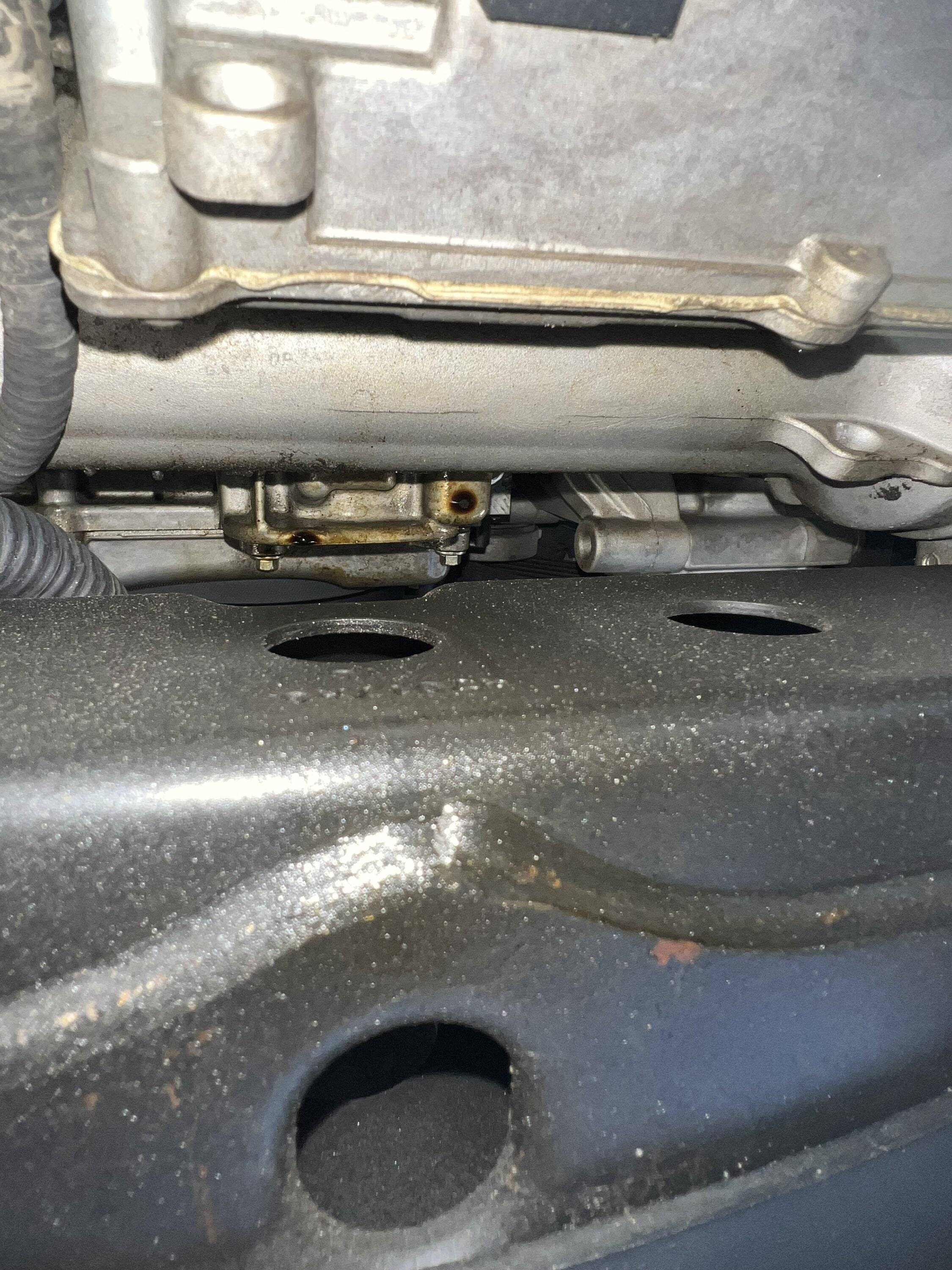

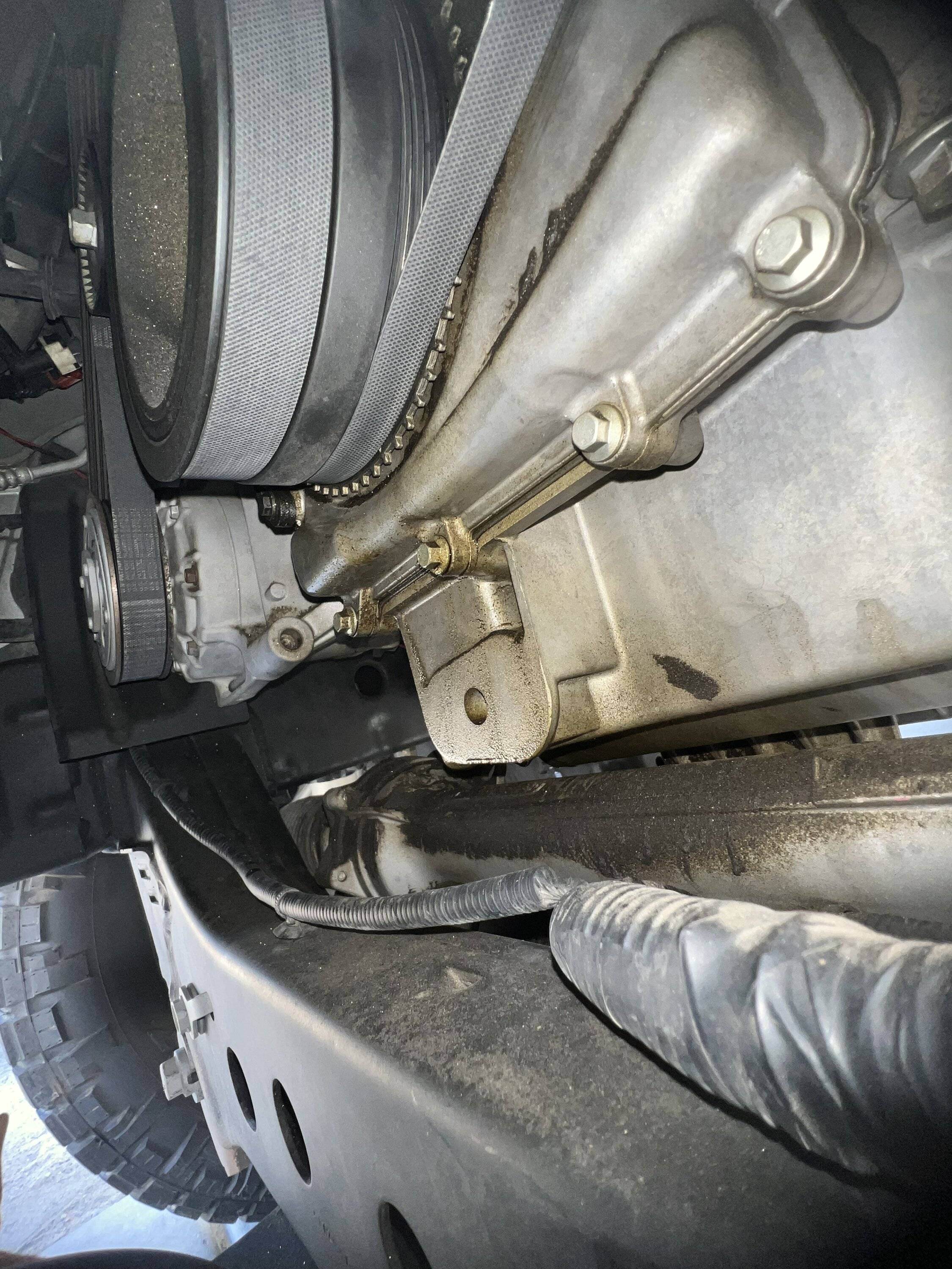

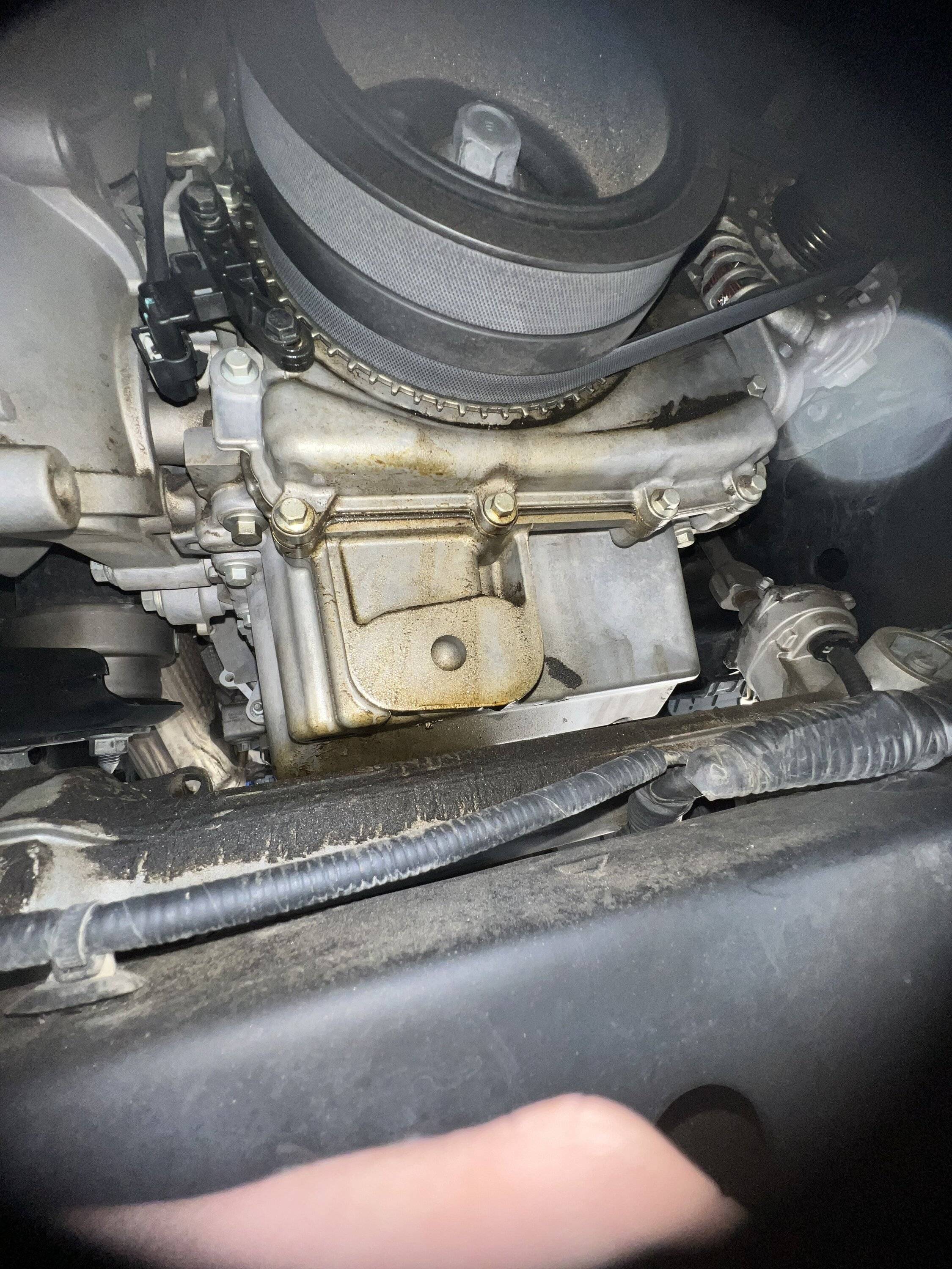

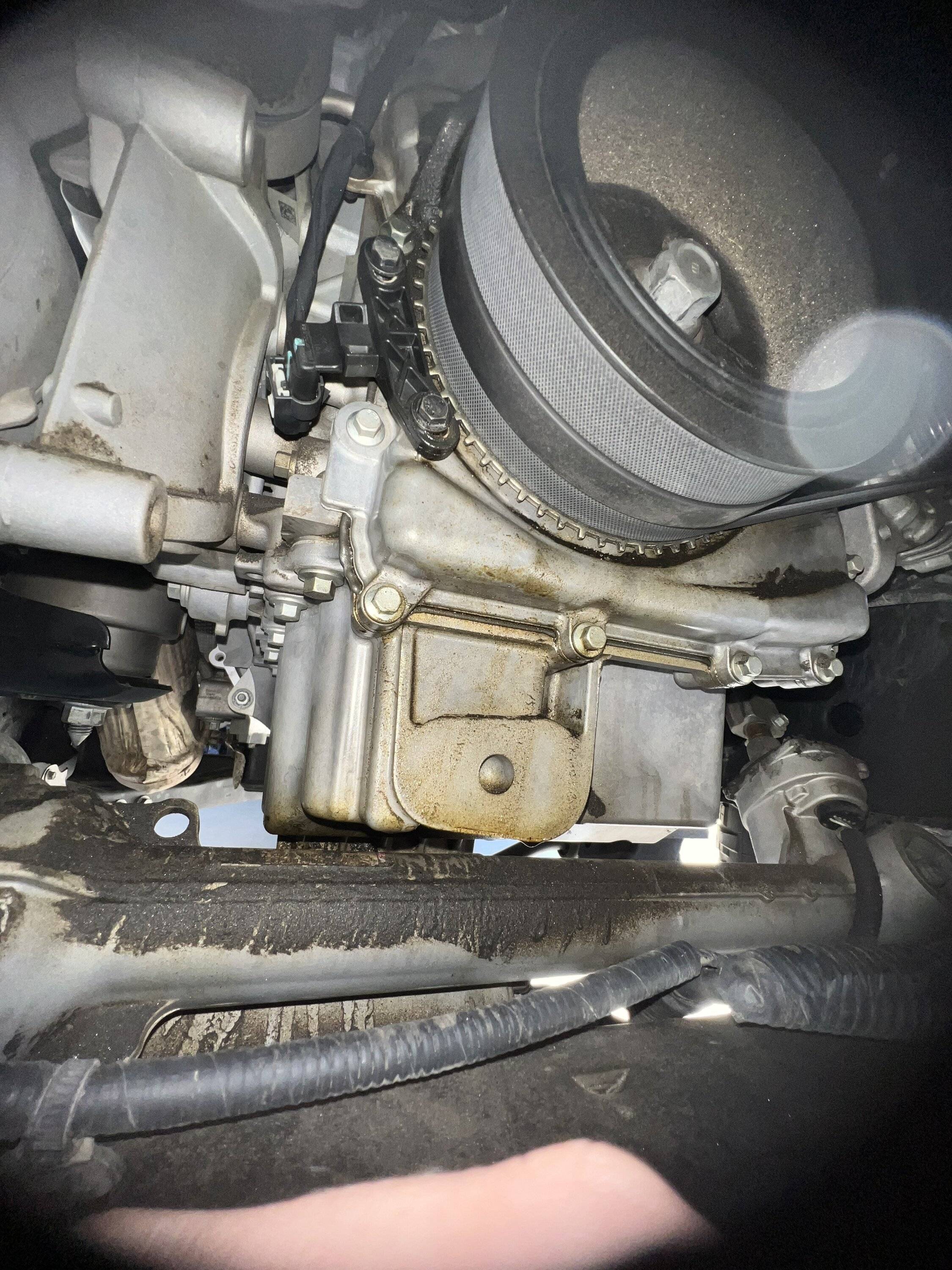

Hey all,
Ran across this thread and wanted to ask if anyone has tried to do this on their own yet? I just got my oil changed and the stealer said leaky front crank seal -
I have seen worse but with that angle sensor there it makes me a bit nervous.
