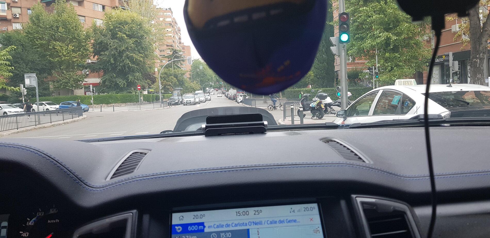

Note their is a car in front of mine in the picture below.
So I wouldn't mind adding a camera.
