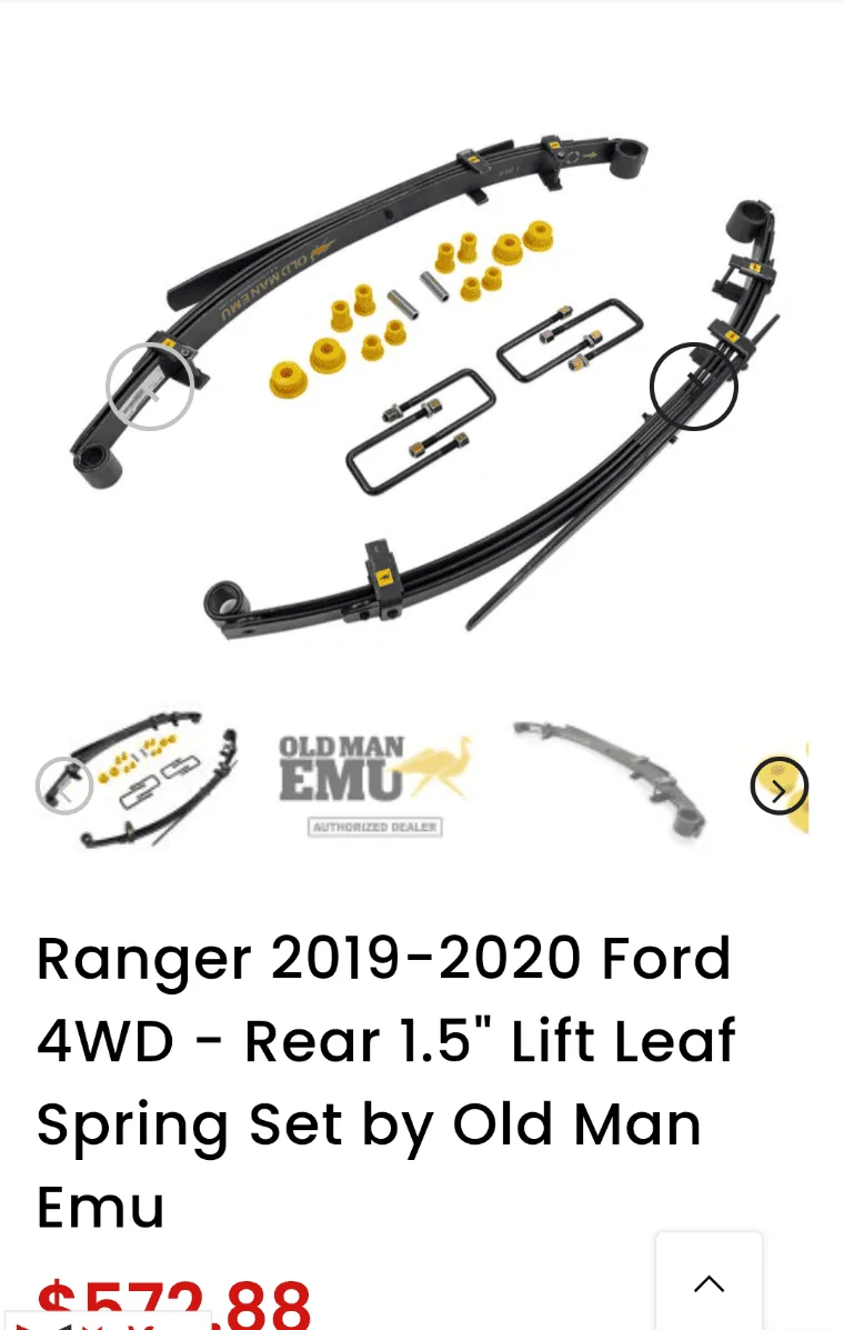

Blocks are a big no no if you are going offroad. I suggest replacement leafs like what Old Man EMU has as they have different load ratings. Also what you can do is get bigger tires as that will lift the truck as well.

I guess I need to get under and measure the blocks to see exactly what size they are before I upgrade the leaf springs. I don't want the back end to be higher. The purpose was to level n lift. That's why I was pondering having to lift the front. But if it's only 1/2" difference, I might be able to stomach that.
