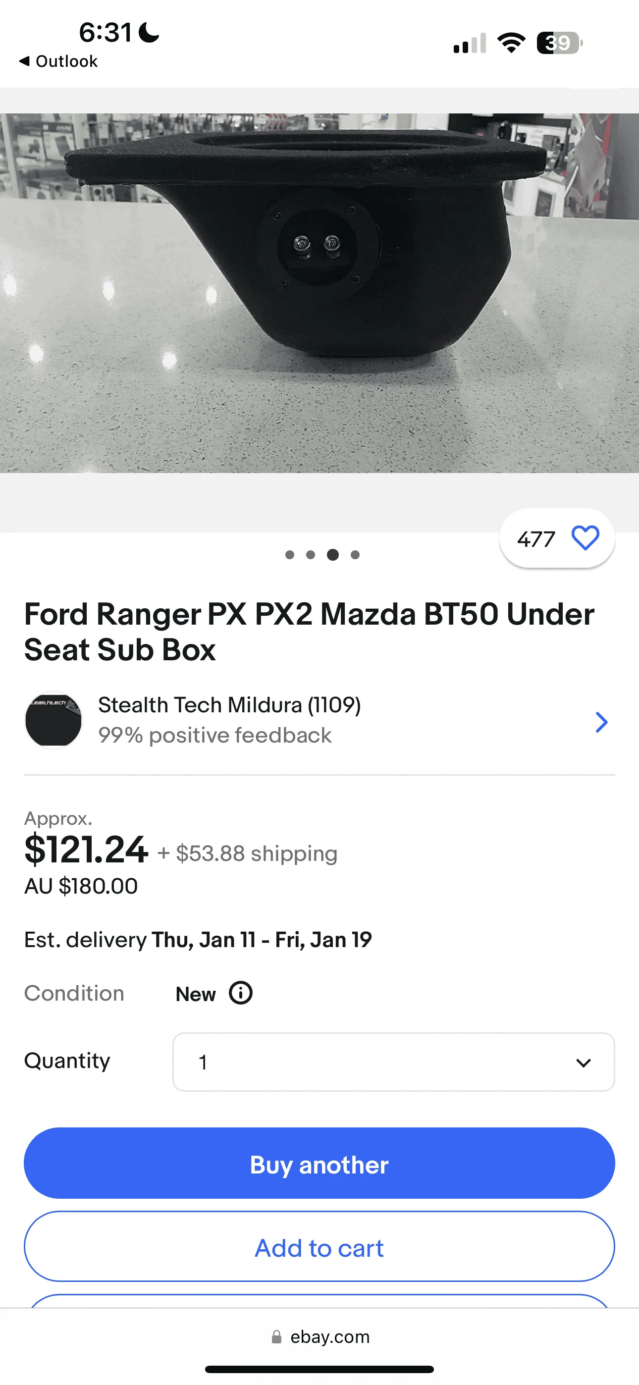

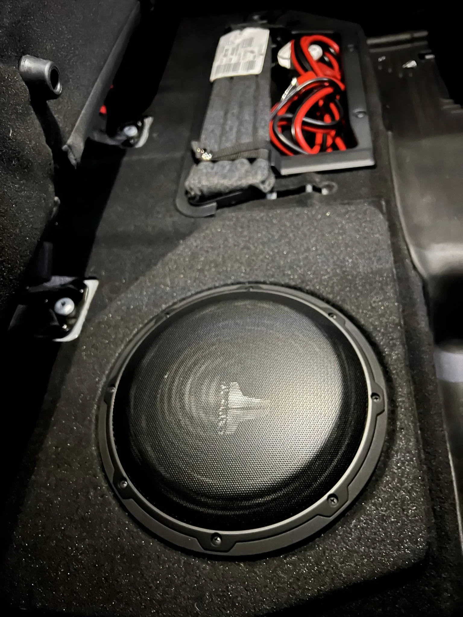

I went the the storage compartment route but ordered a prefab box from Australia. It’s not MDF so some would scoff at the acoustics. Polyfill seems to have done the trick for keeping it from sounding honky.
I had a shop install mine. I’m too leery of breaking trim tabs etc anymore.
It hits pretty hard depending on the song. 340w@4ohm but a shallow 10 with only half a cubic foot of air to move can’t accomplish a lot. I’m very happy with the sound. Would I like a 12 with room to breath? Yeah but for the compact install and acceptable performance I’m satisfied with the 10”.
Now, a note about the Rockville 10”. I had one in a 3rd gen 4Runner. Factory limited trim door speakers and a Sony AX5000 HU. It rounded out the system perfectly. The audio was honestly cleaner and a better soundstage than my Ranger with the B&O. The bad news is the Rockville probably won’t perform the same in the Ranger but may work better with the non B&O system. Hopefully someone chimes in that has a better understanding/experience than myself

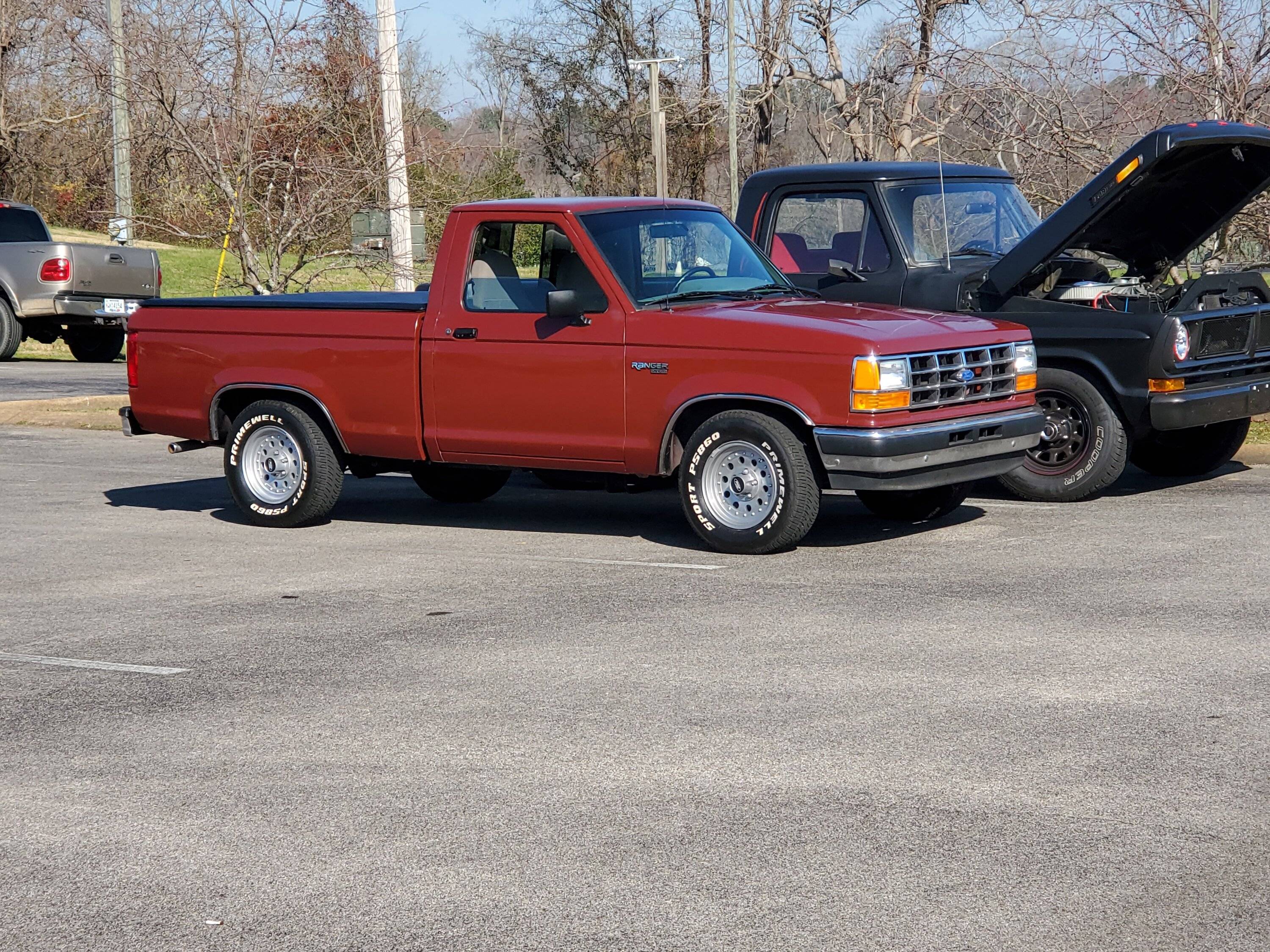

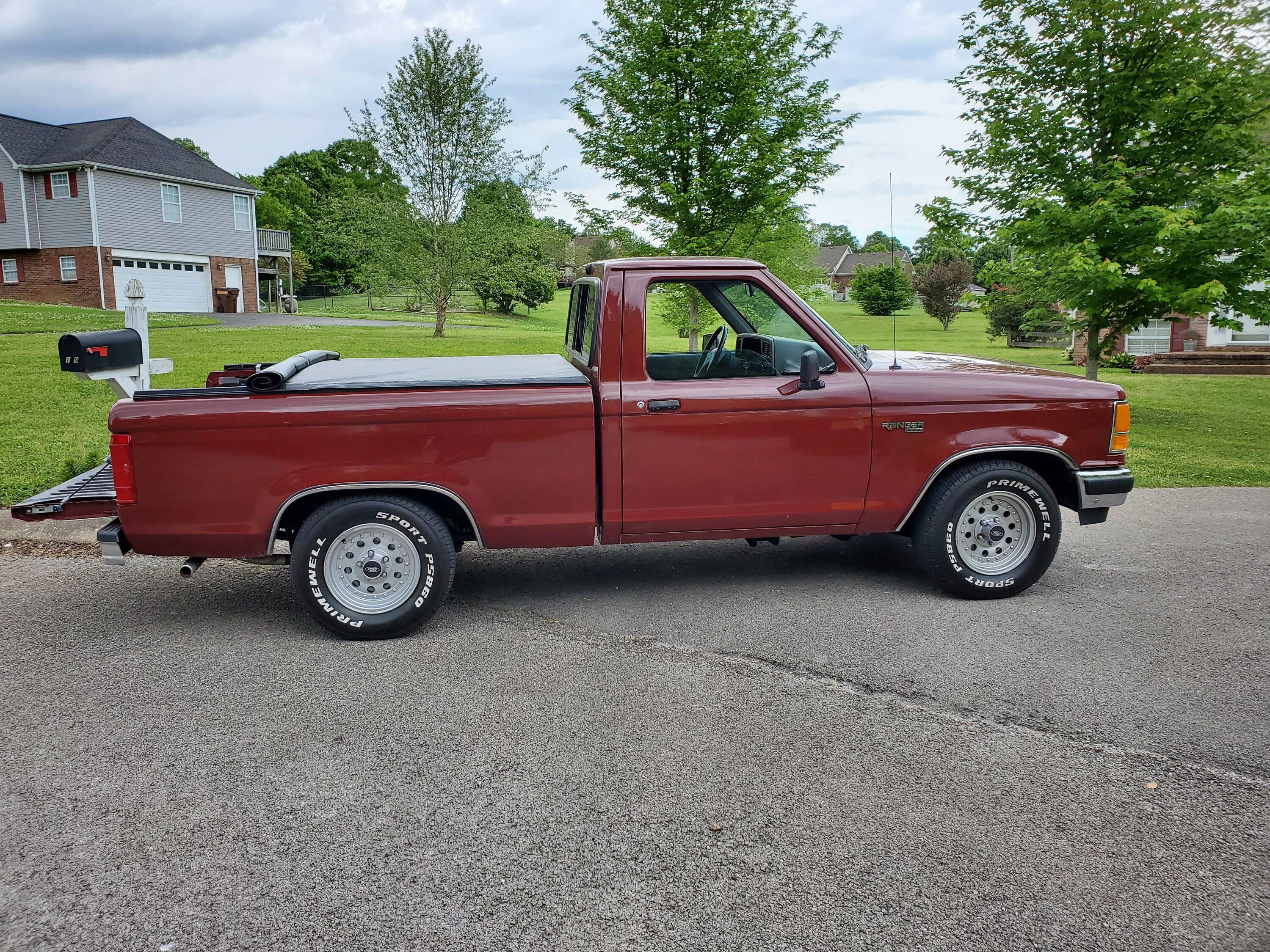

A well known law in most forums is that you must post photos of any "other" vehicles mentioned when posting about them...... OK, just kidding, but seriously, do you have any pics of that '92 Ranger ?!? I had an '89 and still love that body style !!
Here you go Rinn-
I bought this truck in December 1994. I spotted it on a car lot while on the second date with my wife. It's a '92 3.0 5 spd. The body has 265k on it now. Right before covid, it had around 250k and the timing cover gasket let go while a neighbor was using it. It drove 15-20 miles down the interstate with almost no coolant amd blew a head gasket and who knows if the heads warped or cracked. I finally decided to drop a junkyard motor in to keep it running and things got out of hand from there.
The goal was to do the things I always wanted to do in '94, but couldn't afford to, All while keeping it looking as stock as possible and reliable to drive when/where I wanted. Its not a show truck by any stretch. It gets used to haul stuff and It makes my 60 mile round trip commute to work every couple weeks weather permitting.
It now has a 3.0 long block from a 2007 Taurus and I rebuilt the transmission with new bearings, syncros, and seals. I also have an even length runner plastic upper intake from a 2000 something to swap in that should improve low end power a bit. I'm considering cleaning up the MAF housing by removing the extra material to improve airflow and converting to an e-fan. Exhaust is stock pipe with an aftermarket cat and a Thrush Turbo muffler for little more of an exhaust note.
It's lowered 2/2 on a belltec kit consisting of new front coils plus rear hangers and shackles, but to keep a bit of rake and keep it so I can use it as a truck, I tossed the worn out original leafs and swapped in 3 pack springs from an 02'ish Ranger Edge. I finished off the suspension with a rear sway bar from a Ranger Splash. It holds the road so much better than stock. I avoid driving it in the rain for a few reasons, first of which is I've always these trucks don't stuck to wet roads that well and this one is no exception, esp. With the stiffer rear suspension.
Wheels are stock 14's for now, but I have a set of 15x8 ARE's that look exactly like stock wheels that I want to modify to use factory centercaps and wrap them with 235/60r15 white letters to keep the old school look.
Outside is a 10' paint job I did in the driveway. It's Summit 2 stage in Merlot, which is really close to the factory color, with 3 coats of clear. All windows tinted to 35%, new head/taillights, new grill, headlight trim, and door handles. A soft roll-up bed cover finishes it up. And the odd thing, the tailgate works!
Interior is essentially stock with original seats and carpet. I pulled everything I reasonably could out and lined the cab with sound deadener and redid the Headliner. I swapped the left and right gauge cluster modules from an '89 B2 so I now have the factory tach with my original odo/speedo. Also swapped in the shift boot from a 93 or 94 Ranger so I now have factory cupholders. I may add a conversion to power windows/locks, but keeping the handles so it looks original. After back/neck surgeries, leaning over to roll the window down is for the birds, and the windows should be down and rhe back glass open whenever reasonable, it's a law somewhere I think. The AC does work and still has the original compressor. I did convert it to R134 though.
Sound comes from a Kenwood i've had for 15+years. Pioneer in the doors and back corners, Bass from a Boss CXX8 pushed by the Profile California amp that has been in this truck since 1995 and has powered every sub I've ever had in it.
My kids refer to it as the "Tin Can". My daughter learned to drive a manual on it and my son will this year.
Shot from a local Cars and Coffee.
Load of mulch bags here and occasional runs to the trash dump. The bed on it is bigger than the 2019, lol.
I really need to take a photo of it beside my 2019 XLT Sport 2wd. The 19 is at least the size of an early 90's F150. The 19 is stock outside of a Mountune intercooler yhe previous owner installed and a tri fold bedbcover.
