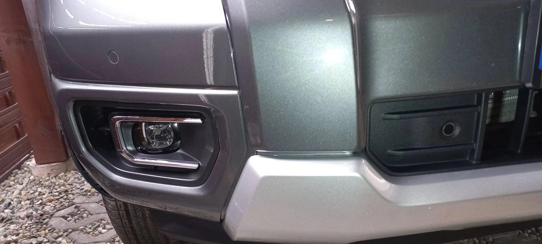

I don't have 360 cameras

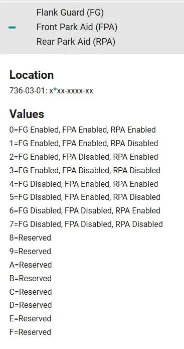

I checked varying trims for the 2024 Ranger (US Version) XLT / Lariat and Raptor with the Raptor having the 360 Camera. None of them list (736) as a module location.
However, in the manual it lists 736 as the module location for the PAM, so I am confused here and would need to actually find a 2024 to plug my scanner into to figure this out.
It should show up on the HS2-Can network.
