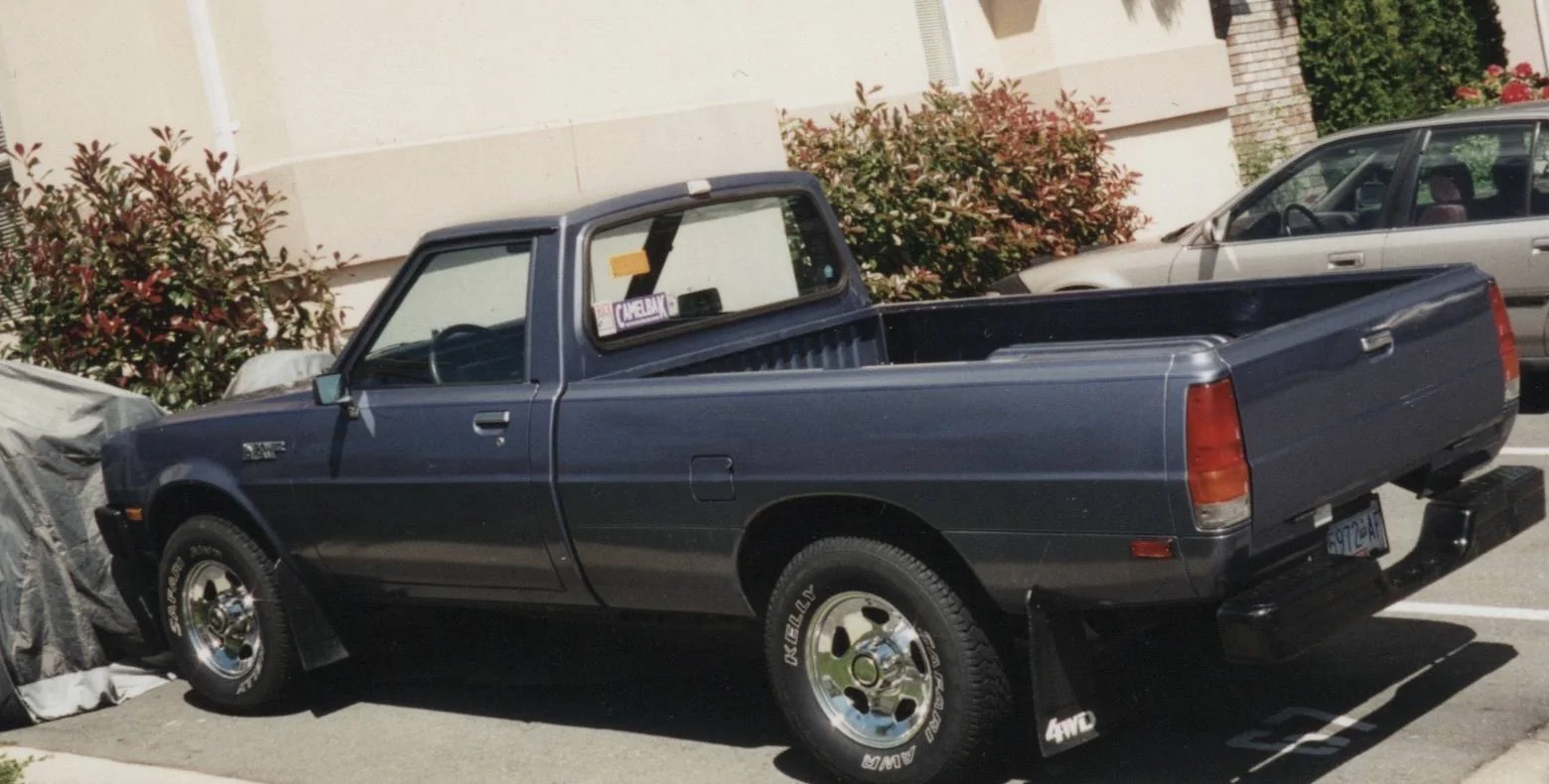

I had a little Dodge Power Ram 50/Mitsu that was manual everything - transfer case shifter on the console - crank windows - would do 0-60 with a tail wind. ;)
