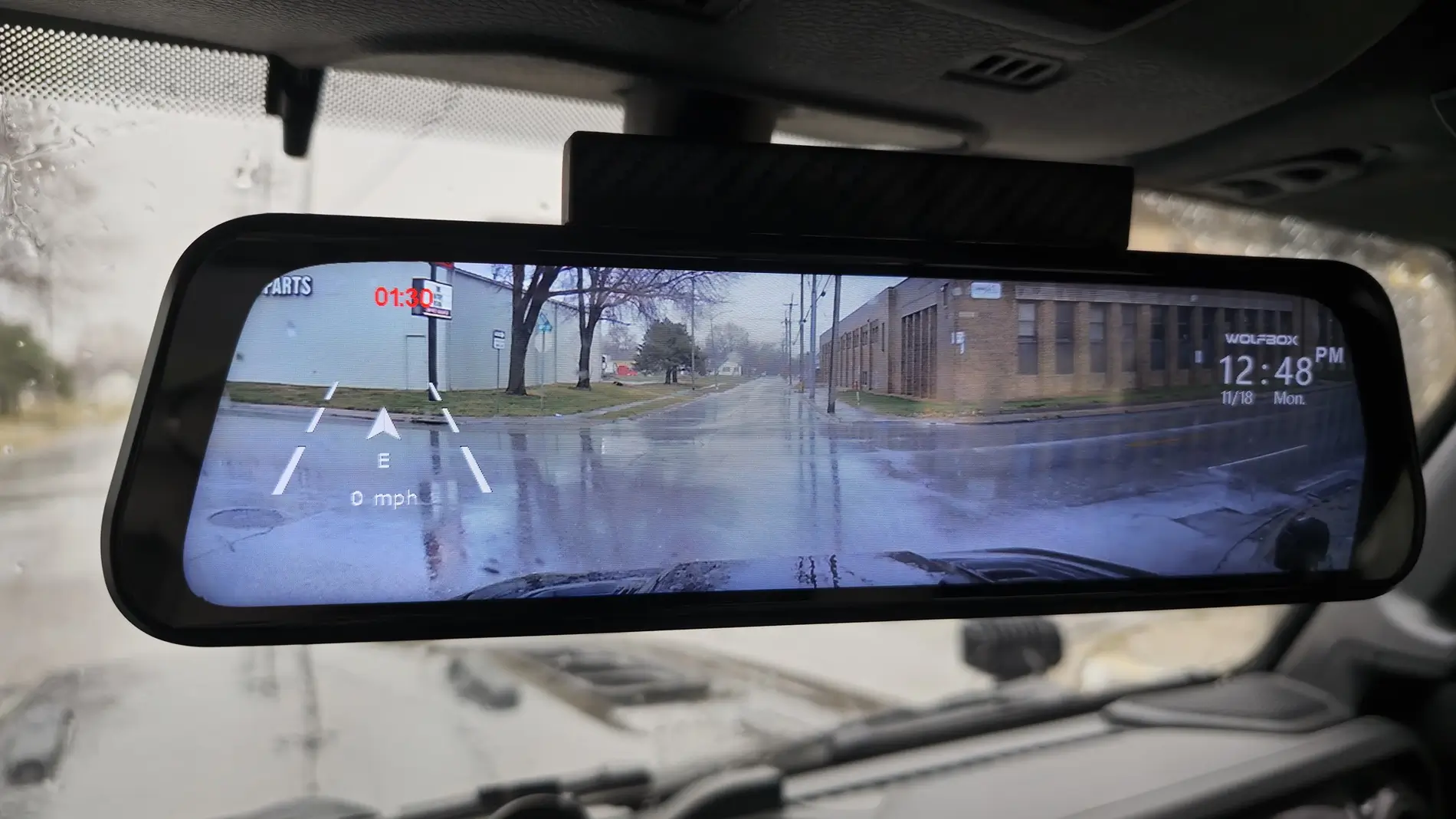

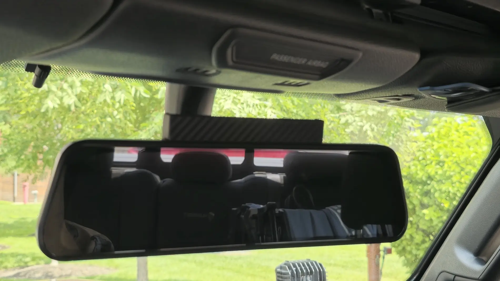

Strapped to the OEM Mirror
My Ranger‘s manual-dimming rearview mirror is much slimmer than the auto-dimming version and I’m happy with simply using the shorter of the supplied rubber mounting straps to hold it in place. I used a thin layer of toolbox drawer liner to protect the OEM mirror and to prevent the Wolfbox from sliding around. Thin cork, felt or other suitable material could be used instead of toolbox drawer liner.
I’m happy with the result. To finish it off, I fished the cables through a large 1-1/4” grommet that fits in a 1” hole drilled into the upper pre-collision system cover. It’s not necessary but it sure finishes it off nicely.
