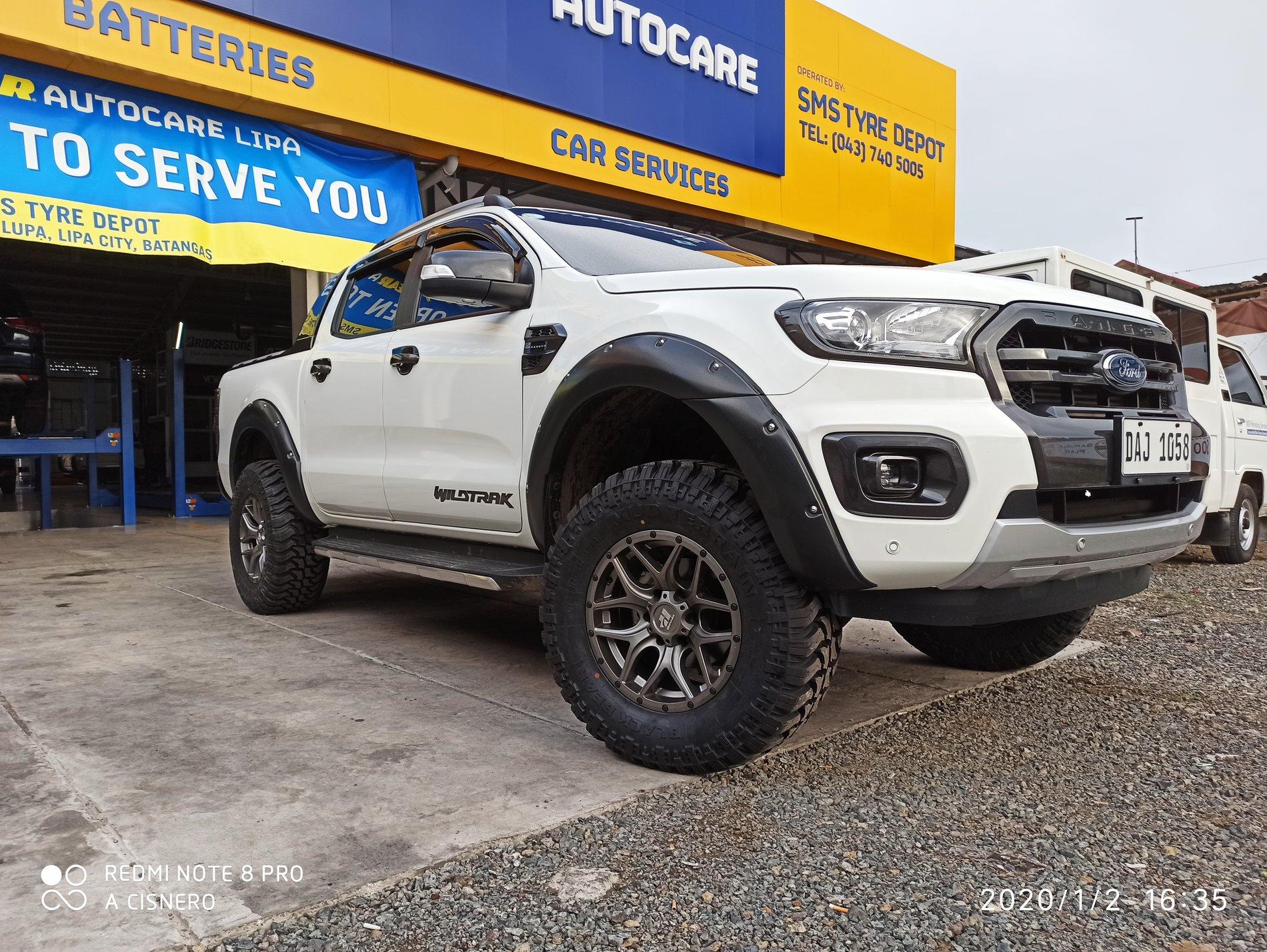

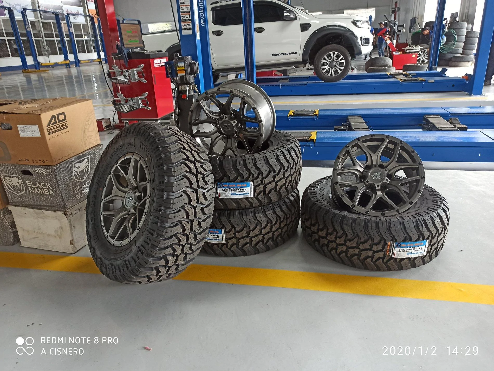

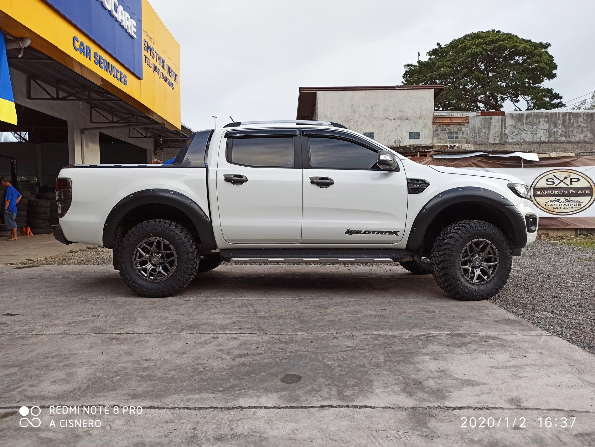

got may 3 inch lift kit delivered 3rd week of december and have it installed last Dec. 30...have the bigger tires installed today.
if you guys notice its a wildtrak because im in another part of the word in the philippines to be exact.
I used a 17x9 inch Barreta Hussla mags et 12 with a 285 70 17 mud tire. install was easy and i got no issue no rubbing no trimming. i really love the fact that is takes a fewer step to install than other lift kits.
Ride after the install i think was better with a lot less bounce. tire have 35 psi all four of them.
if ask would i recommend to a friend...Yes
thanks Rob your a genius

Looks fantastic. So glad it worked out. Truck looks amazing. The 285/70/17 fit with no trimming is cool especially on a Ranger ford wildtrak in the Philippines. I just expanded my market reach. Thank you so much.

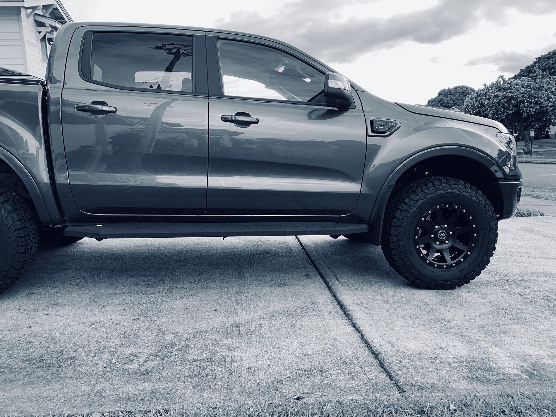

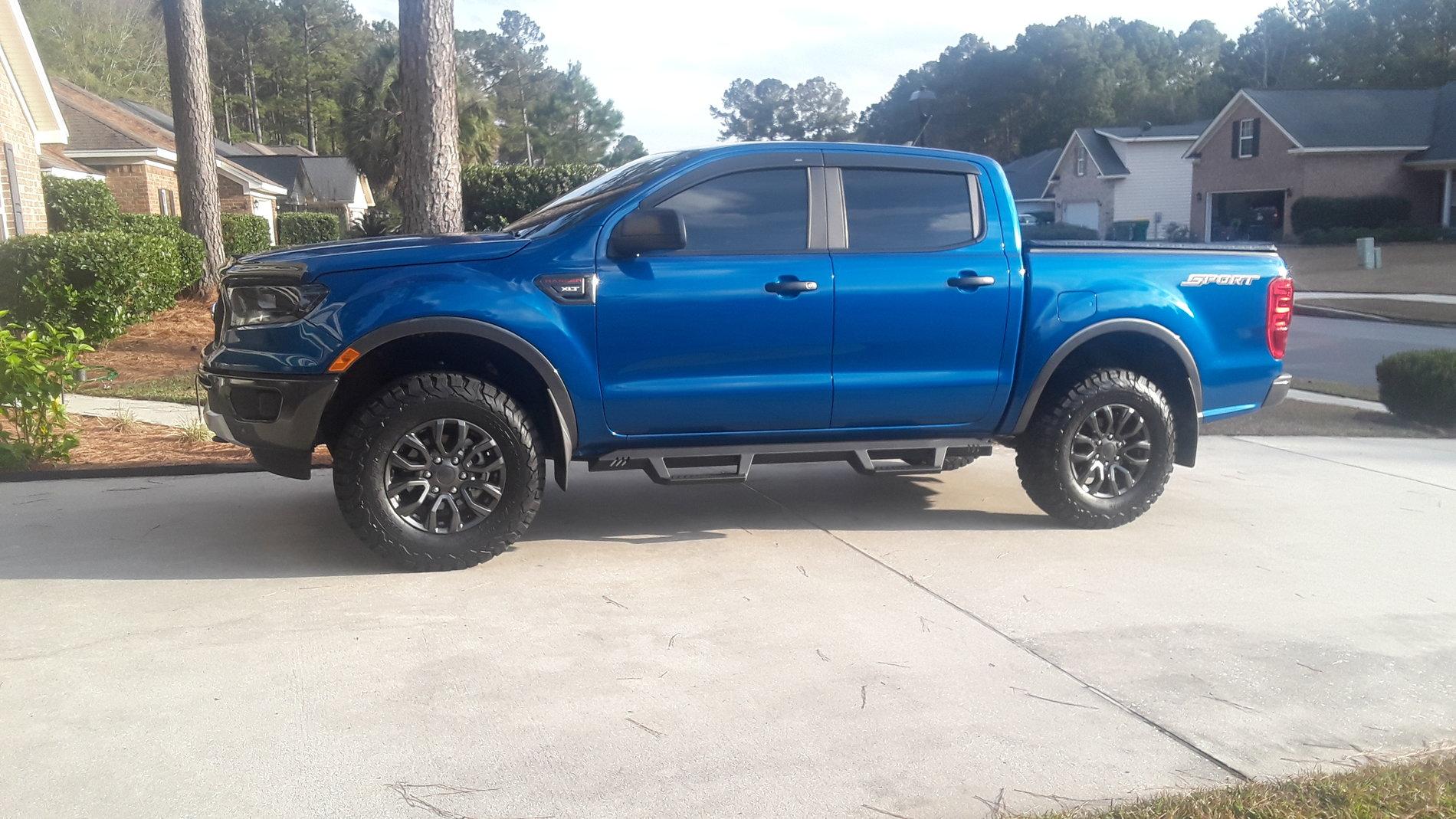

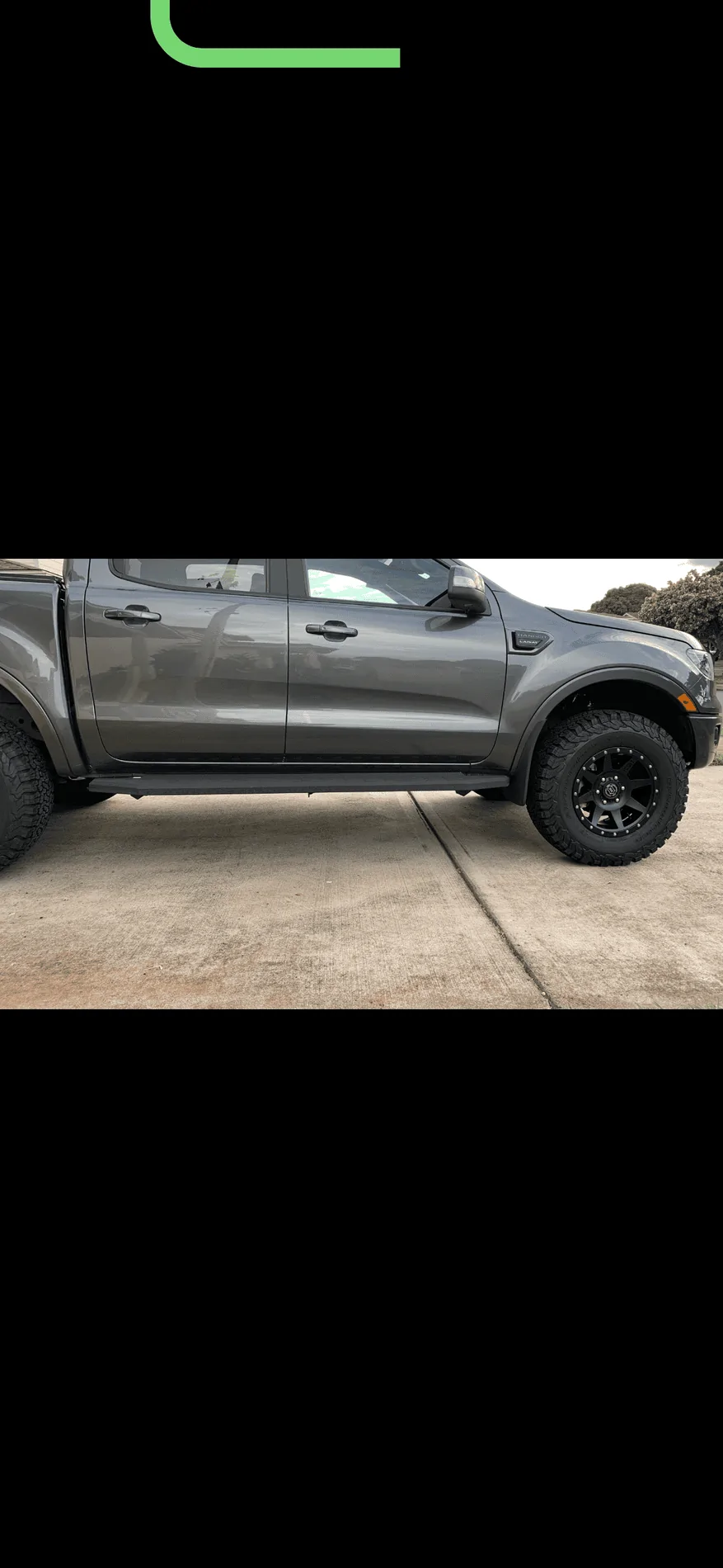

Finally got my tires on months after I installed my level so I felt like I should leave this right here, thanks Rob!
Wow. Looks good. I like the steps. How do you like how it drives?
Rides nice, a lot of the bounce is gone. I don't know , maybe the stock tires were lower pressure and softer, not sure but its better.
What size tires are you running on your truck? I am waiting for my kit to arrive from Robby and want to make sure I am looking at the right size tires.
