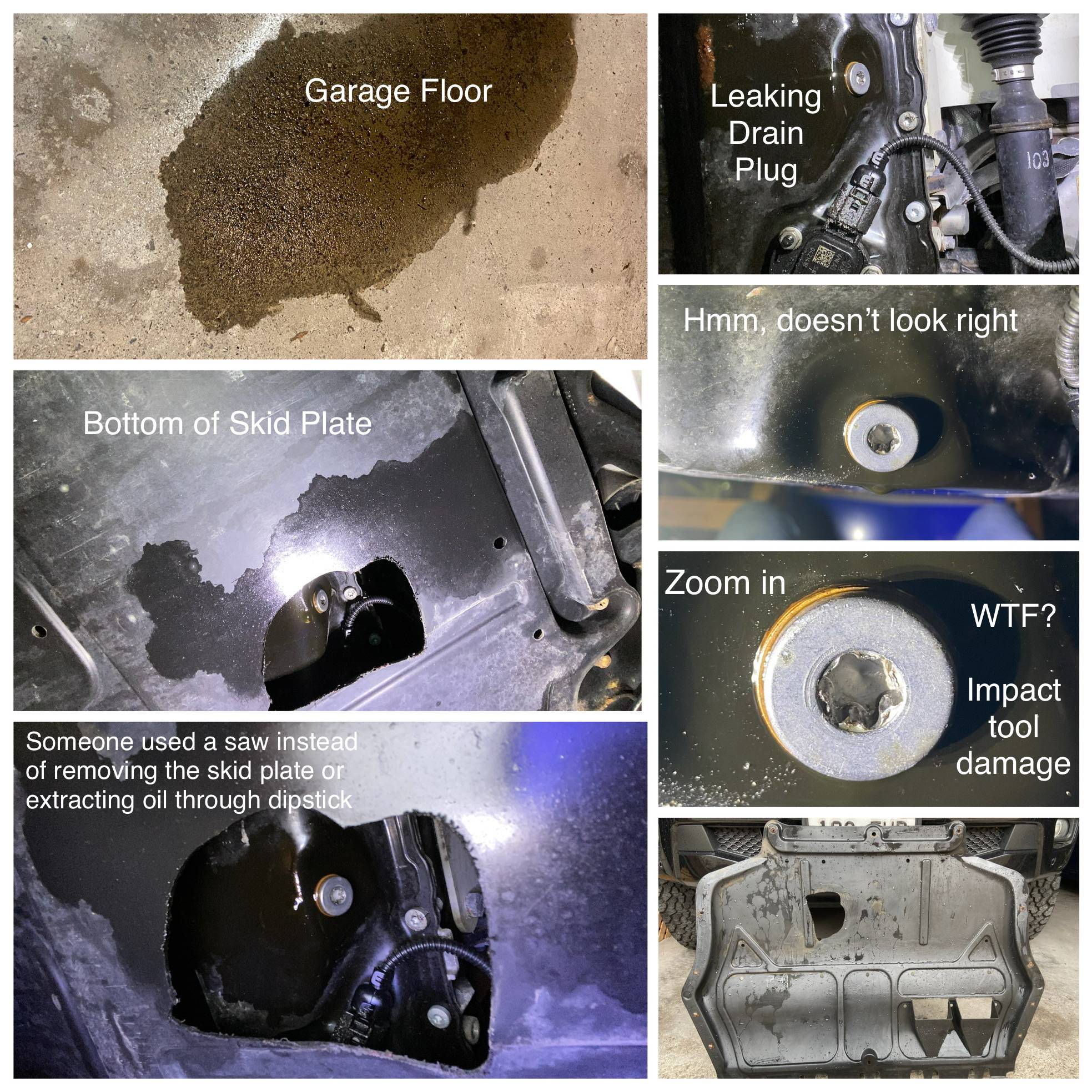

Changing the oil in my Passat is a challenge. It’s low to the ground, has a skid plate to remove, and my garage is tight. I did it once and it was a pain. After that, the small shop around the corner got the job for the next several oil changes. They eventually moved so I was likely going to be doing it on my own again.
The car was in the VW dealer for a minor recall, so I had them change the oil. When I picked it up, the advisor asked me if ever changed my own oil. I said I did on my truck but it was a pain on my Passat. He then told me the previous place chopped a hole in the lower skid plate, likely to access the drain plug. I looked and it was butchered. Bastids!
I recently took it to my local Ford Dealer because they’ve been great to work with and The Works is usually on sale. A few days later, I noticed a small puddle on the garage floor when I backed out - it looked watery and didn’t smell too oily - I thought it might be a mix of water and oil from the service, followed by a car wash - maybe water from the underbody sprayer got up through the hole in the skid plate and was draining. The oil level was fine, so I cleaned things up and didn’t worry too much about it.
After it sat for a month (I drive my Ranger whenever I can), I noticed a puddle by the front tire - checked the oil - bottom of the hash marks - called Ford - advisor checked with tech - he remembered the skid plate - recalled extracting through dipstick - recalled accessing the drain plug to check for shavings - we can get you in next Tuesday - CRAP! Is it the filter, the drain plug, something else? Up on the ramps it went and I took some pics, off came the skid plate (no sign it had been removed for the service) and twisted myself like a pretzel for more pics.
The drain plug is leaking - a slow drip - looks like someone went at the drain plug with the wrong tool, wrong size Torx bit, SAE vs. Metric, Hex key, or an impact tool, so I took photos of it and left it alone. Not touching it. Was it the Ford tech? Those other Bastids? Was it the VW Dealer - surely, their oil change bay has all the proper tools, right?
I guess it could have been any of them but that drain plug is a $20 part - I have no problem with, “Hey Duke, it cost a few bucks more than we thought because your oil drain plug had to be replaced - our tech was lucky they could get it off - here, take a look at your old one.”
I will likely just order a new plug, swap It in, and top it up. Oh, I’ll also order a new skid plate ($70).
Just now seeing this and I just can't believe how lazy/dumb that person was. Seriously, the belly pan is only held on with 3 M8 bolts on the backside and like 7 0r 8 T-25's along the side. probably took him longer to cut the hole then it would have to zip off the bolts.

I am guessing they used torx instead of triple square on the drain plug.

Not really sure, but vw/audi like triple square. Most of the time there is a torx that will work. My wife's TT does not have a drain plug. I use a fluid extractor for oil changes.

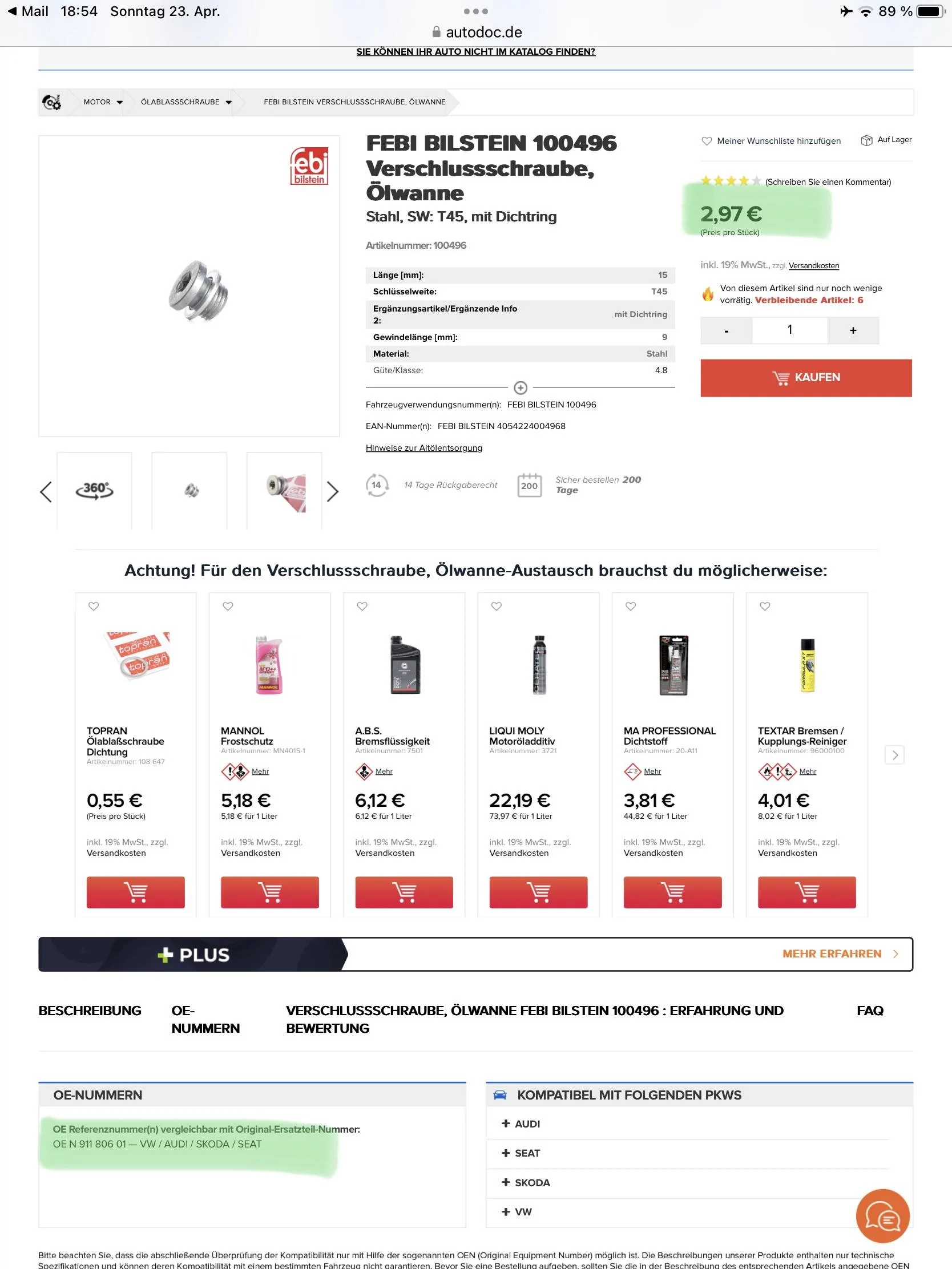

Were I needing a new drain plug, would just buy one of the same thread size but a hex head.
For good measure perhaps magnetic type.

As much as my back will hate me for it, I’ll be doing them - got me some of these…
One for now, one for next time.
I am curious. Is it the same sparepart number than in europe?
N911 806 01
