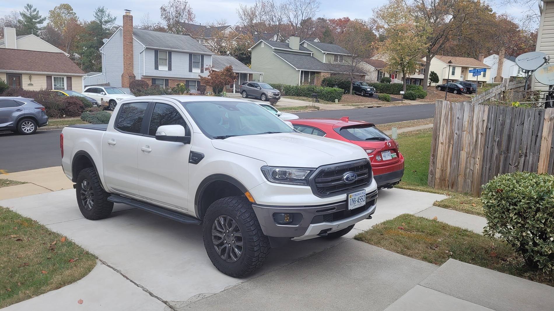

I have had a 2 1/2 " lift for last 40k miles. I lost 1-2 mpg From just the lift. Adding 32" tires another 2-3 mpg. I did the lift then the tires about a month later.
Nice truck OP! Looks a little familiar

Nice truck!
What size tires did your truck come with?
What lift did you use ?

Nice truck!
thanks, Sportz
It came with those crappy Hankooks that fx4s come with. Now it has Cooper Rugged Trek 265/70/17 with Eibach Pro Truck 2.0 set 2 1/2 inch lift in front and 1/2" blocks in the rear. Also have Icon UCA
