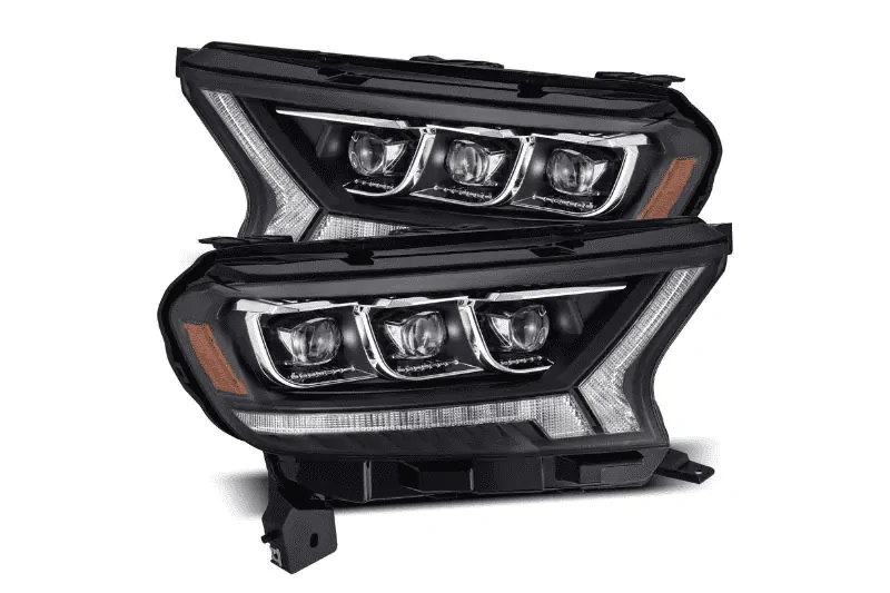

2019-2022 Ford Ranger AlphaRex NOVA Series Black LED Headlights 880124
Highlights:
  • Plug-n-play direct replacement
  • Patented signature 3D ice-cube projector lens
  • Sport and Luxury in one light with a glossy look mixed with the black paint with smoke DRL lens
  • Polypropylene Black housing and polycarbonate plastic lens
  • Dual coated lens with anti-fog agent and preventative yellowing and oxidation coating
  • SAE and DOT Compliant
The LED Headlight Upgrade You've Been Searching For
AlphaRex has a solid track record when it comes to aftermarket lighting. These NOVA-Series are a bolt-on replacement for your factory halogen set up, a true plug-n-play set up there is no need wire, splice, or purchase additional looms for this LED upgrade. The functionality and look of these lights are the perfect upgrade for your Ford Ranger. AlphaRex uses their patented signature 3D ice-cube projector lens and are the key components of the NOVA-Series. The ice cube design allows the light output to shine when viewed from the side giving the light a 3D look. Along with the horizontal NOVA projector row, AlphaRex also added an LED tube next to the grill as DRL and sequential turn signal. The LED tube is not only used as a switchback DRL and turn signal, it also has the activation light feature which is a lighting sequence when you unlock and lock your vehicle. These projector headlights are with three projectors design, with the outer 2 projectors as low beam, and inner projector as high beam. High-Quality LED Lighting
The projectors apply the LED chips and are developed in the AlphaRex factory, making the projection cut-off line is perfect for American LHD regulation. The Ford Ranger NOVA-series projector headlights have a Polypropylene Black housing and crystal clear lens to give your truck a sporty look and makes it easy to match the lights with any color truck and front grill. The Black housing is specially designed with a glossy look mixed with black paint and smoke DRL lens to give your truck an all-black sporty and luxury look at the same time. The NOVA-series projector headlight lens are made from strong polycarbonate plastic and also have a layer of anti-fog agent on the lens for optimal light output in extreme climates and another coating to protect the lens against yellowing and oxidation.
The Ford Ranger NOVA-series projector headlights are compliant with SAE and DOT FMVSS108 regulations, and are certified to ISO-9000, ISO-9001 and ISO-9002. Since the headlights have a DRL feature you will need to apply the DRL module included in the headlight kit. No modifications are required for installing these headlights since they are plug-n-play direct replacement for your truck. The AlphaRex headlights are easily removable when you need to return or sell your truck and it will not void your factory warranty.
Specs:
  • Fitment: 2019-2022 Ford Ranger
  • Lens Color: Clear Lens
  • Light Feature: Activation Light, Switchback DRL and Sequential Signal (Light Tube)
  • Feature Color: White DRL, Amber Signal
  • Light Source: Built-in AlphaRex Luxx LED
  • Low Beam: AlphaRex Luxx LED
  • High Beam: AlphaRex Luxx LED
