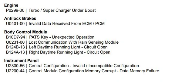

I've brought a ranger with a blown engine, Had a recon engine fitted with a new turbo, inlet and exhaust manifold all new gaskets etc
The truck goes into limp mode when cruising at around 55mph, i can drive around under that speed with no issues. i had the engine smoke/leak tested and they couldn't find a leak. these are the codes...

I do not really know the 3.2 Disel but as long as all the induction piping is secure.
I would check the PID values for the Boost Press Sensor and By-Pass Valve to ensure proper operation as well as the wastegate actuator and all associated wiring and connectors.
I do not have the ref data of what the (normal PID values) should be for the 3.2. I suspect a bad by-pass valve or pressure sensor, but you would need to view live data PIDs to confirm.
