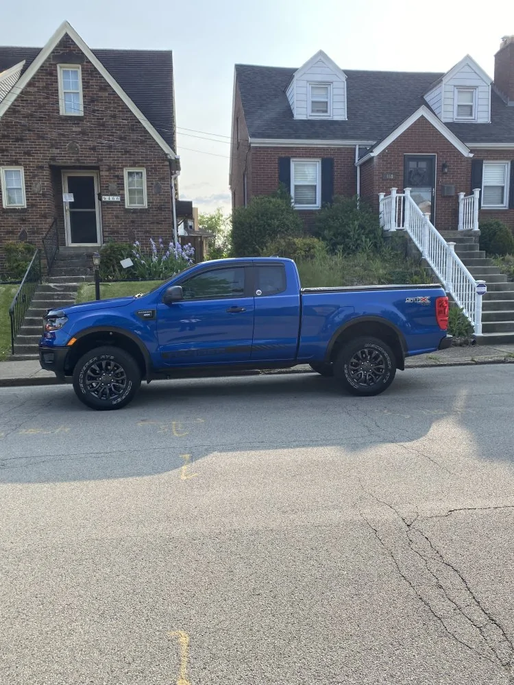

I like your blue supercab @JohnnyO!

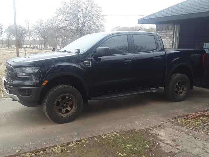

I had the Bilstein 5100s installed and had the fronts set at 1.8. It firmed up the ride and made it look better.

That it does! Factory springs?
Yes, it is still on the factory springs.
Good eye, and Thank you for the compliment!
