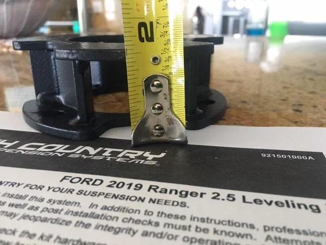

I just got my Rough Country 2.5 inch leveling kit but the leveling struts/collars only seem to measure 1.5 inches. Did they send me the wrong kit or is this the correct measurement? If so, will it truly be a 2.5 inch level and how do they achieve that? Appreciate any responses.
Yes, the struts are inboard of the wheels so when the strut moves down that 1 1/2", the wheel will move the expected 2 1/2"
