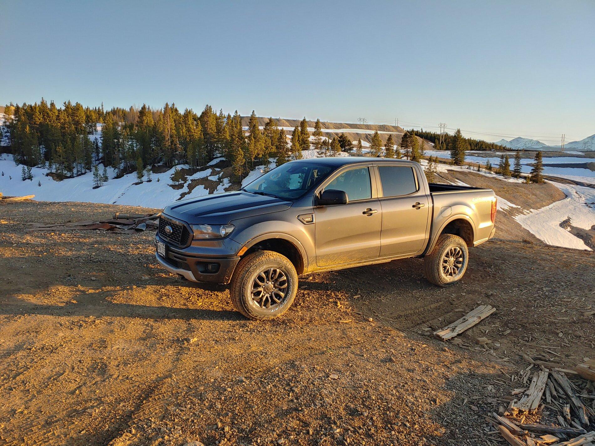

I would assume that it is possible. Others on here would have to confirm that since I myself have the factory wheels and no spacers. Just the Old Mam EMU lift with 265/70-17 tires.

Correct. I have no issues with stock wheels. I have the sport wheels and it is just fine. Even without the lift or level they will fit on factory wheels but if you change the wheels there is a chance you would need to add the lift or leveling kit.

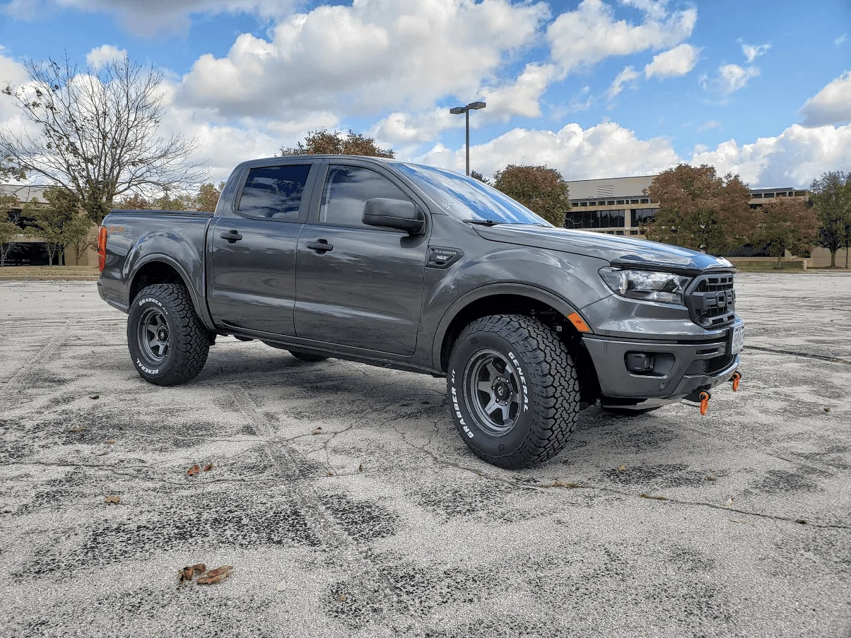

With that size tire you might be ok but I'm thinking you'll need to remove the rear crash and blocks behind the wheel liner, then pin back the wheel liner with the bolts you removed from the plastic block.
Same wheels specs, 285/70 on mine. Front and rear crash bars removed and plastic blocks removed.
