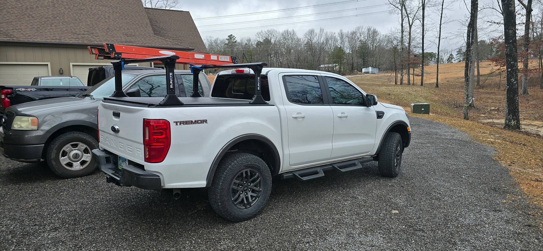

Possibilities are endless with racks… Whether or not they’ll work with your bed cover is a different issue. I had to modify mine slightly to make it fit. I cut the ears off that wrap into the bed and bolted it down straight from the top. My cover sits inside the bed rails so it was easy to make it fit. My wife’s cover sits on top of the bed rails so modifying a rack to fit her truck would be a different animal.
The rack I chose for my truck is made by Allied Expedition but I’m not sure if they’re in business anymore. It’s cab height but the back crossbar sits lower than the front so it works with my kayaks and ladders.
