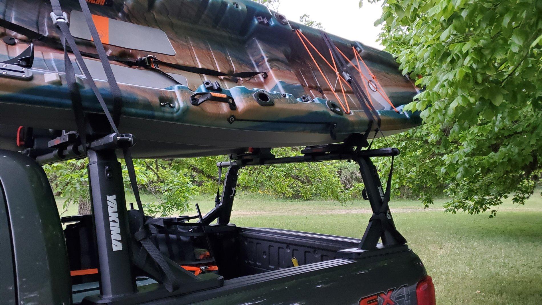

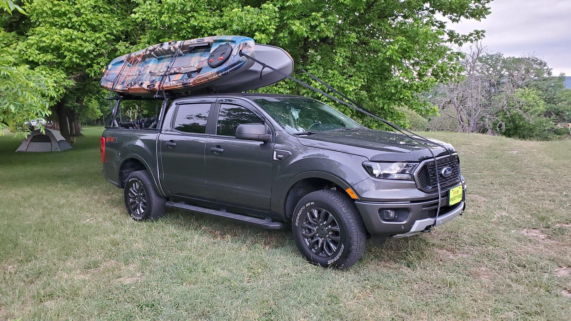

I know this probably doesn't help at all with your canoe and rack dilemma but after doing a bunch of internet searching I ended up with a Yakima system. The Yakima Overhaul HD rack and two kayak holders. It was indeed pricey but hopefully we can get many years of use and abuse out of it.
My reasoning for going with this system was the versatility of it. There are just so many configurations I can use for everything the family and I want to do.

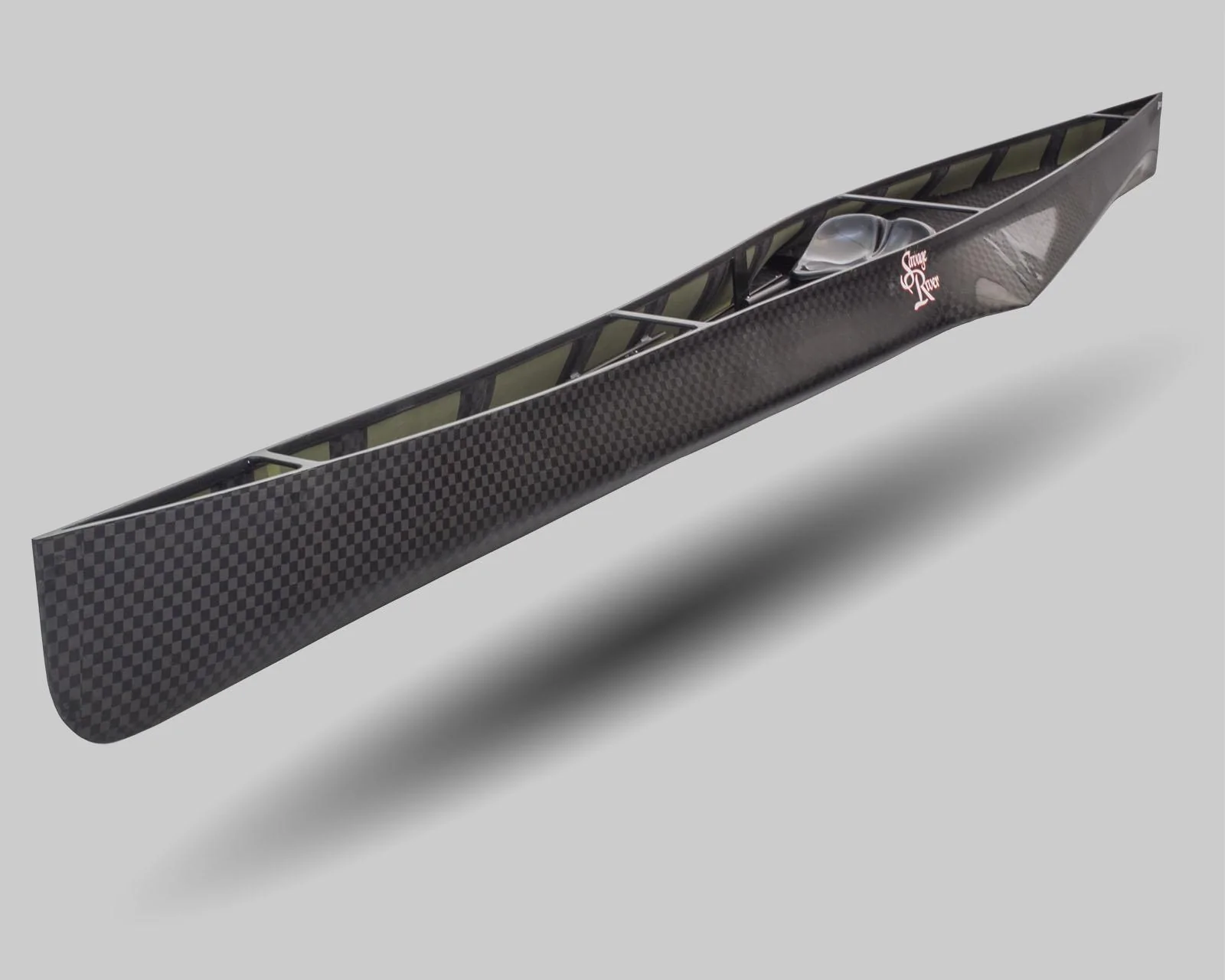

Sorry i couldn't be of more help. I wish you the best of luck with your rack. Also, I would like to see what a light weight 19' canoe looks like if you are willing to share.

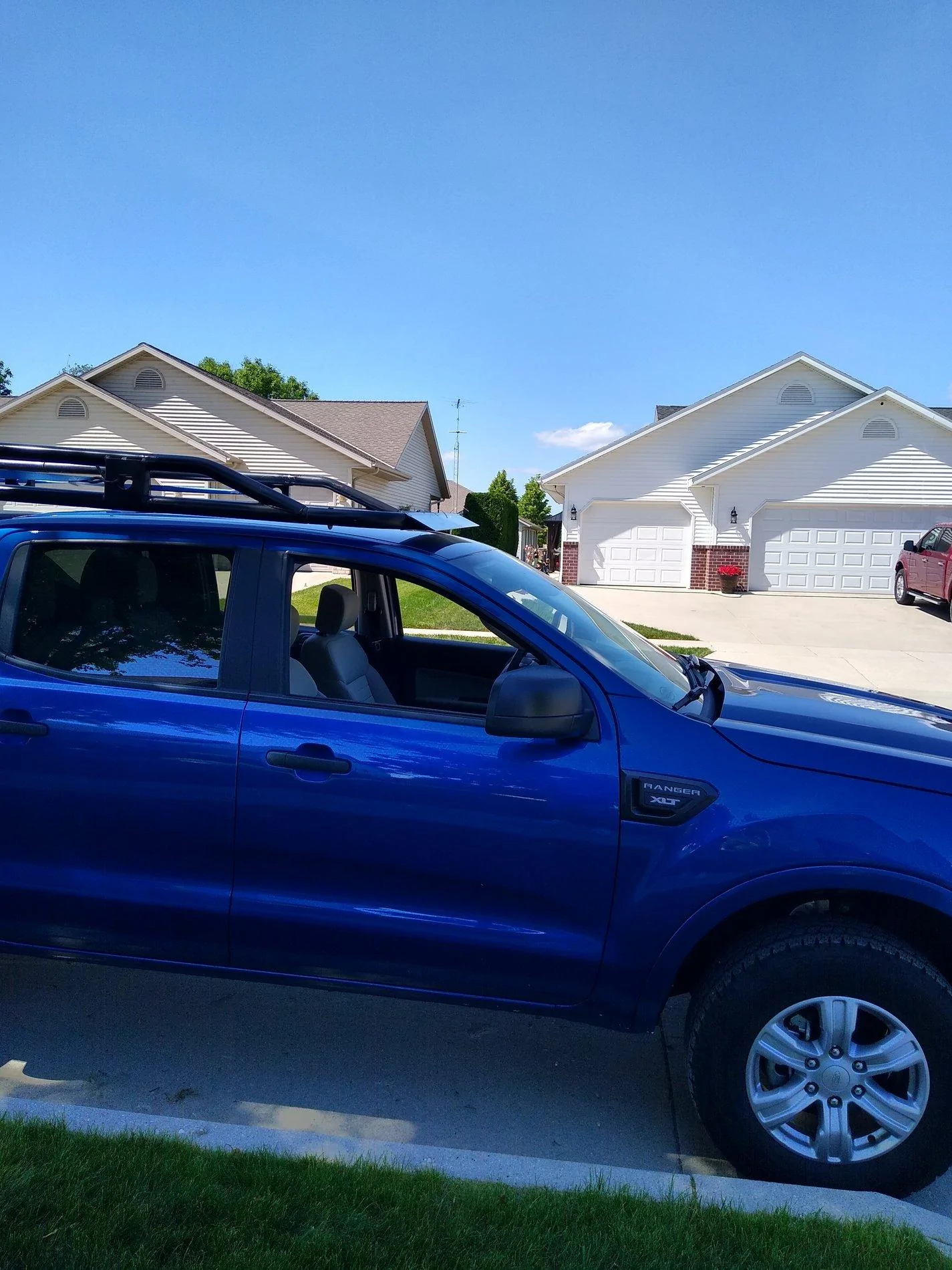

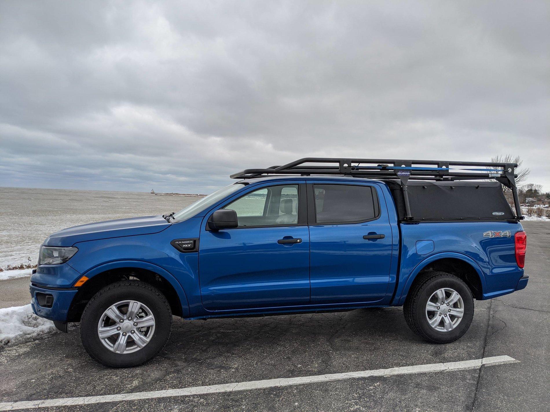

Universals are unstable because they're a one size fits all. That why I found my own and tweaked it. This photo hasn't been updated yet with the rack cut in length by 8"and the fairing added but I bet you get the jist

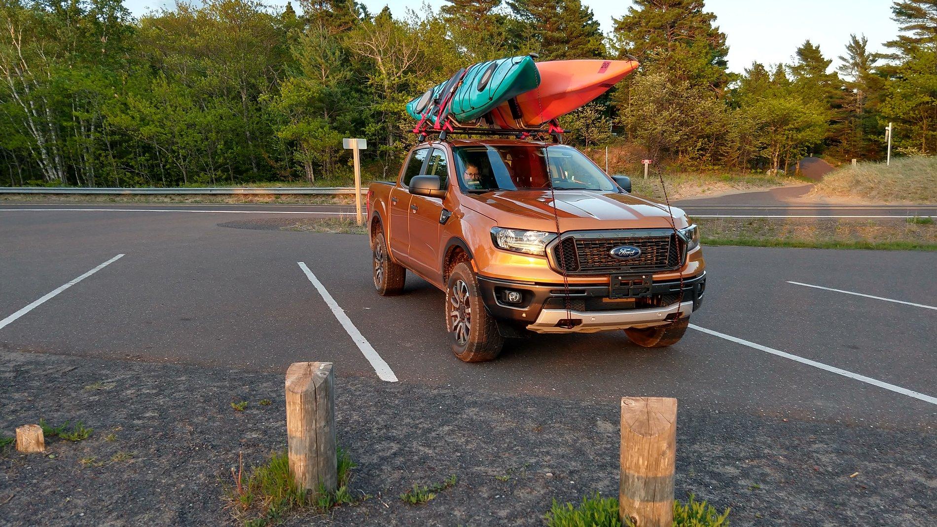

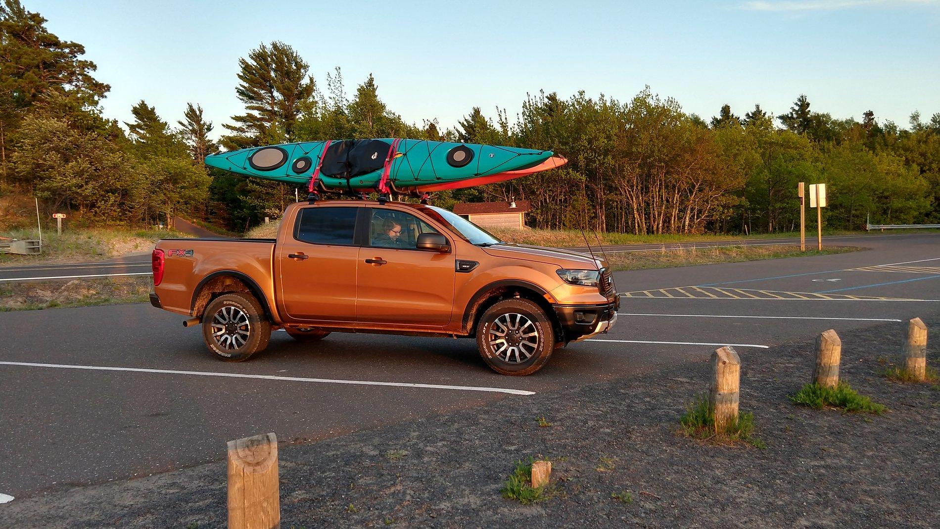

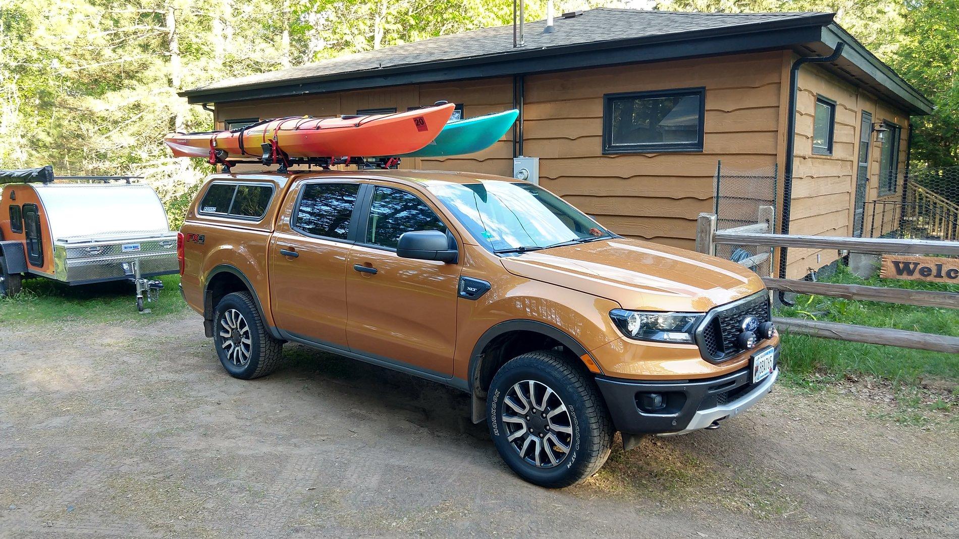

They worked well. Carried the load without issue and was sturdy and attached well enough for me to grab a rack and rock the whole truck more than wind ever would. We've actually upgraded to a topper (for added internal bed storage reasons) since that posting and have moved the racks to the top of that. And have also gotten lay-flat mounts from my father-in-law.
But for either of the mounting locations, we only have them on when needed. They add too much wind resistance, lowering the mileage by a couple mpg, and noise (though you can't hear them that much on the topper) since they whistle quite a bit above 35-40mph. And since they're really not that hard to put on and off. All-in-all, definitely would recommend this sort of setup.

There's rubber padding on the clips which hold to the door frame. If there's movement that means it's too loose and will fail eventually, so there shouldn't be any of that, which means there won't be any paint rubbing. The only marks I have are the sharpie lines I put to make sure I mounted them in the same spots every time. haha If the rubber falls off over time, I would replace it with something to keep it from being metal to metal contact though, cause that will probably cause issues.
For the topper setup, those pads are hard mounted with bolts, so they're not going anywhere. haha

I cut 8" off the rack and added a piece of sheet metal to cut wind noise. Works better.
Looks awesome sir. What brand is this rack? I tried to google search it but seemed to find everything other than this one online.

Gosh, I don't remember. It was beefy tho. It was off an S-10 long box. Realistically you can find any rack and adapt to the Ranger. Look in the usual seller sites for a cheap one. You gotta have help fabricating it to your liking. If you don't you're gonna scratch paint.
