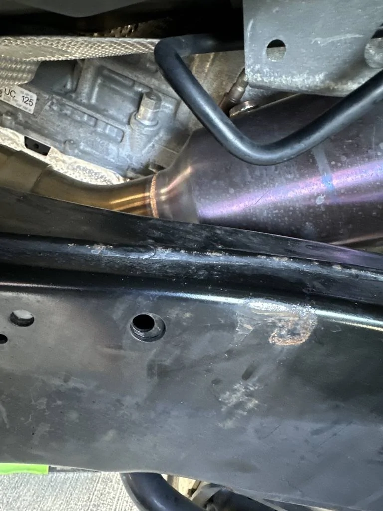

I did the CVF down pipe with a 3" flow FX cat back and S&B intake all the same week, the acceleration without a tune is drastically improved. (you can get on the top down pipe bolt with a ratchet and extensions)

I took maybe an hour, slow incase I needed to put the oem one back. If I had to do it again I would have put the downstream o2 sensor restrictor in first, if you get an angled one it wont turn in the down pipe when it is bolted in
