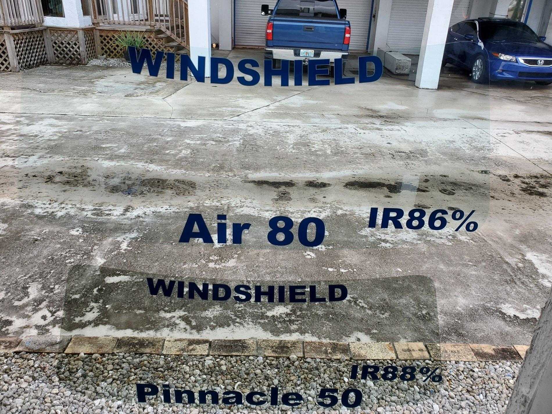

LLUMAR Air 80% Tint on the Windshield. Here's a sheet on glass.

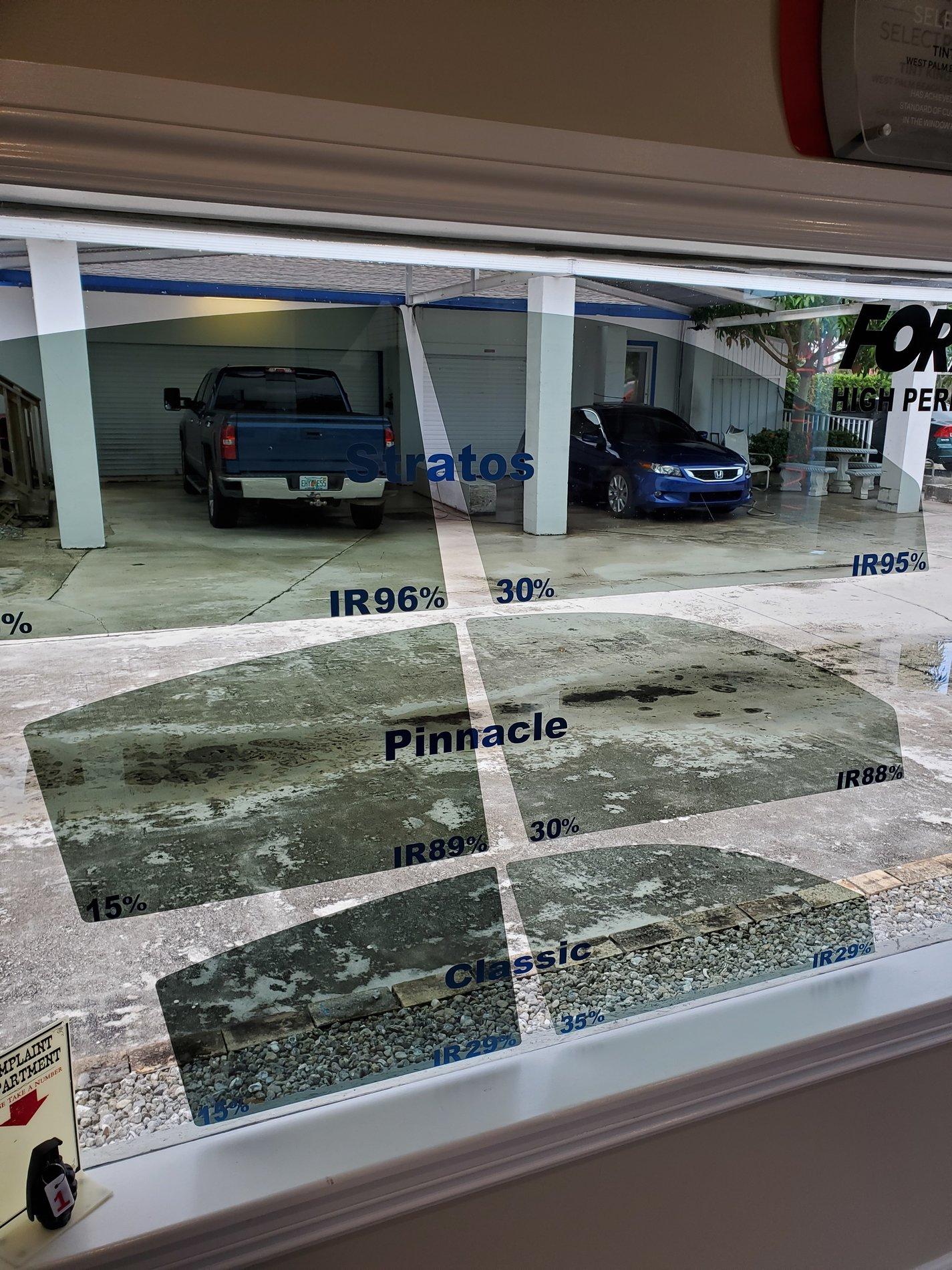

Here are Standard Legal Tint levels for side/rear windows in FL:

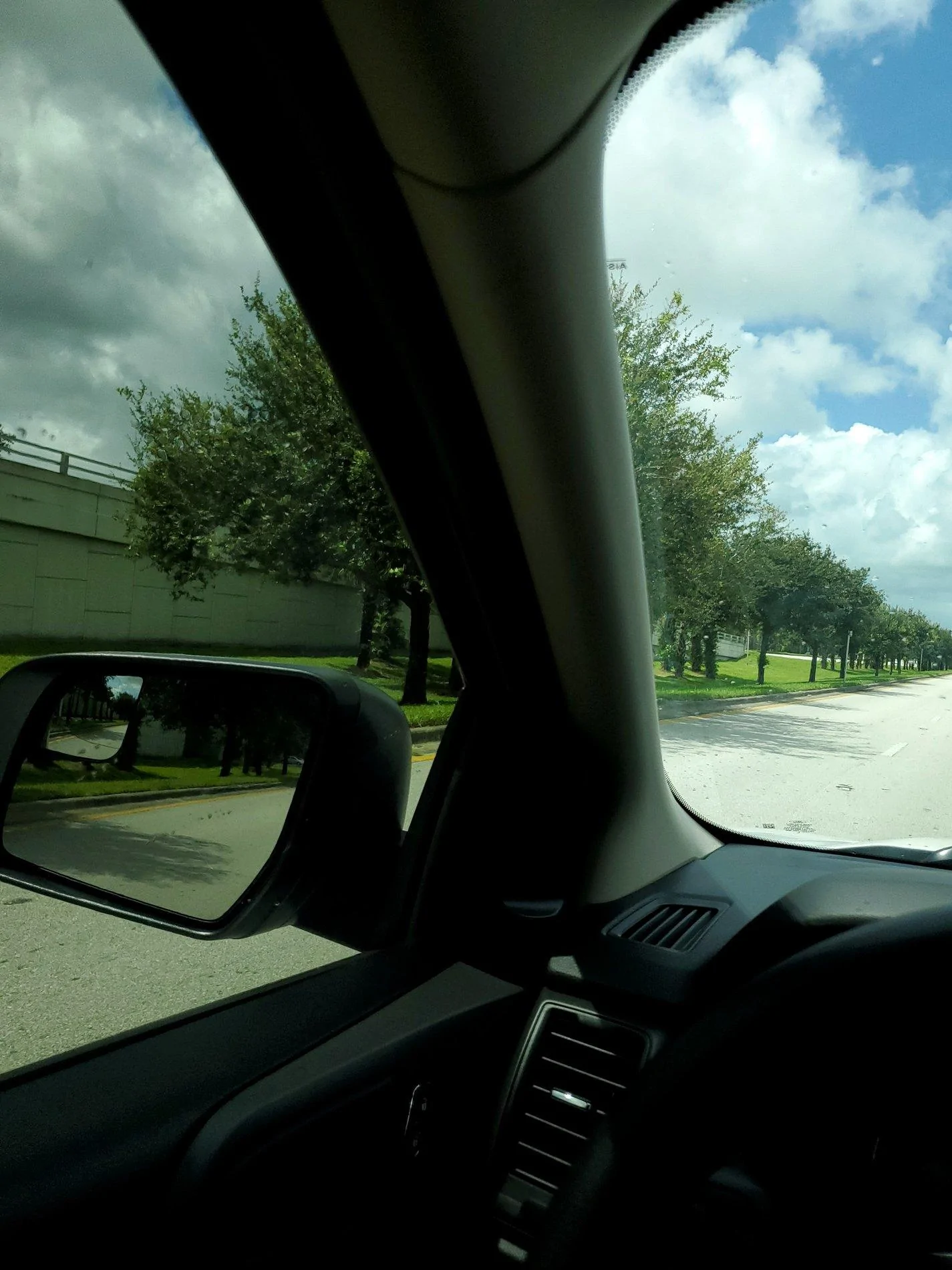

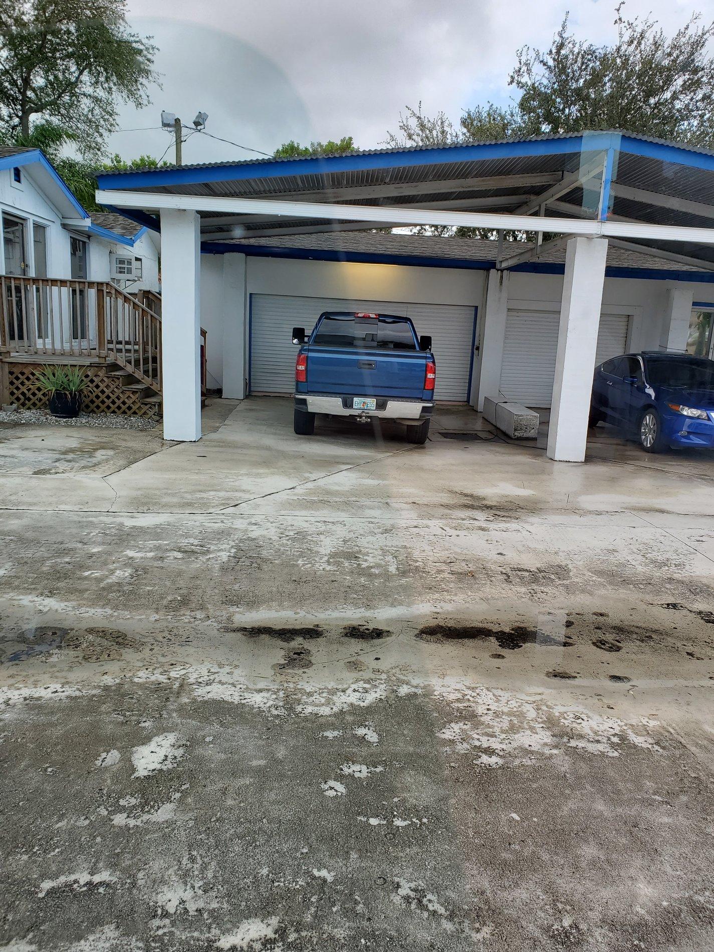

Comparison from the inside when I picked up my Truck:
