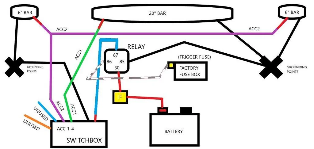

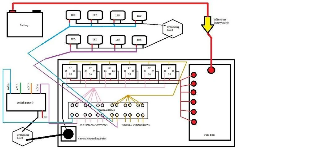

I have 8 light pods. These are low wattage, low amp, so they are grouped into two sets, four on each. Right now I use one relay and a trigger fuse (vehicle must be keyed to receive power). I'm preparing to build a new setup in anticipation of higher powered items and just more electrical items overall. So I want to move everything to its own relay. I am also ditching the trigger fuse.
What I am confused about in the new setup is my switch box is I don't know how the hell I incorporate the main power line for it. At first I thought it was just so the switch lights could receive power, but in my current setup, it also provides power that then goes on to the accessory.
What am I missing? What did I screw up? Is my new setup possible with a self contained switch box, or do I need to go to a switch panel that requires each switch to be individually wired?
Current Wiring Example:
More Robust proposed Wiring Example:
(Edit: The lines for the relay will NOT be merged, the brown and pink are individual lines I just ran out of doodle space haha)
