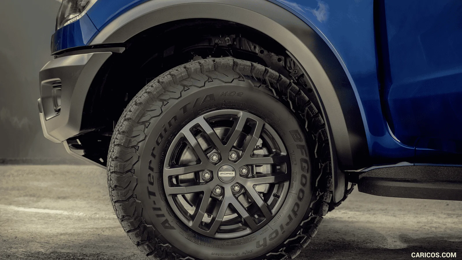

Hey Josh if you're getting 285/70 R 17 KO2's and I'm getting 285/65 R 18 KO2's with the Ford performance wheel's and comparing it on tire calculator it seems your tires are .1" taller. I don't know if I'm reading that right.
The FP rims are 17x8.5. Not an 18" rim like you mentioned above. A 65 sidewall on a 18" rim will be very close to a 70 sidewall on a 17" rim.

The wheels you linked aren't the same wheels I'm getting. I'm going for the 17" wheels that come on the Raptor.
Raptor
Set you linked

The stock Ranger's wheels have a +55mm offset. Wonder if the Ranger Raptor's wheel has less offset?

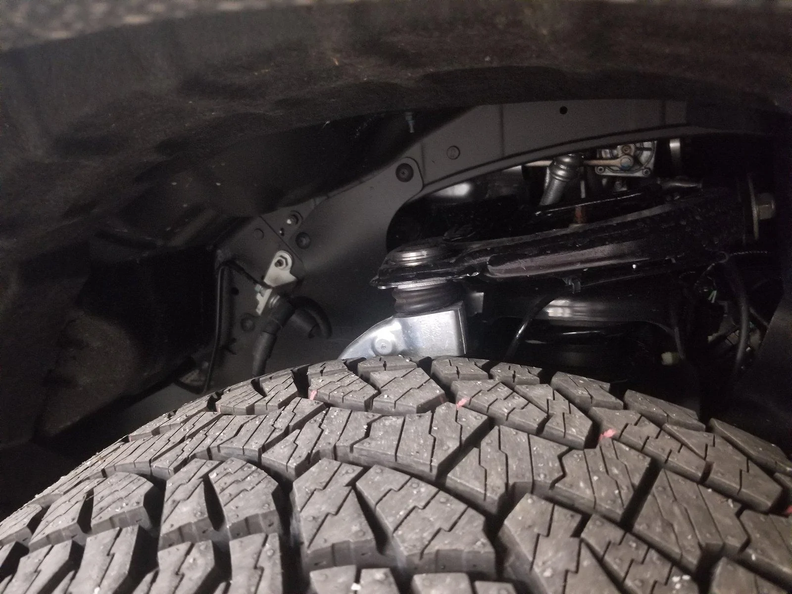

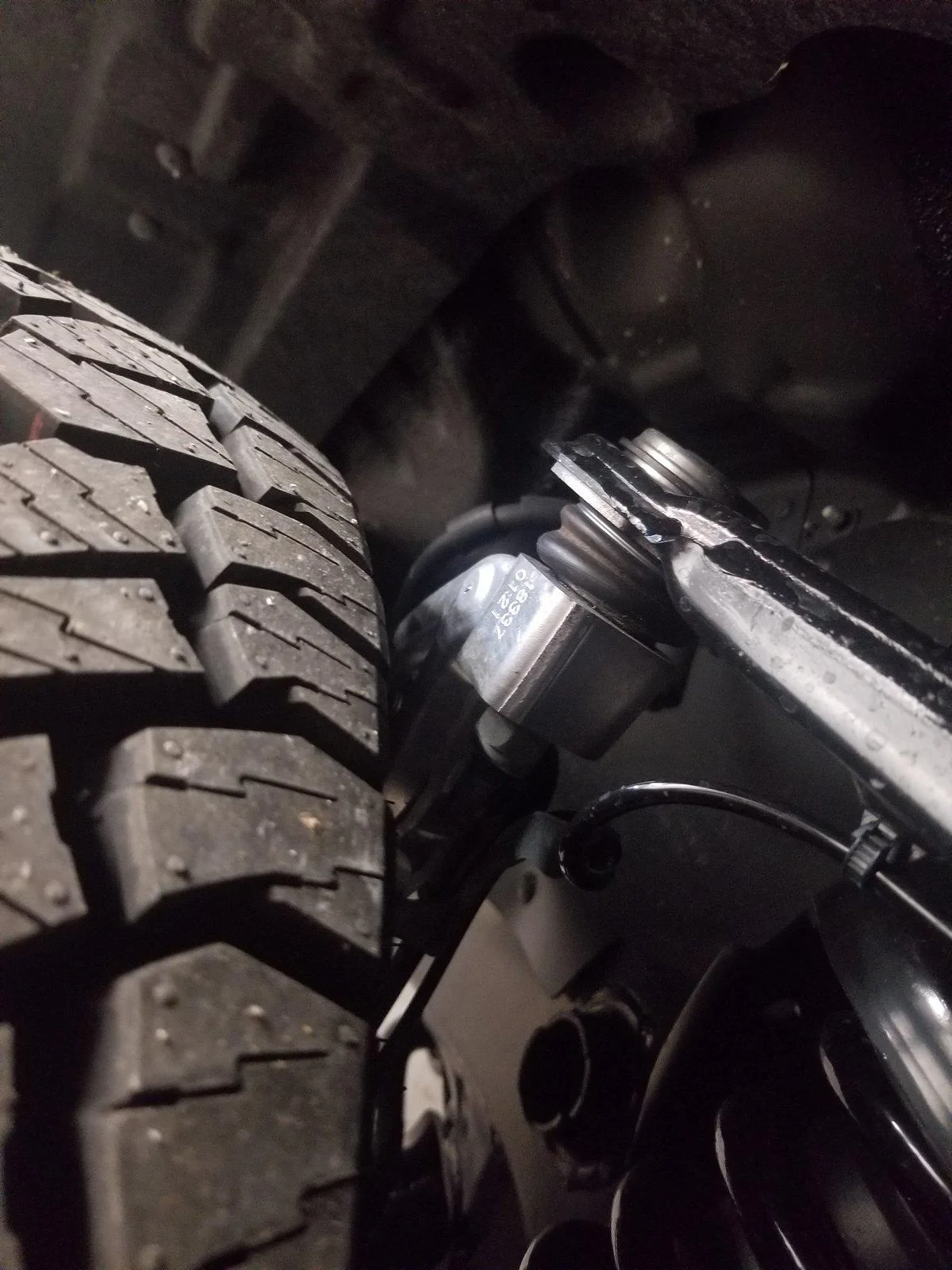

Yeah, there is less than a finger width between the stock 265/65's and spindle assembly, I don't think anything wider is going to fit. If you wanna run 285/70's I'm guessing you'll have to get a reduced offset rim. The raptors can get away with it since they have the flares. I also don't think the 285/70's are going to vertically unless you remove the front "wings". As it stand now (full disclosure I have not measured), it's probably about 1 inch clearance which would be 2" overall diameter, but that is static without cycling the suspension...
