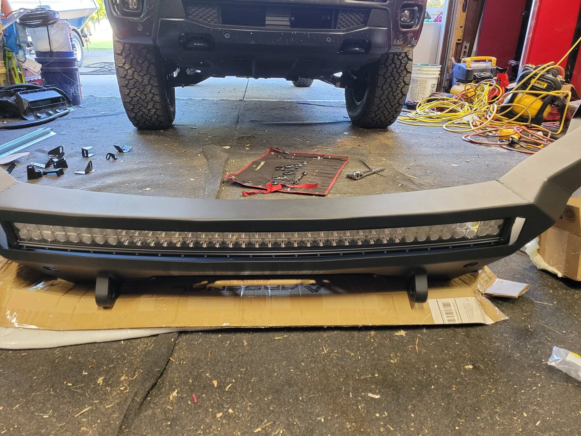

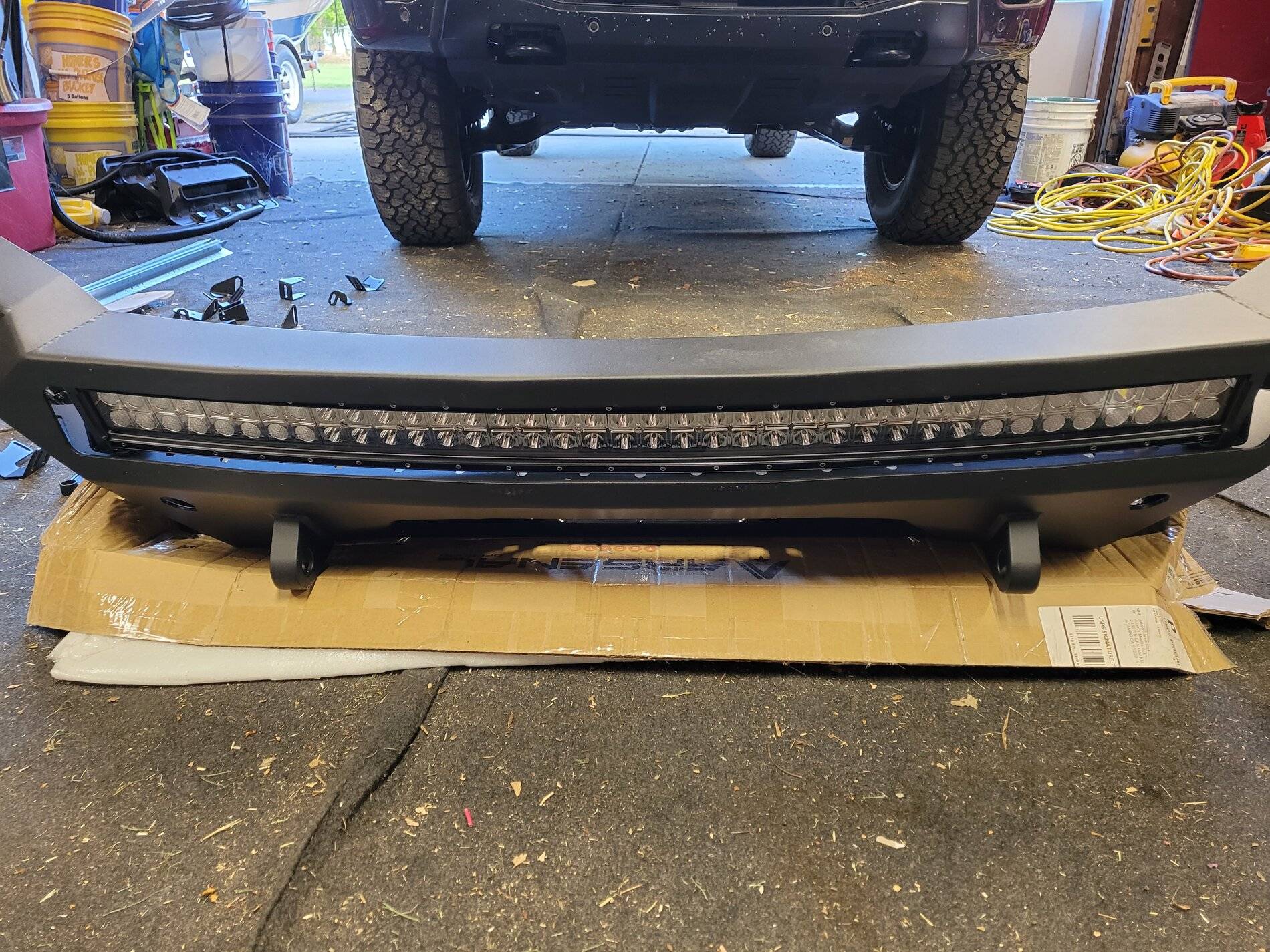

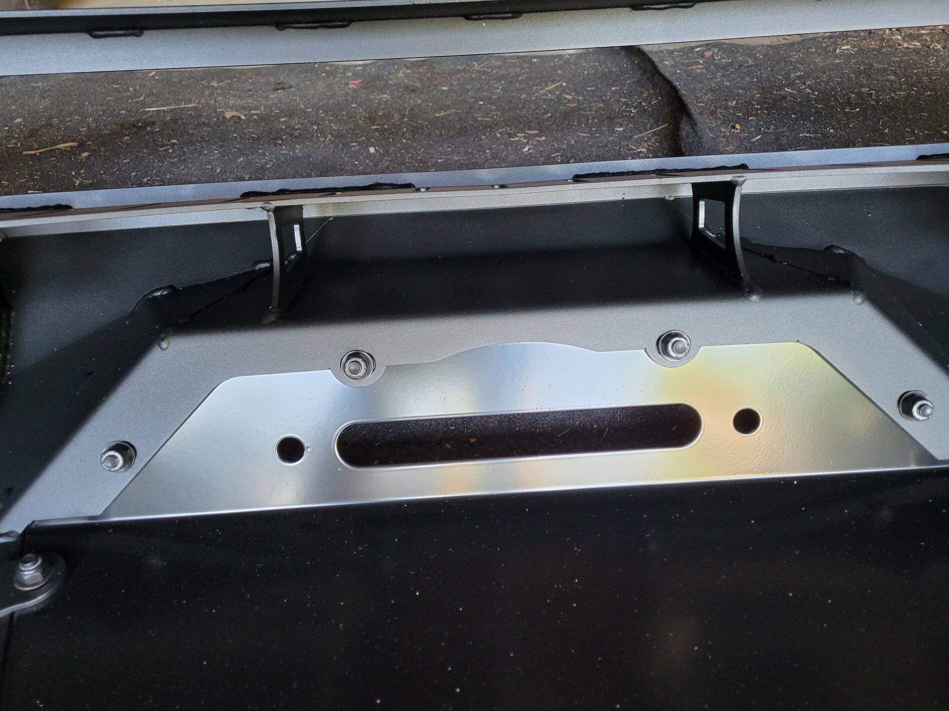

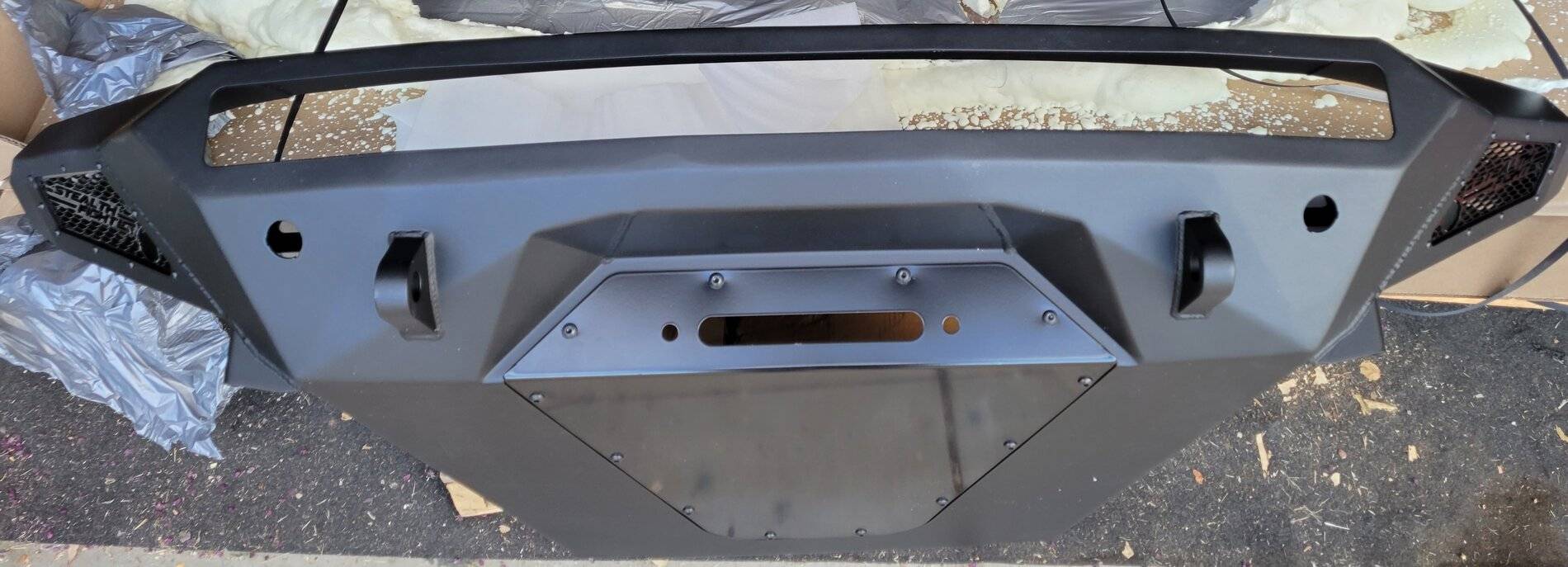

Ok, so.....

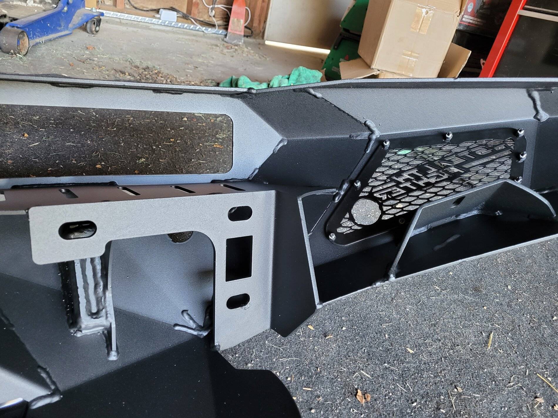

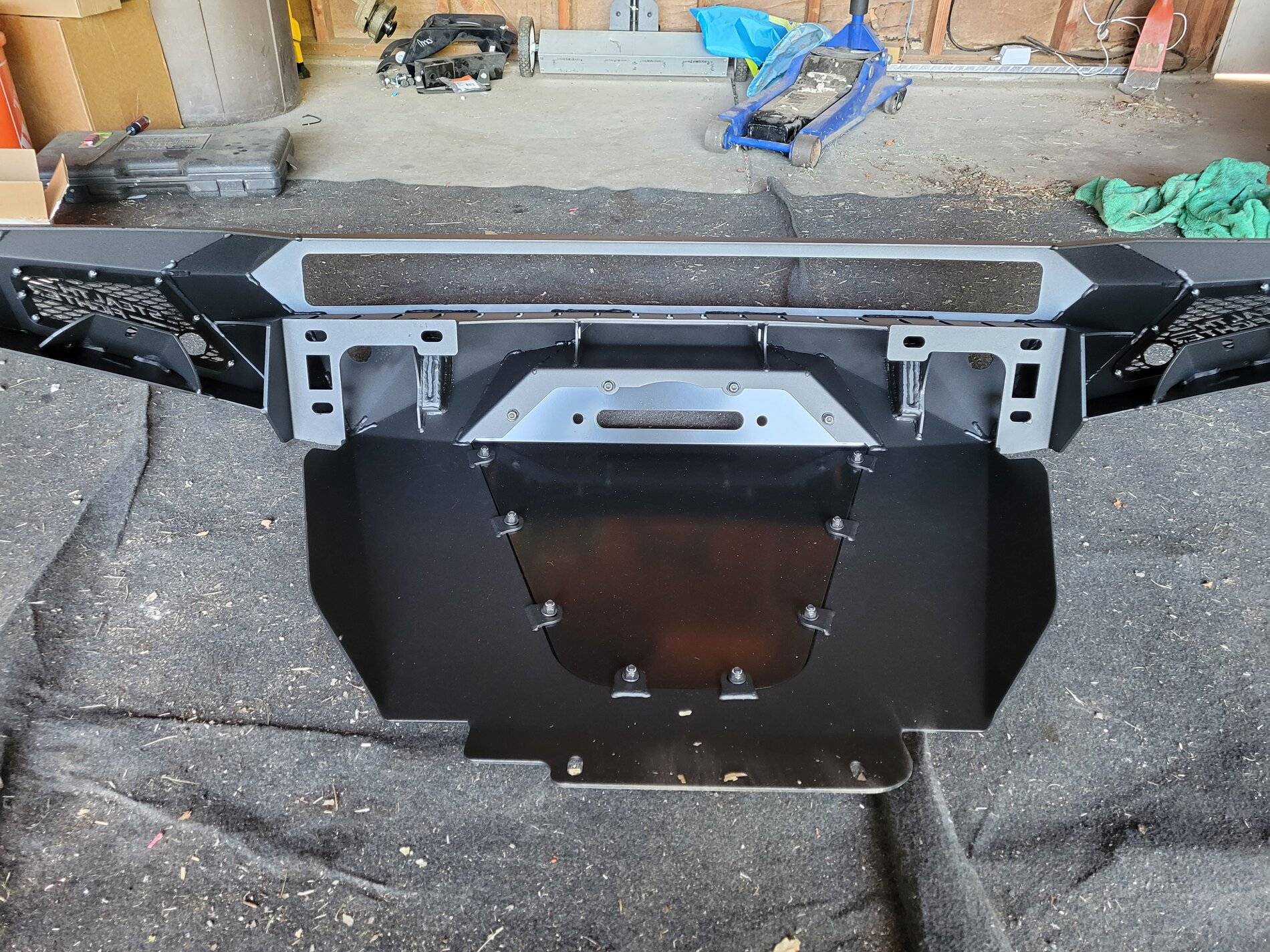

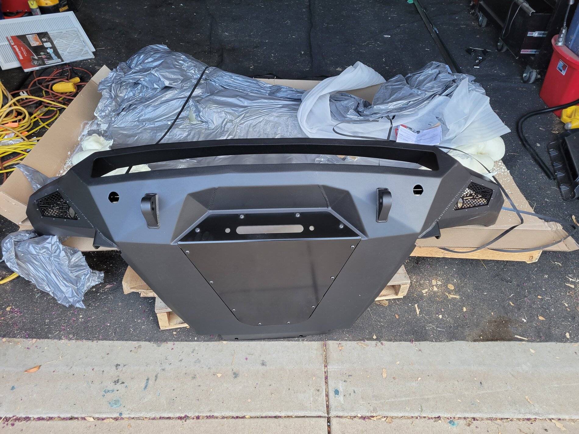

I installed the winch to the truck:
Installed the bumper, only to realize the clearances are super tight, like practically non existent. Like so tight, I could barely rotate the lever to engage the clutch, even with the grill removed.
I called ADD to ask how the designed it to be accessed and they said I would have to wire up the control cable permanently.

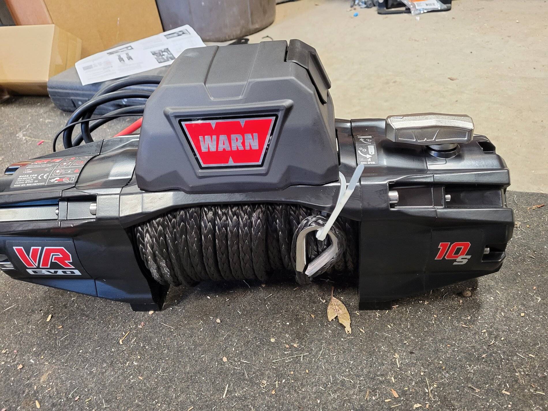

So, I took the bumper off again, wired it all up and reinstalled the bumper. When I tested the winch, it wasnt working. (Wound slowly, made a clicking noise, even smoked after 10-15 seconds of this). I called Warn and the confirmed the winch is bad. So I will have to pull it off again to replace the winch when the replacement arrives. :headbang:
Anyhow, the light bar works. I haven't wired the fog lights in yet, but here is a picture:
I will upload some more pictures of the completed install when I have some time.

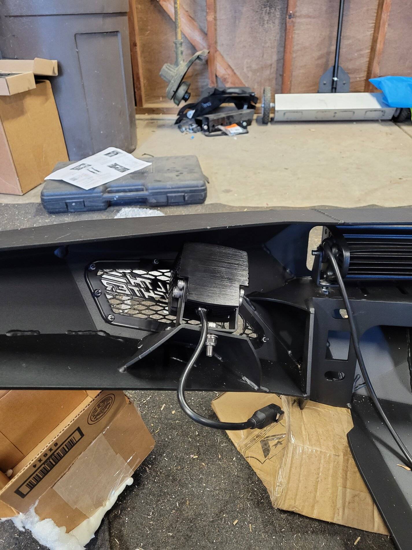

Finally finished my install, but it was not without its fair share of troubles.
When I received the replacement winch, I tested it without issue before installing. However, once installed, it did the exact same thing as the other winch :headbang: .
After a bit of troubleshooting, I found the cause. The winch power cable (going into the winch from the control board) was making contact with the frame. It is fine until you torque the bolts to their torque settings. I trimmed the bolt down with a Dremel, covered it with electric tape, covered the rubber boot that covers the bolt with electric tape, shaved a tiny bit out of the frame where it made contact, wrapped that section of the frame with electric tape, and put a thick piece of cardboard covered in electric tape over the section where the contact was being made. Finally everything worked properly.
I had to take the bumper on and off so many times, I decided to wire quick disconnect fittings for the light bar and fog lights. If I have to take it off 1 more time, I will make one for the ACC. Getting to it to plug and unplug now is very difficult.
Here is the finished install:
This thing can practically light up a baseball stadium now:
Here is a picture of the ACC relocation bracket as requested by @Dr. Zaius
Also, if I remove the bumper again, I will replace the 12 lock nuts that hold the metal plate that the fairlead attaches to with speed nuts. That way I can access that area without having to remove the entire bumper.
