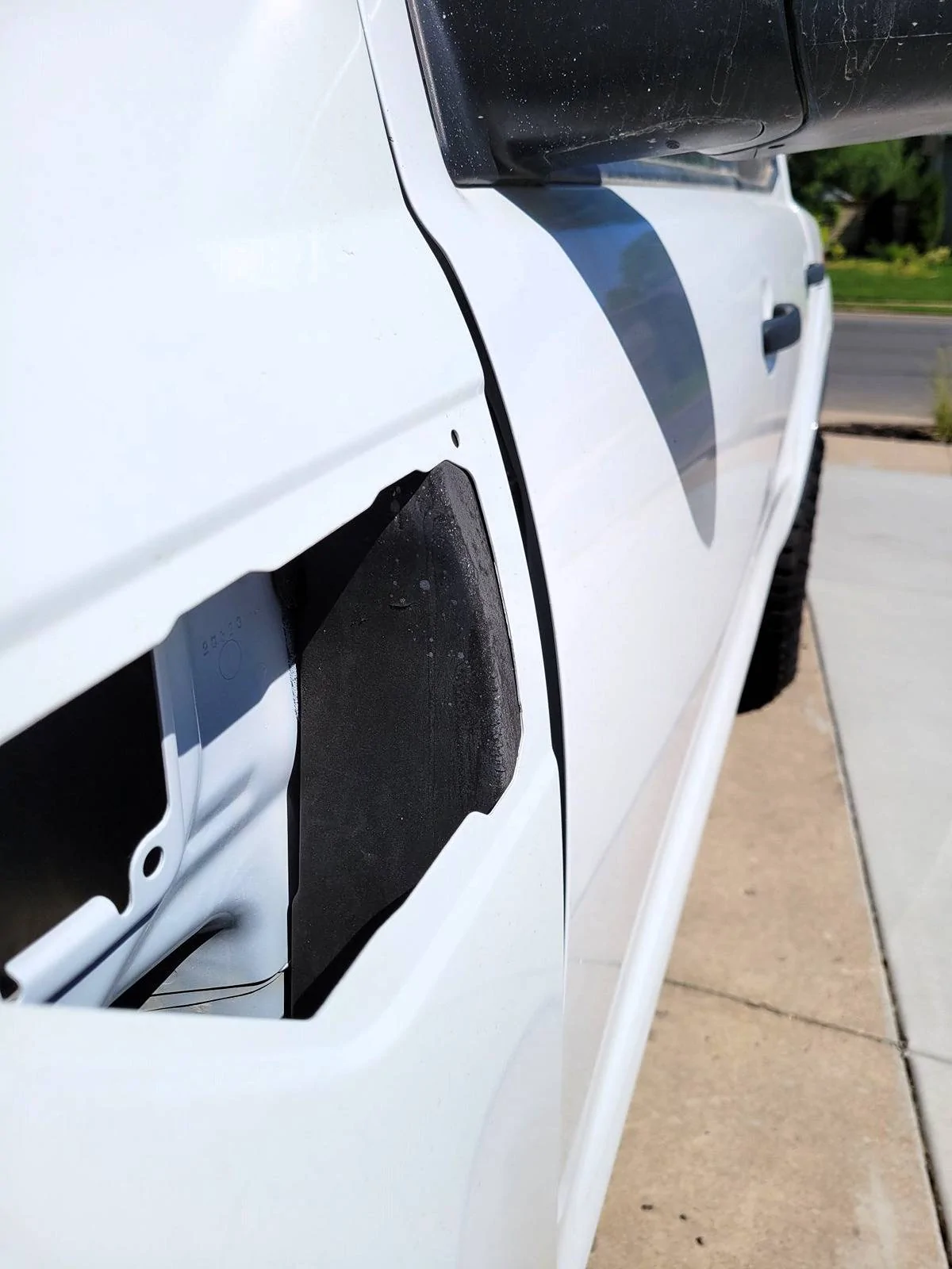

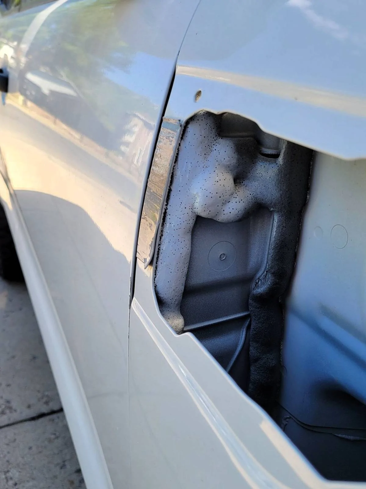

They ordered a new insulator to install in the fender. Later when I go to inspect the work, there's this big, sloppy chunk of ill-fitting foam where the plastic insulator should be. They said it was what Ford sent them. I thought there must have been a mistake. Nope. It's a GENUINE Ford POS replacement part for the OEM plastic insulator.

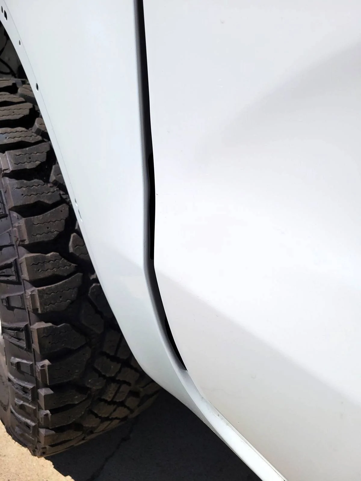

The plastic insulator has tabs where the fender attaches. The fender is then installed, adjusted and the insulator sealed around its perimeter. The fat foamy rubber Ford replacement is just jammed in there. You can see daylight around sections of it and it's too thick at the bottom so the fender doesn't even align properly with the door. Just a total junk, $80 POS replacement for the original.

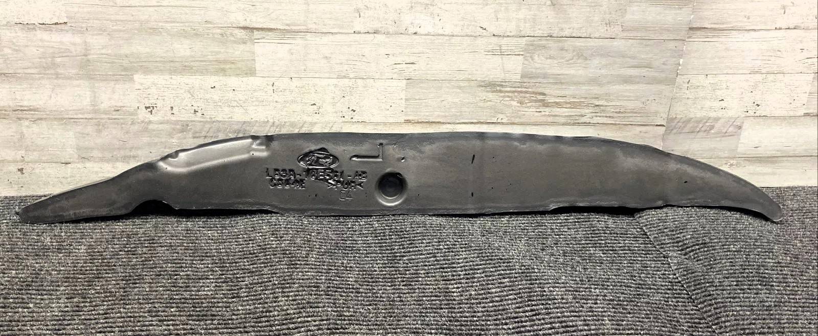

I was fortunate to find a plastic one on a 2020 at a local salvage yard. It has a broken tab but I'll clean it up, epoxy a suitable tab, install and seal it correctly.
