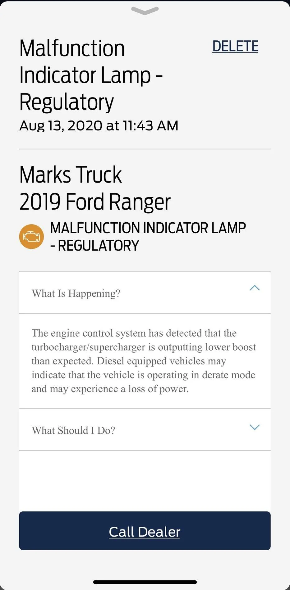

However, this past Thursday I was towing my 3800# travel trailer up a grade while going camping and I got the dreaded wrench warning light and the check engine warning light. I also got a warning on my phone through the Ford Pass app which warned of a Powertrain malfunction and reduced power. Holly cow I definitely felt the reduced power going up a grade! I was flooring it and loosing speed! Luckily I made it over the top of the grade and I limped my truck Into the campsite where we were going.
The Ford Pass App gave a little further information stating that the engine control system has detected that the turbocharger is outputting lower boost then expected. We called the dealer in my area and they said they would not be able to look at my truck for almost a week! Weighing my options, I decided to limp my truck back home without the trailer.
