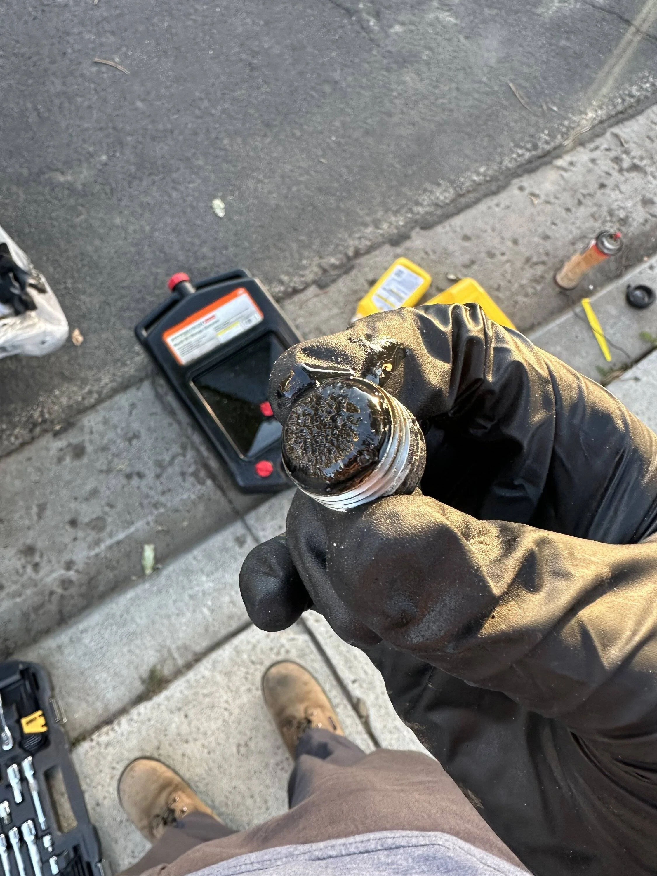

I originally swapped out my Rzeppa at approximately 10k miles. With a tick over 30k miles on the clock now, here’s the result of my rear diff fluid change.
You can continue to argue how ignorance is bliss, and how your friends cousins grandpa did this 150 years ago and his diff exploded, all you want. I don’t care what you keyboard warriors have to say.
This is a real-world result using readily available factory parts, and a little common sense. Big shoutout to Ford for making such an astound pickup truck. Onwards to TW 1 piece goodness!
