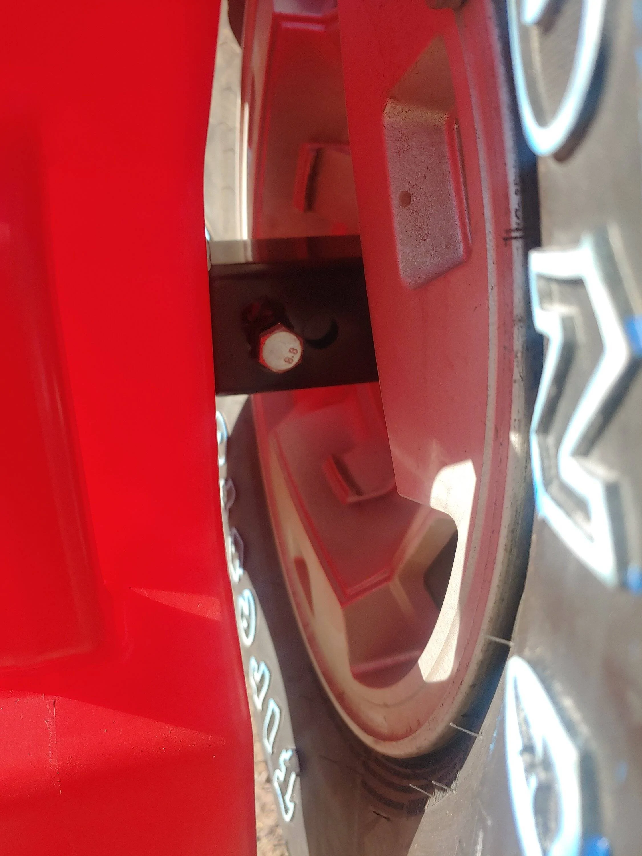

So I recently got myself a 3 Gallon Rotopax Fuel can for the Pathfinder. I was able to mount it with the spare tire thanks to someone having what I needed. That said I finally used it today so I can give my intup on it.
First off why a 3 gallon? Well for the Pathfinder that can ve anywhere from 45-60 miles depending on conditions. If anything it can get me to a busy street. For the Ranger it might be possible to do similar. Also the size is small where I dont jeed a second mount to hold it like the 4 gallon can.
Why did I use it recently? Mainly to see if the original spout it came with was useable or not............ Yeah it wasn't......
If anything I recommend anyone that gets a Rotopax to get rid of the stupid Eco Spout and get the $20 selve venting spout. Much easier to use. It also reaches my fuel filler too!! To do this you need to remove the plasit insert in the fuel tank. Not hard to do either.
Do I like the RotoPax? Yes I do. Why you ask? Really just for the simplicity of mounting it where you want even if you have to make custom brackets. If anything it can be that backup fuel when out in The Wilderness or on a long trip and want the backup.
All that said I still hope the big fuel tank ends up happening for the Ranger. I even plan to get a bigger thank for the Pathfinder.
