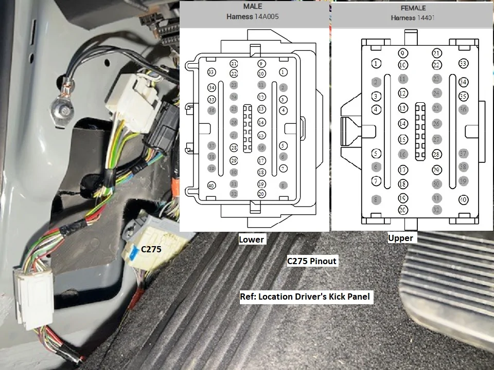

a couple of quick things to try:
Cycle the Bed/Cargo - Light switch, they are on the same circuit, do the bed lights and puddle lights work?
Cycle the overhead console - Rocker Switch (left) for (ON) - Do they now work?
If No
Pull and Reseat C275
If no help: Check for Power on Pin # 4 - this will check for power coming out of the BCM
Another is - As I do not recall from memory if there is a setting in the IPC Menus to turn them off, I would have to check myself in the lighting section of the menu to be sure

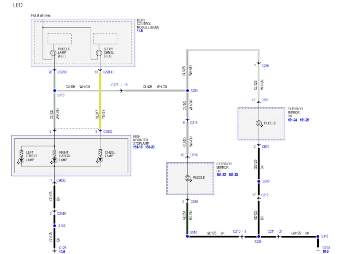

If the cargo lamps work, then there would be a wiring issue to the puddle lamps (unless both happen to be burned out). Connector C275 pin 16 is the common power feed to the puddle lamps. Could also be a problem with splice S310 or S233 in the diagram below.

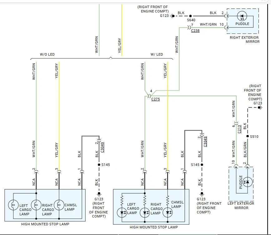

I noted something here (FYI) ref @Ranger Bill it appears the pinouts for C275 changed, I show Pin #4 for the 2021 & Up - 2020 & Below = Pin #16, the wire color did not change.
It appears they simplified the circuit and eliminated the multiple splices and now use C275 as a single spliced source @ the connector itself
The Good News is - Whatever pin is used to other will be empty, so if pin #4 (Pin #16 will be empty) sometimes wire diagrams may or may not be truly accurate.
Note: The Cargo/ Puddle Lamps operate in 2 separate scenarios.
Door Ajar / Door Lock (Feedback) Circuit
Cargo Lamp (Switch)
The lights are on the same circuit, if the BCM commands them on - both sets (Puddle & Cargo) are on.
If only the Puddle Lamps are not working the issue is either both puddle lamps are burned out or a issue a C275

Sorry, you posted while I was looking at different wiring diagrams - Good Find and Fix
So curious was it PIn #4 or #16 for future reference.
If Pin #4 it would have had 2-wires running into each side of the connector - this is the splice

It was point #16
