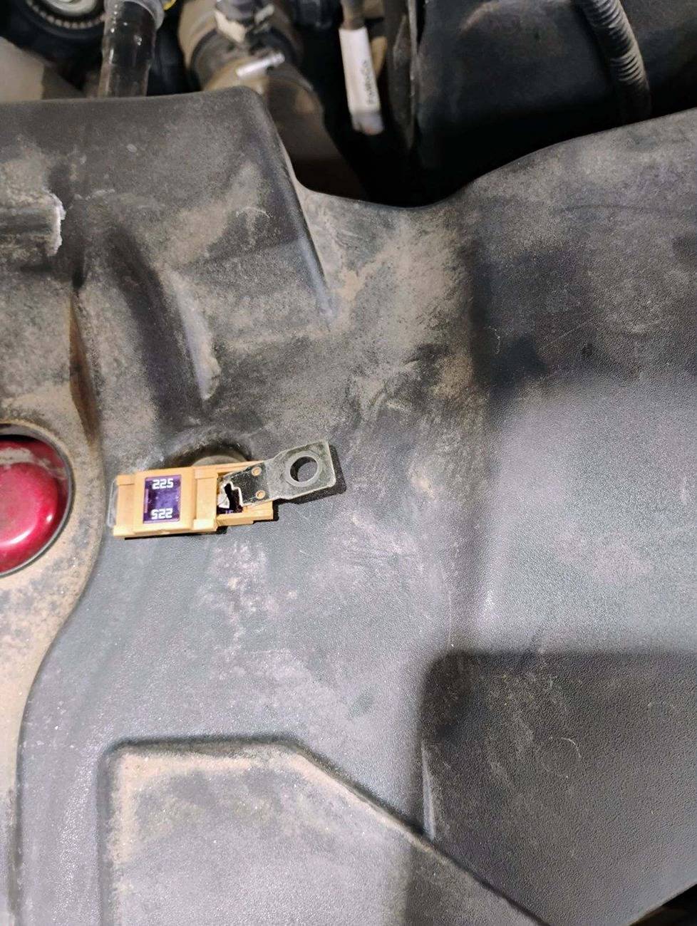

The Napa Autoparts - equivariant P/N: is 782-1141, however in store they showed 2 different fuses for that P/N - 1-All Black (No Window) and 1- Just like what is installed.
Ordered it and it was an exact copy @ $10.49 plus tax

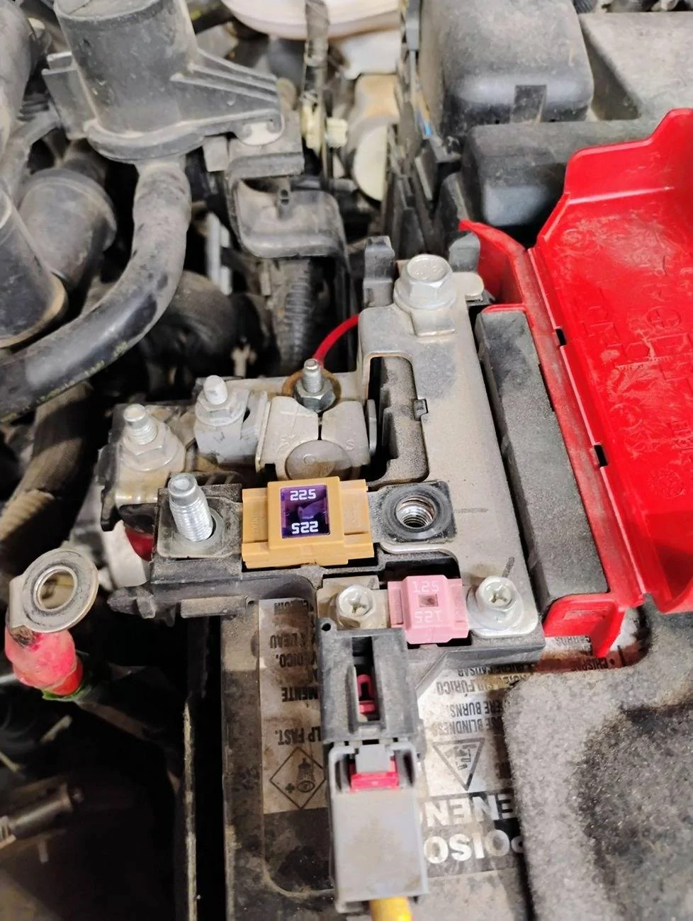

I have no idea why anything would need to be programmed to replace the Battery Mounted Fuselink (BMFL) assembly. I couldn't find the Ford part number for the fuse listed on USA Ford sites, only on overseas web sites. I guess that is why the dealer replaced the whole BMFL.
I am assuming (Battery Disconnect) so Dr. Window (Reset) is all that I can think of.

First rule, never do anything to your Ranger without coming here first!
to blow a 225 amp had to have taken a dead Short somewhere, I think even the Alternator only produces 140amp, I am pretty sure your light bar dont pull 225amp unless a wire got caught in the hood?
good thing it was there!
Ranger Alternator Specs = 170 Amps (Max)
Oct 9, 2024
2021 Ford Ranger
Well, that's complicated because it seemed like an emergency if my truck could shut off any time, any place, so I felt like I was over the coals. It's also complicated because I don't know if I could take it somewhere and say "please do this thing I discovered from the Ranger5g forum" -like they could probably get in trouble for not making their own analysis. But getting educated at any point is overall helpful, I guess.
I don't know if this helps but this is the raft pump I've been hooking up to the battery. I think there's a high probablility I would have attached it to that stud since its the most prominent and I didn't know any better. https://www.flycraftusa.com/product...vZakgPpr6ldzy3WJ0B0Dvcfj8kktZ1MOzUfHhjZKWh9OS
The light bar was something like $35 on Amazon, I can't find the exact one because it was a gift. So don't know how much information that gives...
