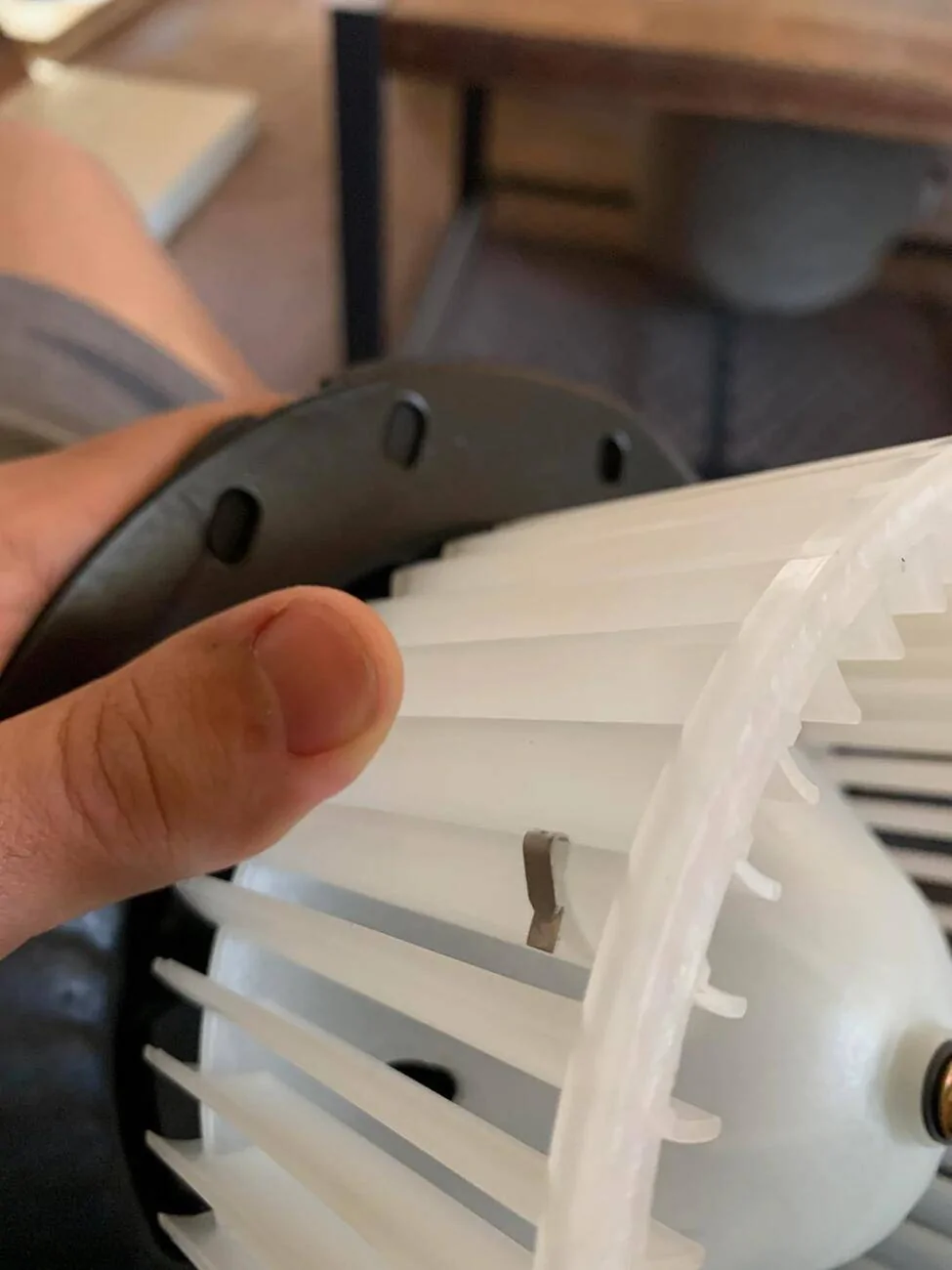

Plus,also check for a spring clip - laying in the blower squirrel cage or near the opening of the housing.
This is a balance weight for the wheel.

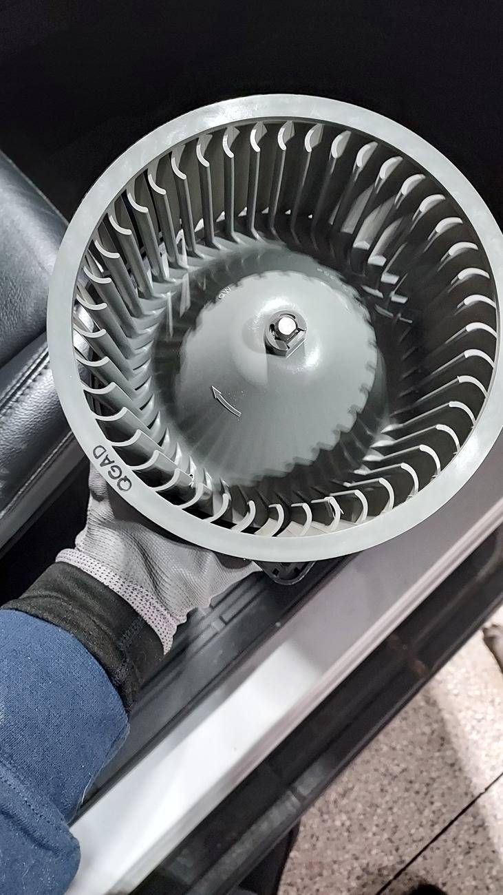

Thank you for your advice. I dropped the fan and it was clean. Maybe the fan is just bad???

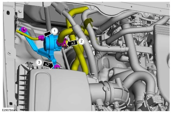

1. Coolant Heater - Pump, this should only run when in (Auto-Stop) and in heat mode, this pump takes place of the water pump (when engine is off) to help keep the cabin warm.
It's located beside the Coolant Reservoir (Tank)
It may be stuck (on) and running along with the water pump adding more pressure through the heater core (noisy)

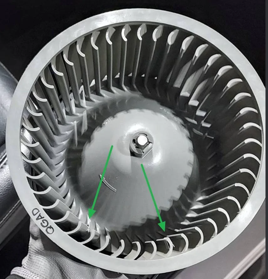

It's hard to tell from the pic, but there should be a balance weight on the cage like this or similar.
On-Line Pic

Cabin Coolant Heater Pump
Possibly feel this for vibration with the engine running or with a scan tool you can see it (on or off)
With engine running this should be off. Its electric and only runs when ASS is active, and you are calling for heat in the cabin.

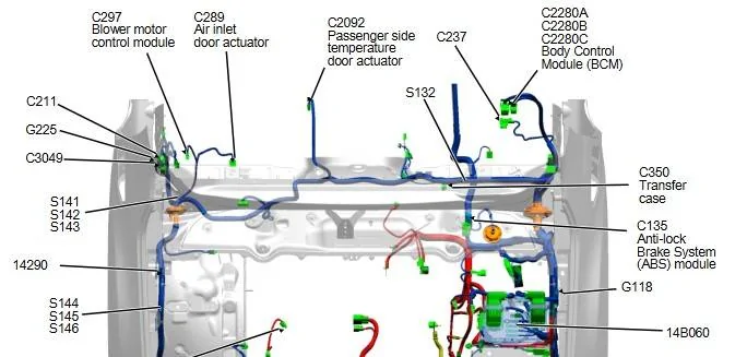

If you have (High Resistance) then we need to find the Ground Point G225, as that is where the ground feeds to.
I am not concerned with the PWM Control Pin #3 unless you are unable to control fan speed
The actual location of G225 is (?) as this is the only diagram that shows it.
It states engine bay, but this diagram shows it near C211, which is in the row of 3 connectors behind the RH (Passenger) Footwell Kick Panel, so I am assuming it is somewhere near the blower motor. (High Amperage) draw motors generally do not have a long ground run.
The Only wire running to G225 is from the Blower Motor, no other grounds are routed to it.
