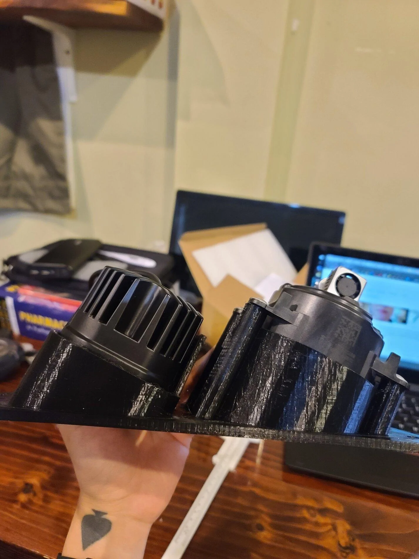

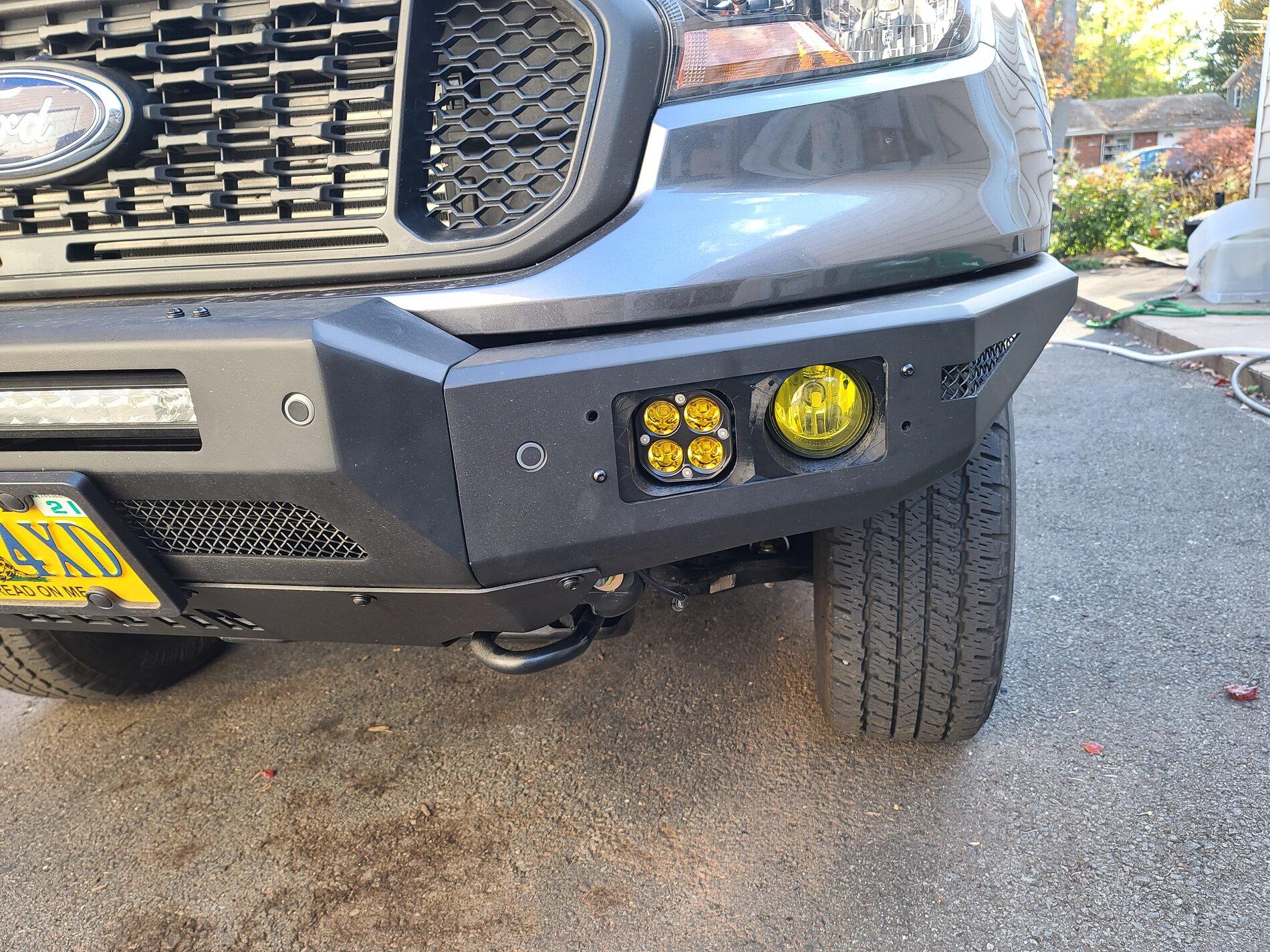

After getting my bumper, I didn't really want to toss the stock fogs since the cutoff is so good. So I made my own brackets!
Printed in PETG, so theoretically, it should hold up in the summer. Time will tell! What do you guys think?

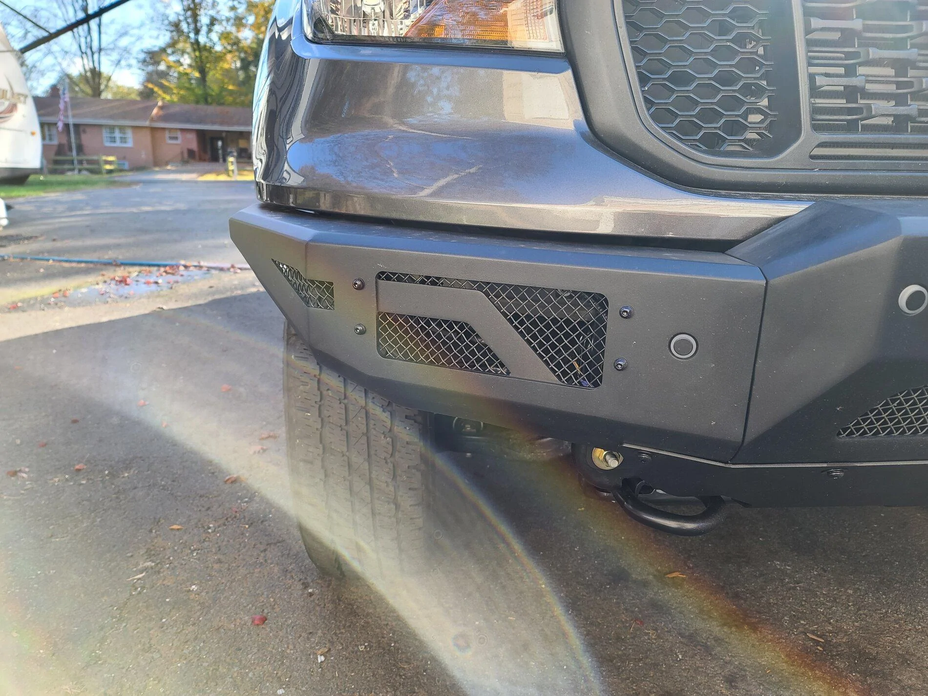

Nice job, that looks really good! What kind of bumper is that?

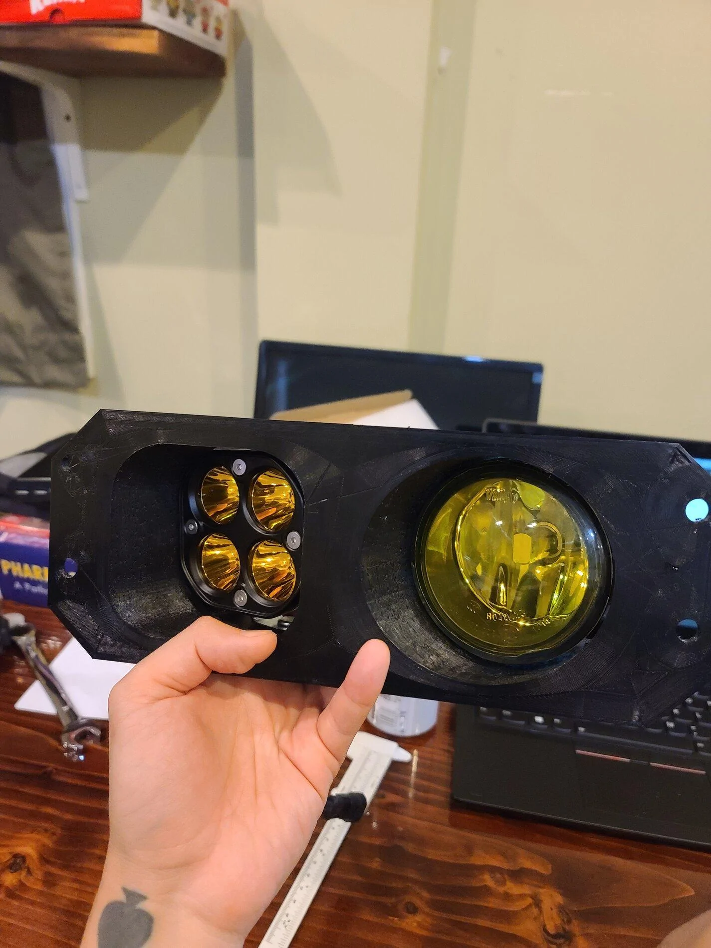

Ahhh, almost had it on my prototype.. 2nd draft, my led pods aren't centered correctly. Still happy with how this is turning out tho. I think one more version and it'll be ready for priming and painting.

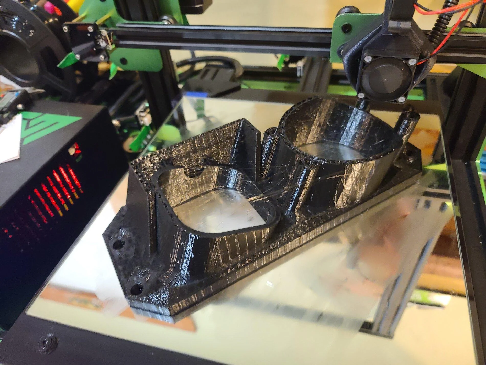

Sure, just keep in mind that 3d prints are never perfect and my turn around times will suck because it's 48hrs of straight printing! If you're OK with sanding it, I can make it happen. I'll print it in PETG, which is uv stable. The only unknown is summer heat, though petg is better than PLA in that regard. And it only fits the stock fogs and a specific set of Baja design clone lights (might fit others, but I modeled it for these). I can send you the link to those.
