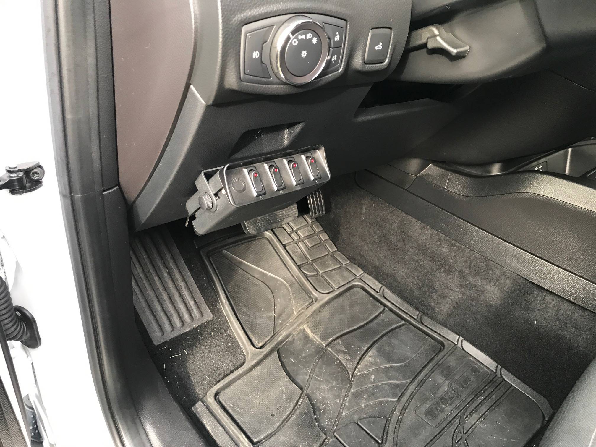

Were you able to just run it along an existing hole or did you need to do any cutting also did you have to pop any parts of the dash off?
No cutting, and we found an existing hole that had a ton of wires already going through it so we just snuck it in there. If i recall correctly, it was on the drivers side, but you practically need to lay on the engine to see it. It was down the firewall a little bit and enters in the drivers side footwell.

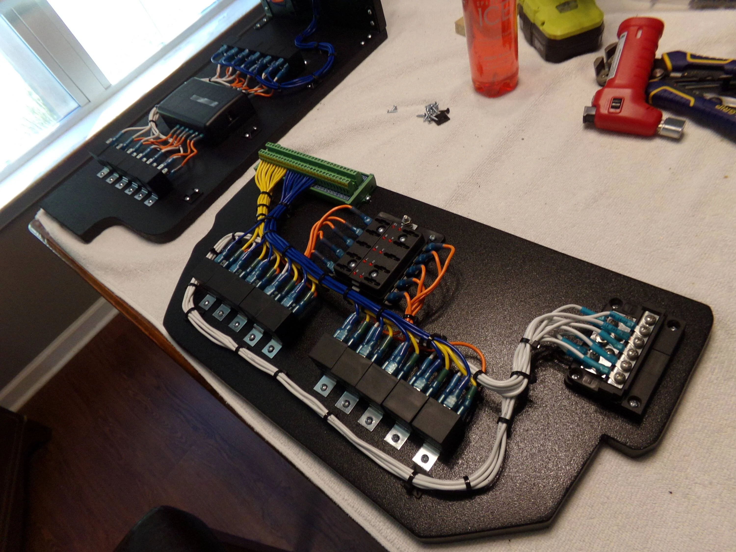

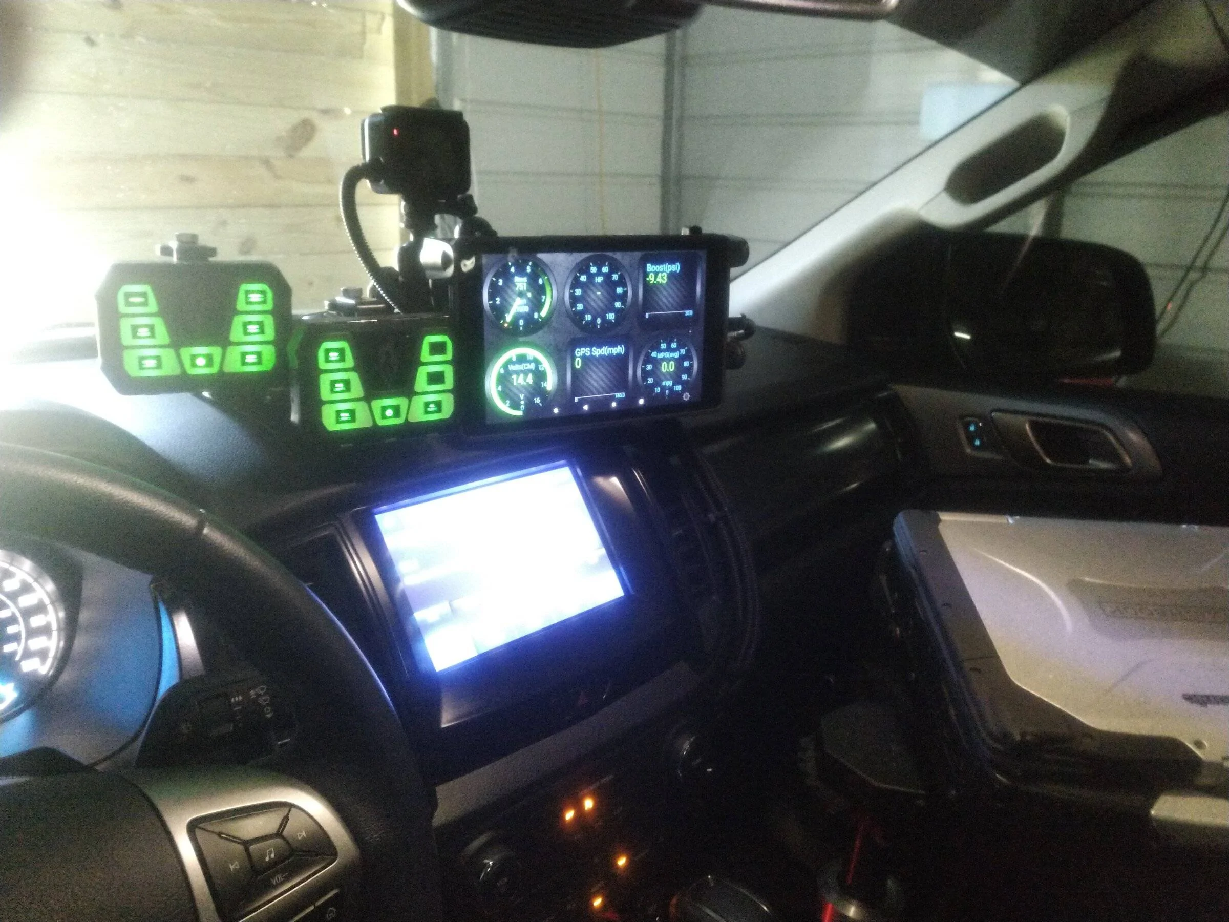

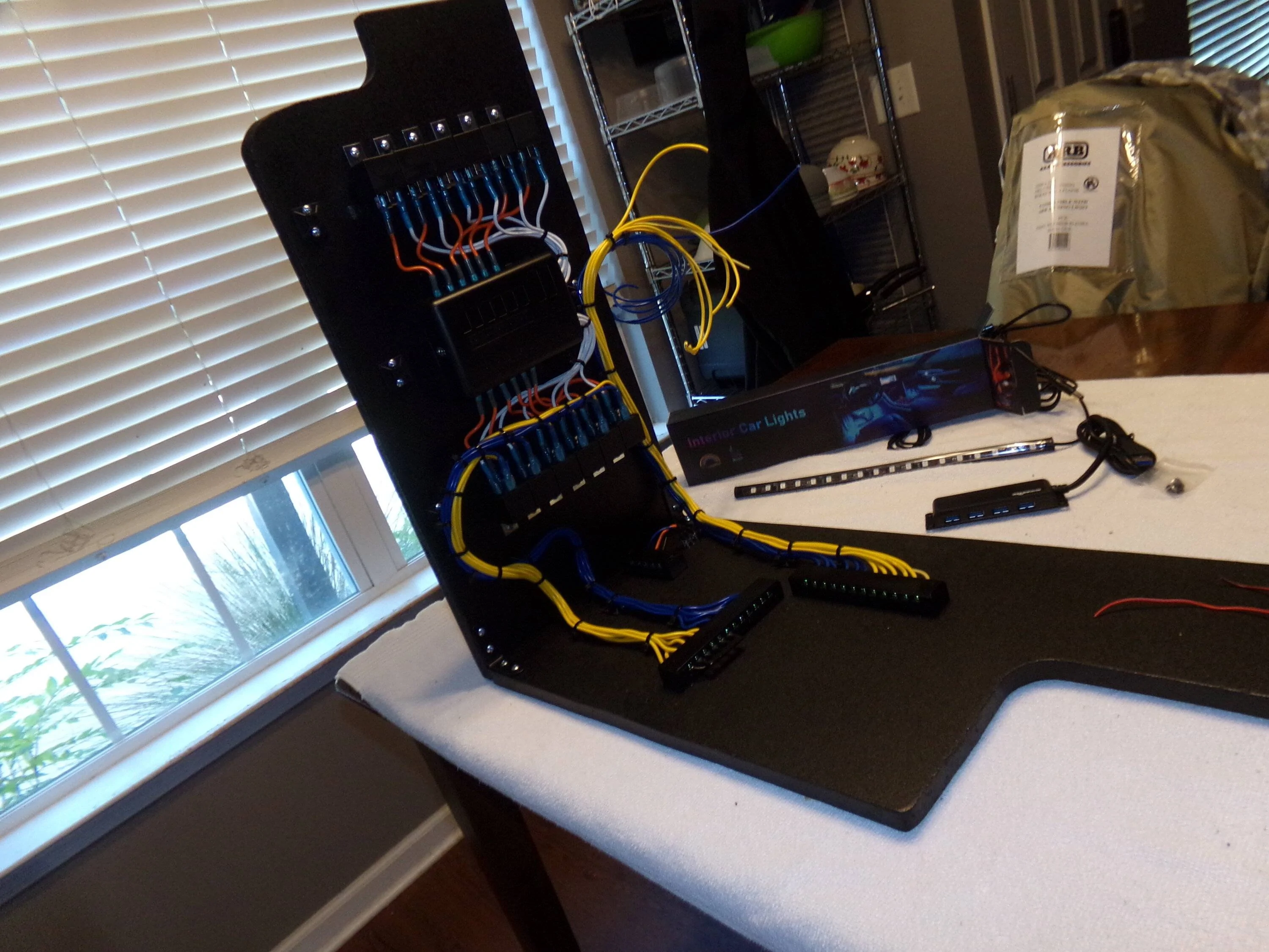

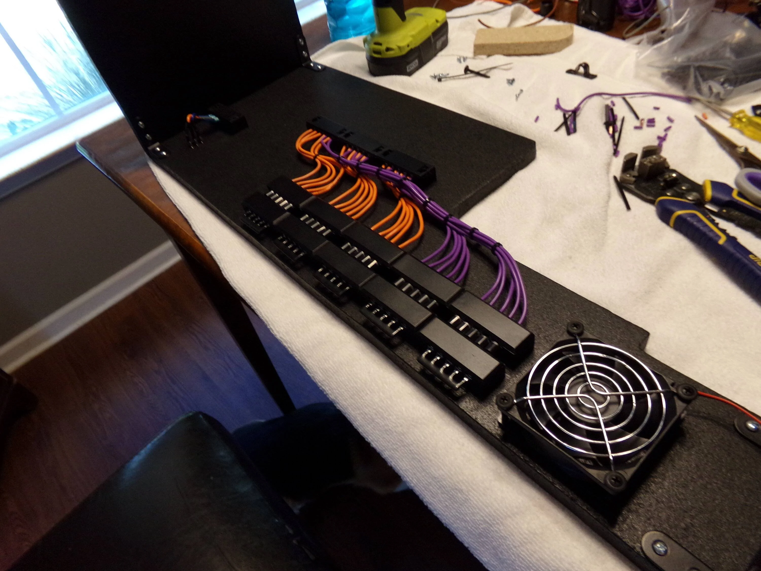

I have 22 relayed channels in total, most are for future expansion on items I don't have yet (ie; 12v fridge, air compressor, water tank, fuel transfer tank, etc etc)
Currently I have the following zones as far as lighting; rack left, rack right, rack rear, cargo, pattern channel 1, pattern channel 2, front bumper fogs, ditches, and forward facing spots, and one channel for perimeter all on (basically turn the truck into a 360 degree UFO).

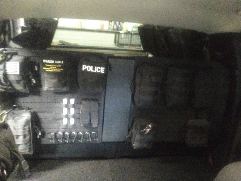

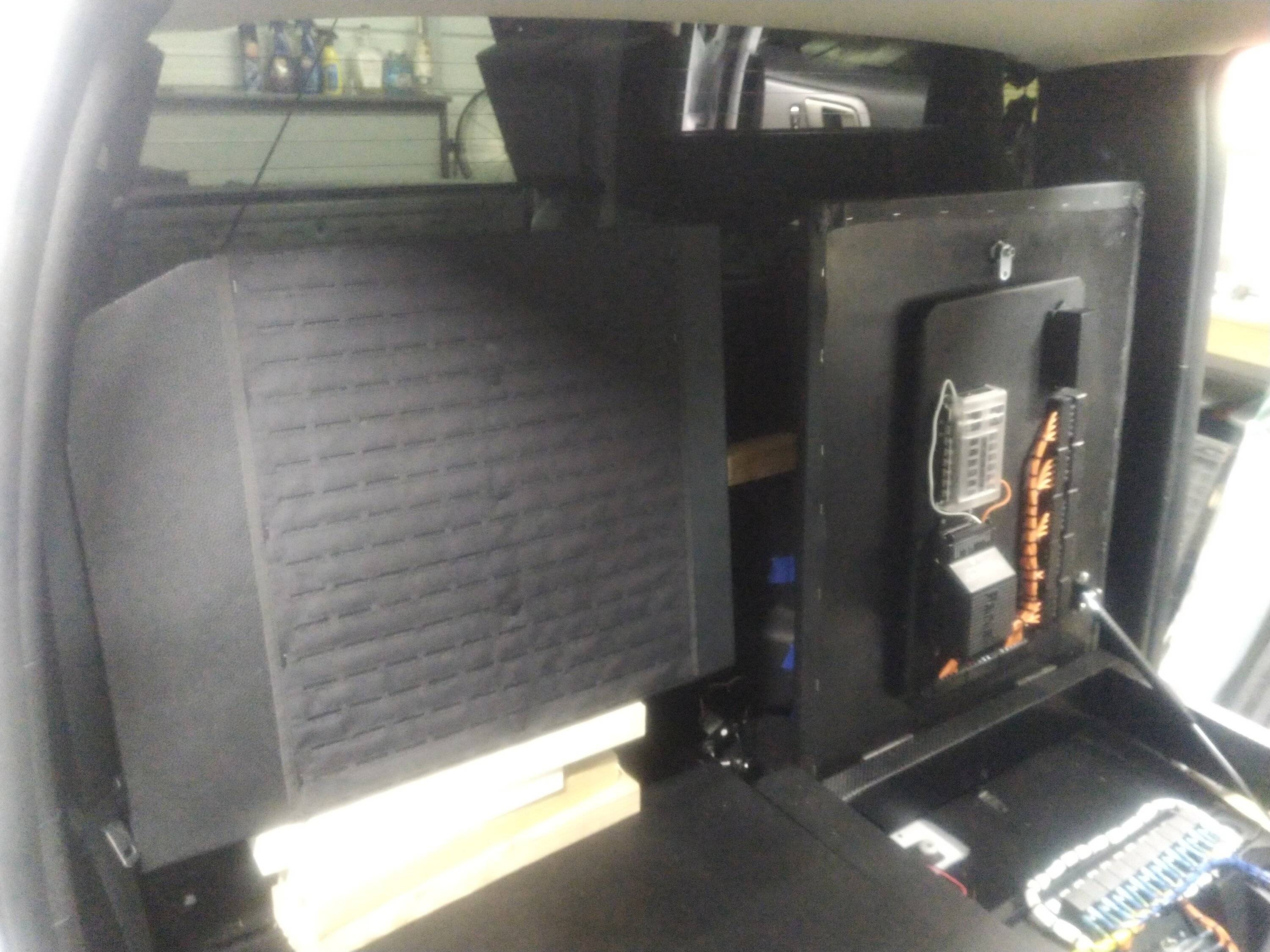

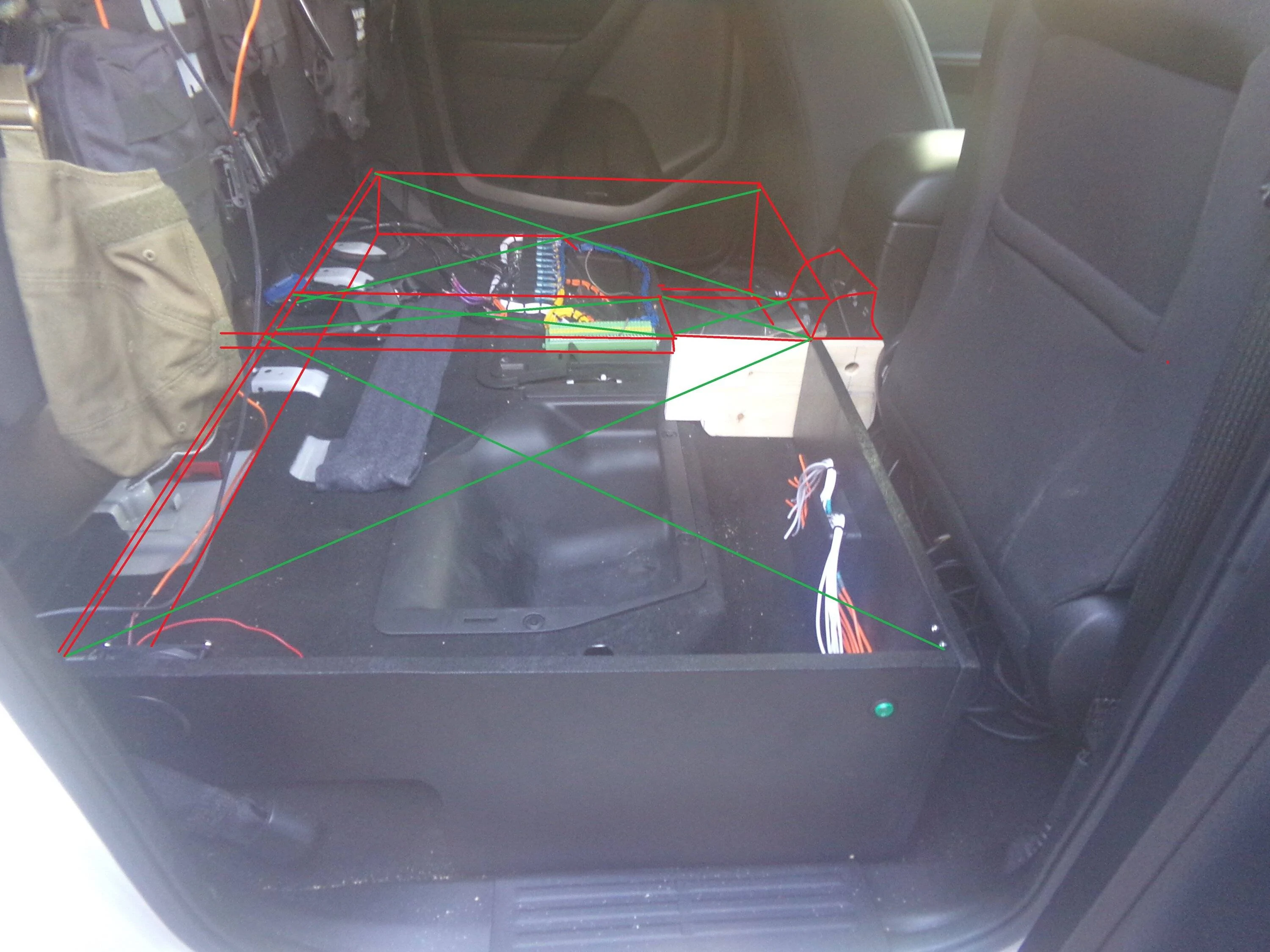

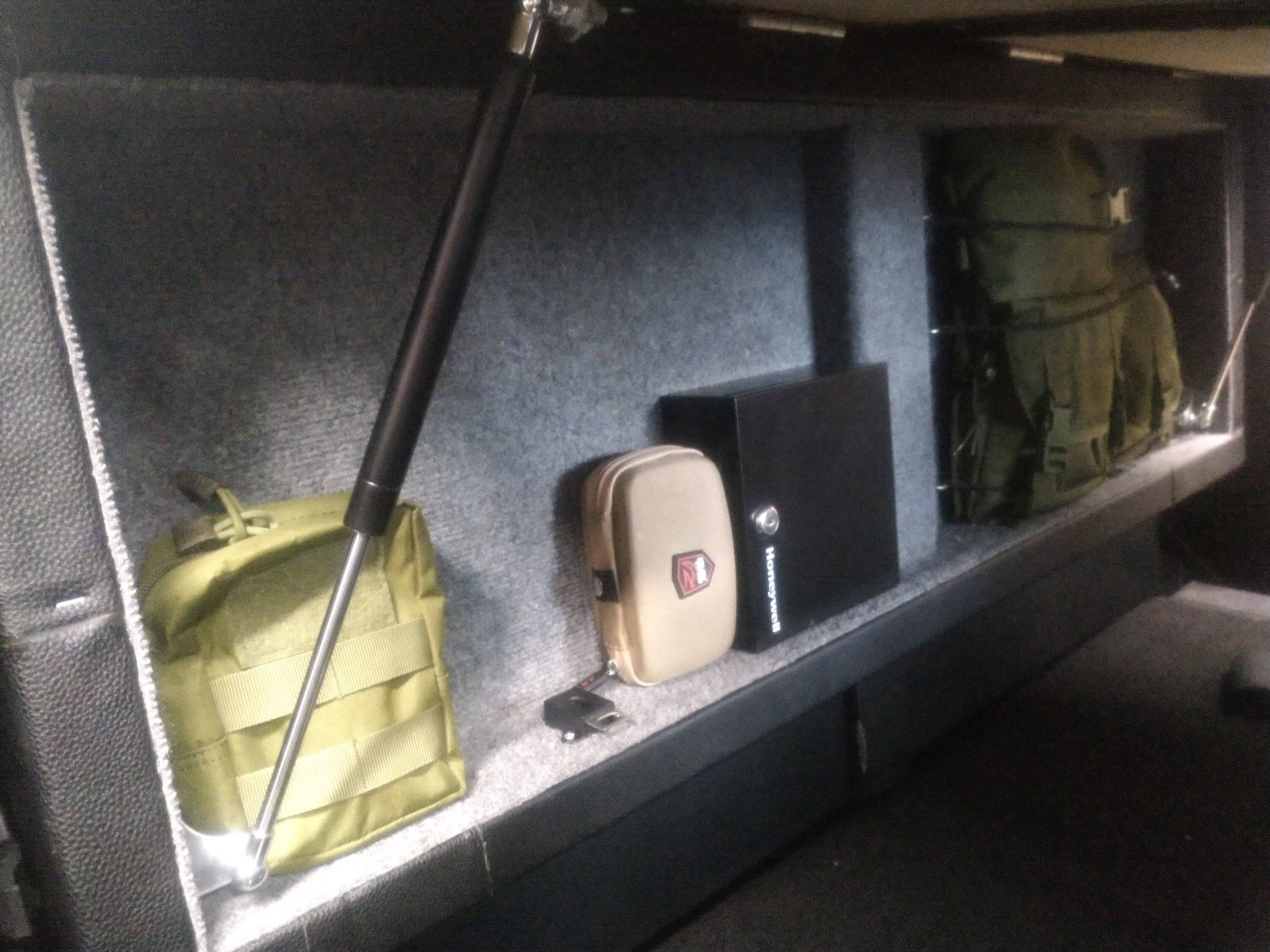

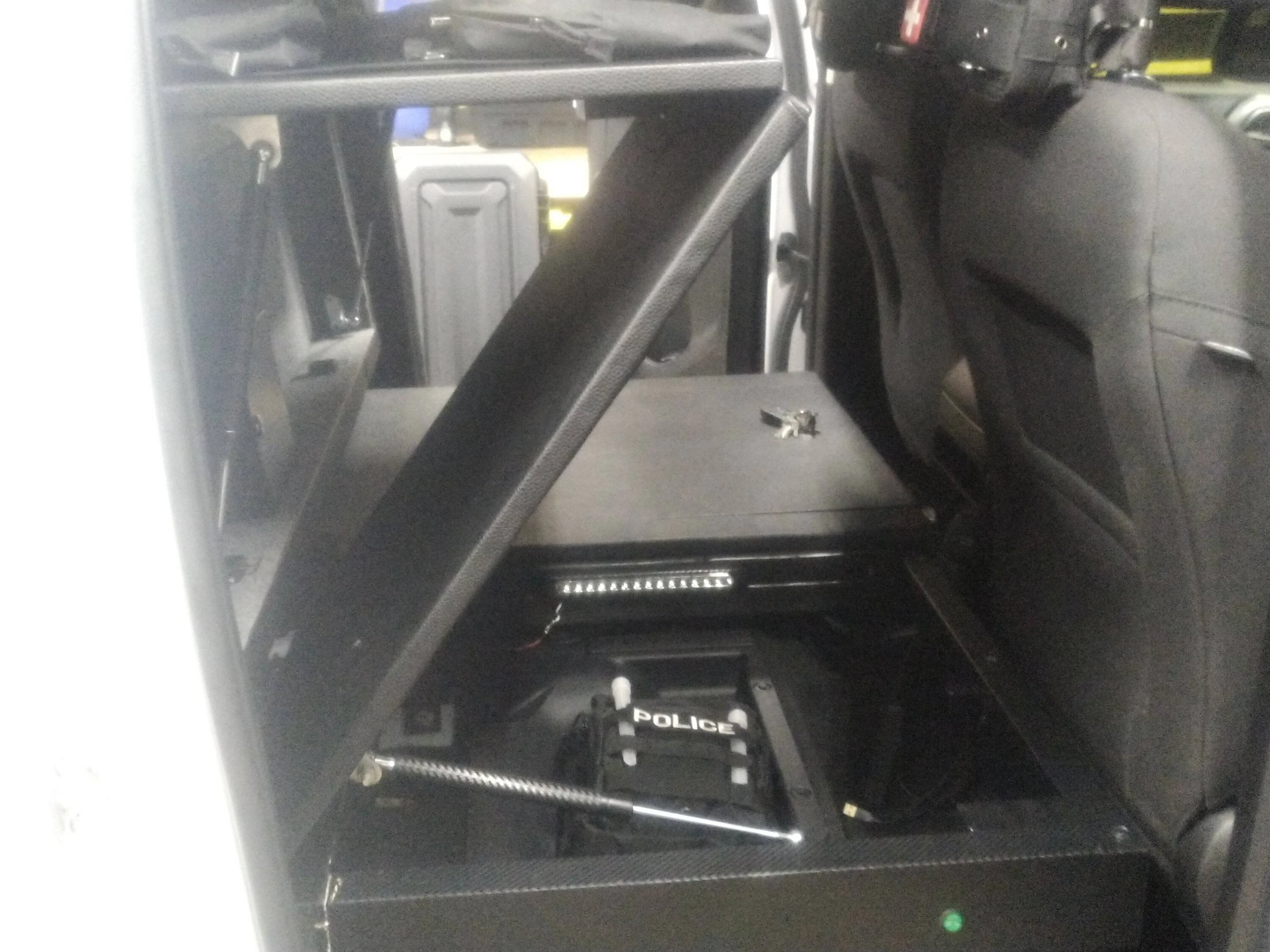

I am almost done with my newest rear seat delete upgrade (v3);
My old (current) setup;
Holy crap that is insane, did you have to do any upgrades on your electrical system to facilitate all of that? I can't imagine the stock alternator would be enough unless you got real creative with power usage

Current installed items is fine for the stock 12v system. With that said, roof top solar array and a secondary battery are on list once the heavier hitting 12v items are to be installed.
