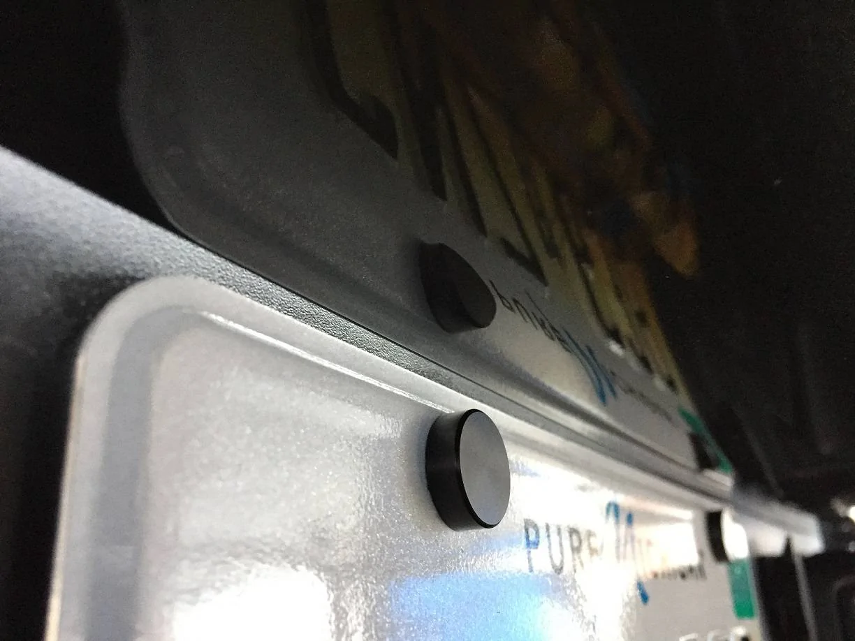

The entire plastic "line" about the plate will be gone...
Look how close my plate is...
Lmk how you get a straight even cut, what you use to cut it.
Thanks

There's a crease or slight indented line that goes across the entire length just above the license plate.
I'm debating if I will use that or measure across just below it...
I'm looking into what type of blade I should use to get a clean-cut without melting the plastic.
