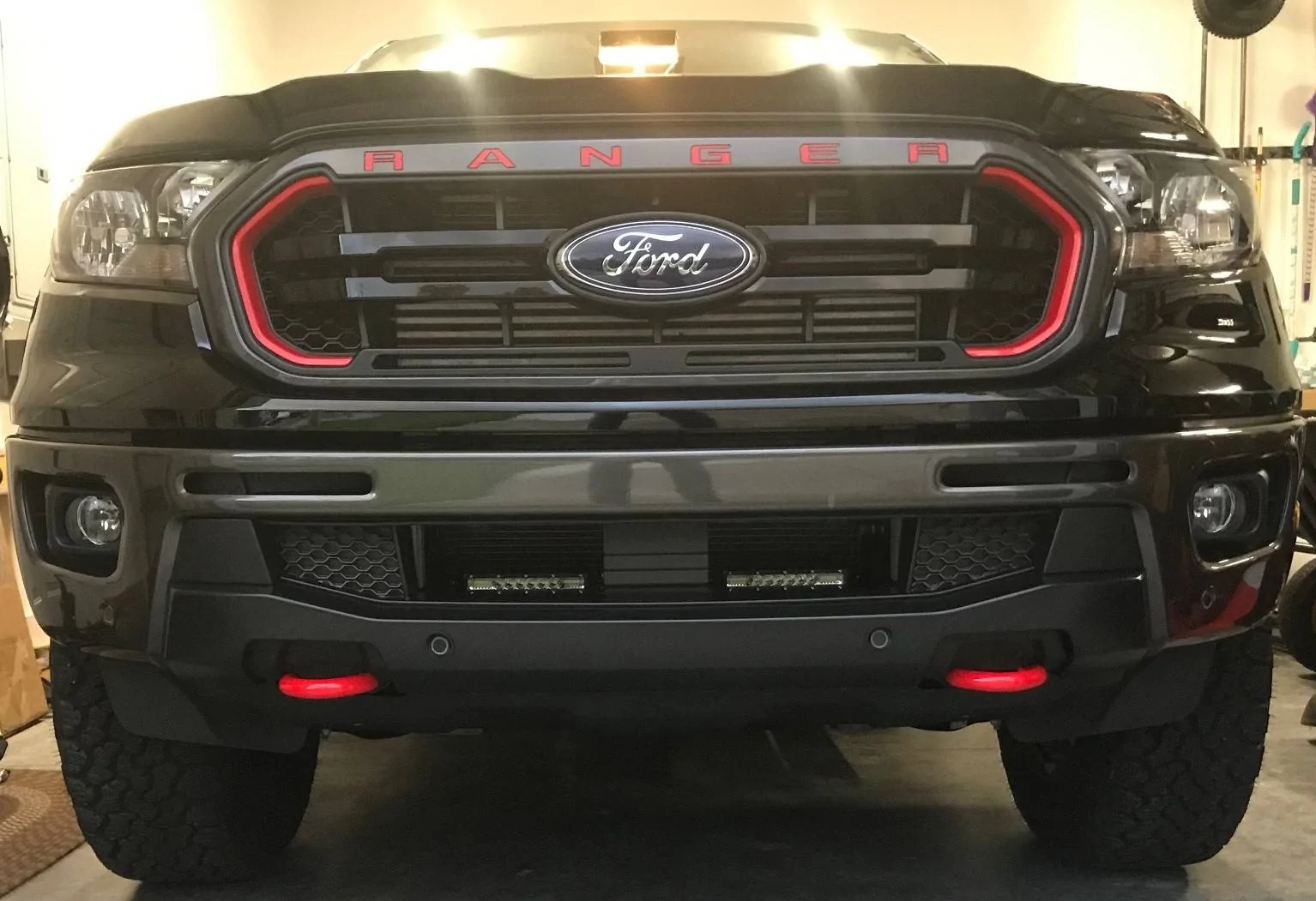

Finished the install today and mounted the lights actually inside the opening and back, rather than even with the opening / radar unit for the ACC. I had to use extra nuts to act as a spacers so the lights would be just tall enough when mounted to the lower plastic plate inside between the bumper and the radiator (or air to air cooler, whatever it is). Actually, it turned out pretty good. Smaller lights but still pretty bright. And I have one light on upfitter switch #5 and the other on upfitter switch #6 on my Tremor. Pics don't do it justice. All wires are soldered, heat shrunk, and inside wire loom, and secured with tie wraps, or zip ties if you call them that.
Now, on to A pilar lights :like:
