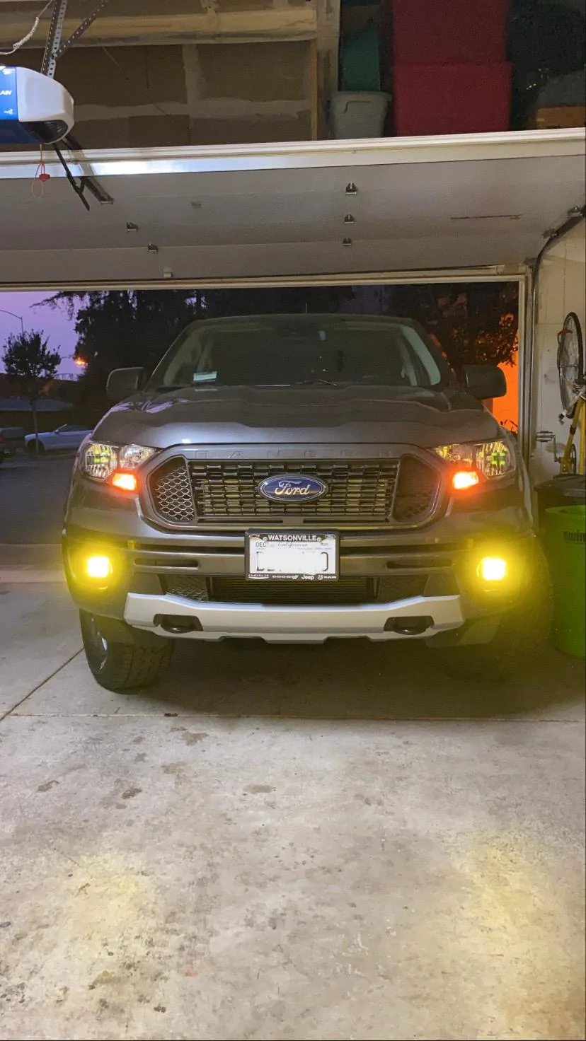

First time posting on here.. very pleased with the baja designs amber fog kit. Couldn't have done it without this thread thanks for sharing your insights.

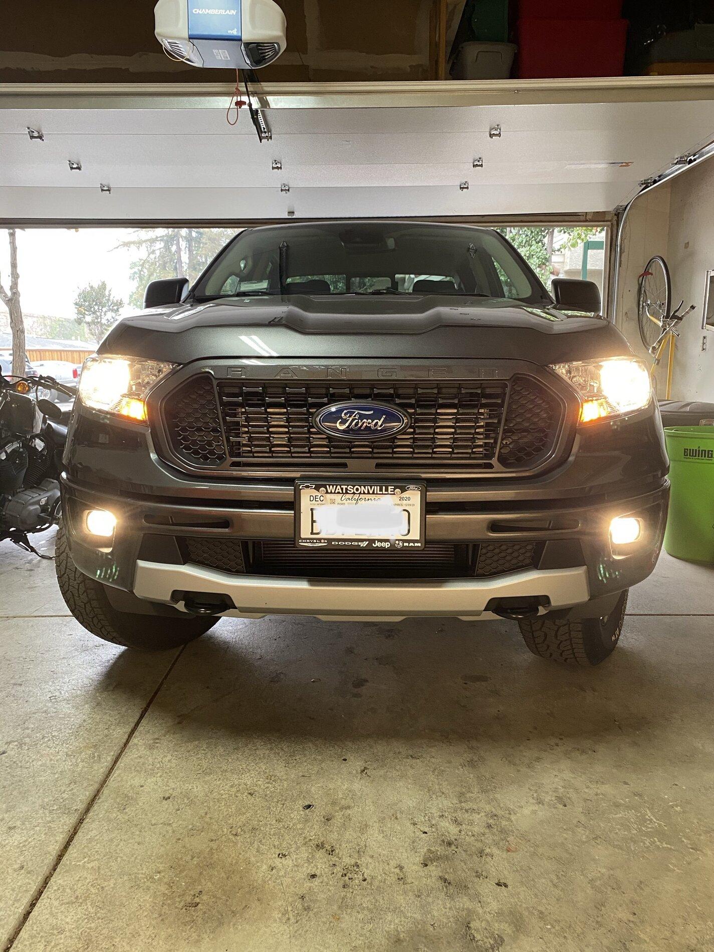

Completed the install leaving skid plate on. I used a dap of silicon to attach the black washers to mounting brackets. 10mm offset was essential for removing the air dam bolt behind crash bars. Also t25 bit + extension made for easy removal/ install of the lights. With the correct tools this mod was relatively easy. These lights look so good I wanna run them all the time in the dark but I worry about blinding other drivers haha.
Raptor grille + leds coming in this week.. cant wait to toss them on to complement the baja designs fogs.
