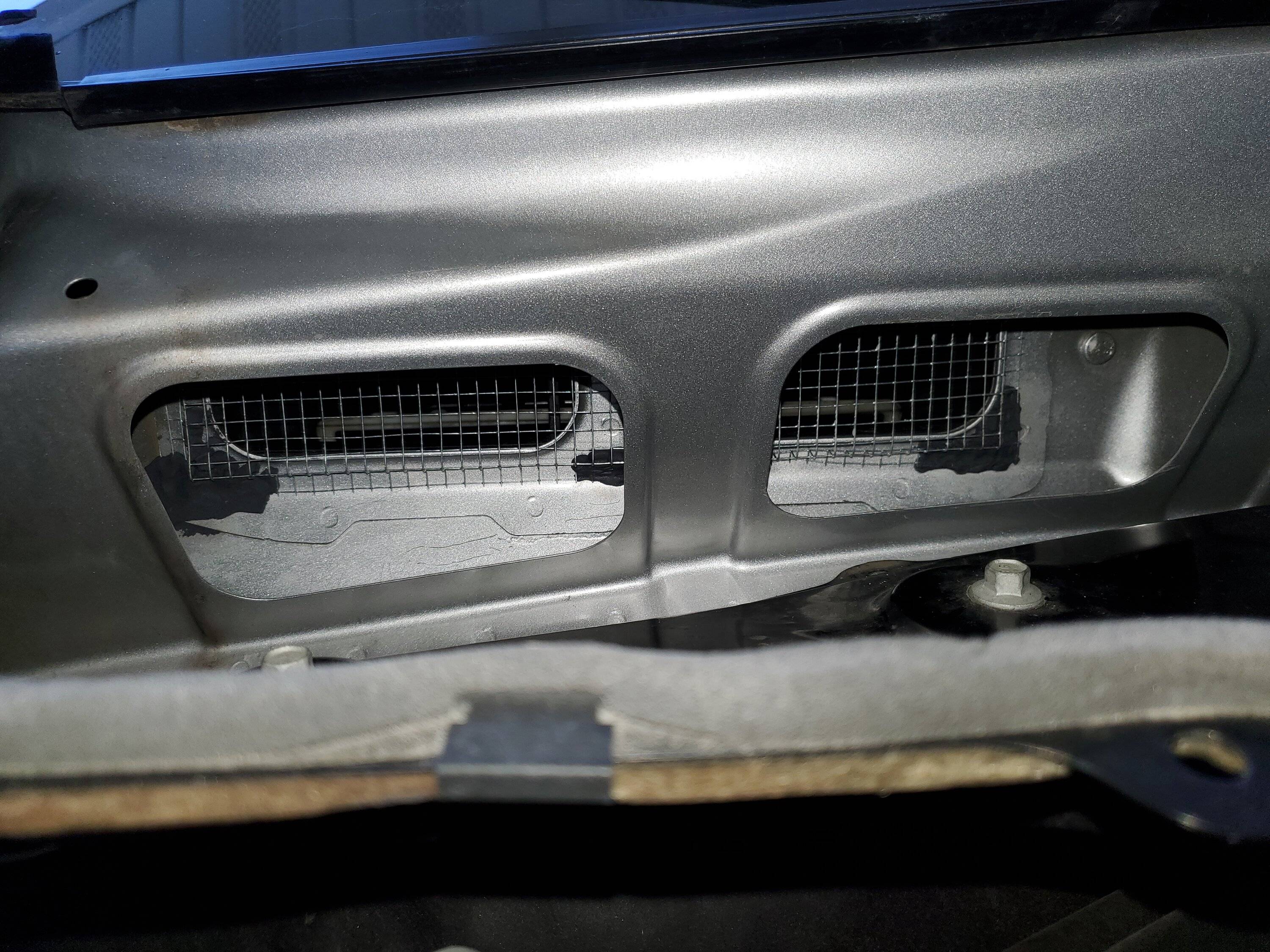

Here is the intake below the black plastic cowl. You only need to take off the passenger side plastic cowl to get to the intake. Mine has wire mesh installed to keep the critters out. You can see one of the tabs where the cowl attaches in the lower right of the picture.

Thank you for the info and pic! Dang mice are building nests in my glove box!
