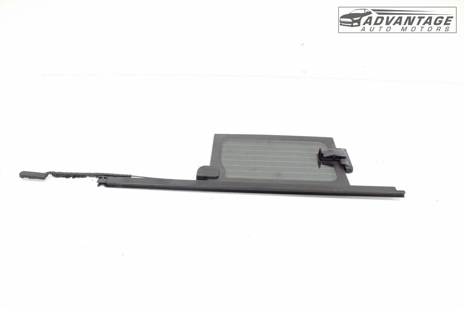

Yes, that could very well be the problem. The slider rear window has its own separate power feed and it could have had a loose connection to the glass grid lines. Opening the slider may have cleaned up the connections to the glass.
airline tech
Aug 24, 2022
4,447
8,498
Midwest - KS
Aircraft Tech
Not the best pic, but it gives you an idea on what the feed looks like.
I would have to physically look but it appears the wire harness moves with the slider as you slide it open and the (left end) attaches to the fixed glass under the trim.
At least you have it narrowed down, I actually forgot about the slider being heated by a separate connection.
So, something in this short run has a bad connection
