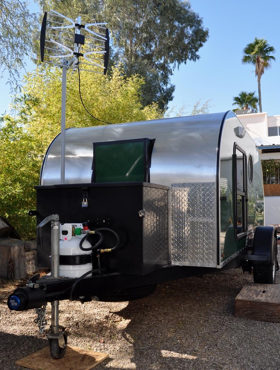

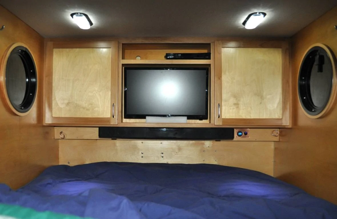

PNW, it's a home build, based loosely on a "Benroy" design from long ago, but with more modern stuff inside. I don't sleep on the ground any more, it's a 5" good foam mattress with a 3" memory foam topper, so it's very comfortable. It's a bit heavier than I had originally thought (wanted 1200#, ended up 1660# dry with nothing loaded), but has 20,000 miles on it now & is wearing very well after bumping along on some rough roads, mountains & a life in the desert where it was built. Basic dimensions are 5' wide, 4' tall & 9' long. 100 watt solar panel, group 27 AGM battery, stereo, flat screen TV, sound bar, BluRay player, etc. etc. etc...
You can see more about these things on the TNTTT web site. Go to the "Builds" & take a look at Tony Latham's journal (#4) to see the procedure. Mine uses aluminum skin, his is epoxy & bed liner, but they are similar.

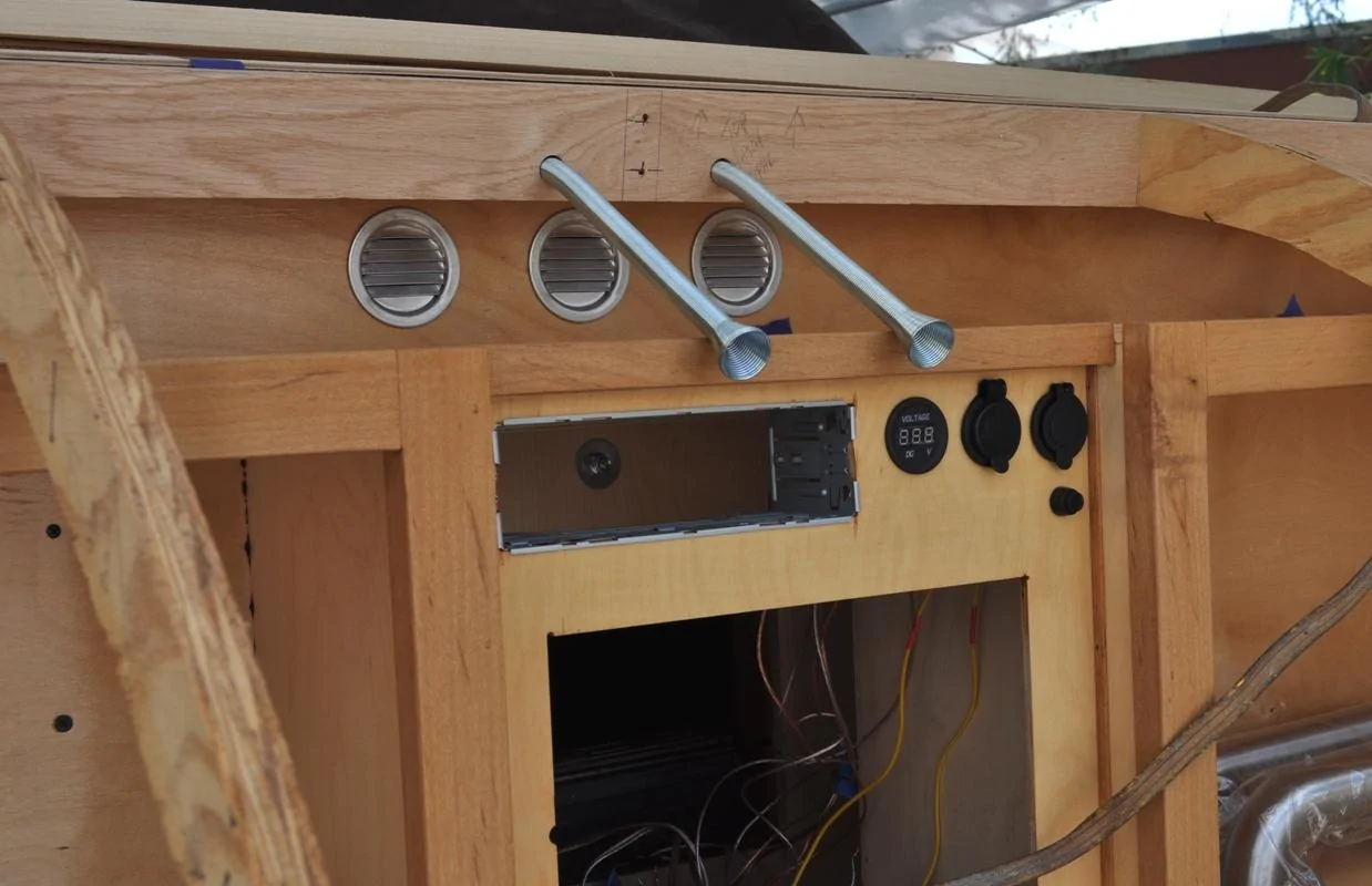

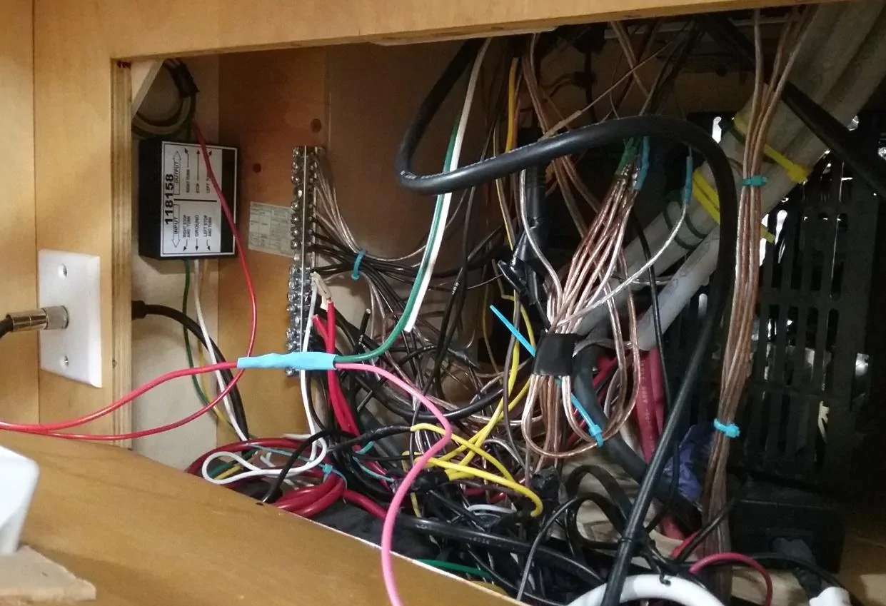

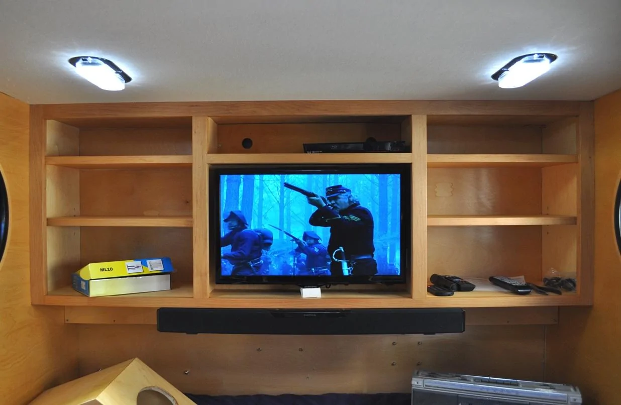

We got a bit carried away with the build as it sort of morphed into more of a luxury build than I had originally thought. Thankfully, all of the wiring was installed before I had any more changes planned or done. That was the biggest PITA on the whole thing, it's a lot of planning to make it work properly. Here's how the wiring-in of the 3rd brake light went, which is on the back of the hatch to make visibility better for those behind us when stopping. The hatch has 2 channels for the stereo, an overhead LED galley light, the back-up lights, 3rd brake light, a ground system & the license plate light. Stereo wiring, inverters, converters, lights, fan, running lights, main power panel, etc. access panel is behind the flatscreen.
Conduit for the hatch is a pair of copper tubing benders from Ace hardware. Once the harness was made, I taped the wires & stuffed them into these springs for flexibility into the hatch. This shows the hatch prior to skinning & galley cabinet setup before it was put together & wired with all of the stuff that went inside.

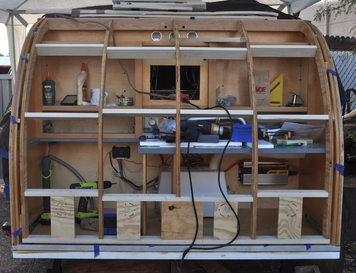

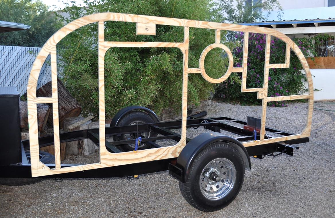

Another picture of the trailer build, mock-up on the frame of the "skeleton" wall
7,085
37,244
Hi Tim,
Excellent craftsmanship!

Thanks Phil, it's a nice way to build, lite & strong, fairly simple & lends itself to a strong structure. The "webs" are potential hard points for shelves, bulkheads & cabinets. They provide good material for screws, slots & wire runs. It was a challenge to make this camper, but worth the effort. Lots of planning & thinking involved as I had never made this type of "box" before.
I'm still plowing away on editing for the build journal, I get about a page a day with uploads on the images.
