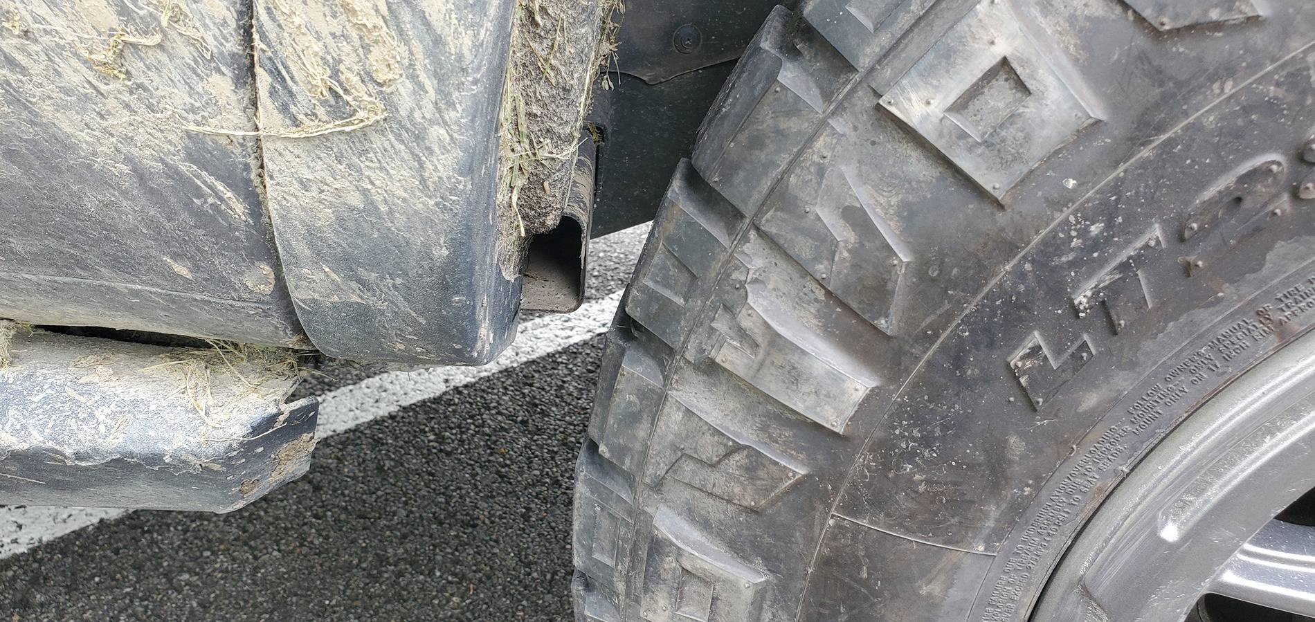

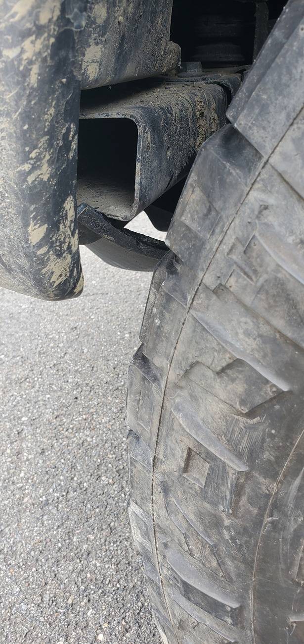

Rough Country 3.5 and I am running 285/75, sometimes I still hear it rub on the little plastic flap under the bumper, not enough to bother me LOL
