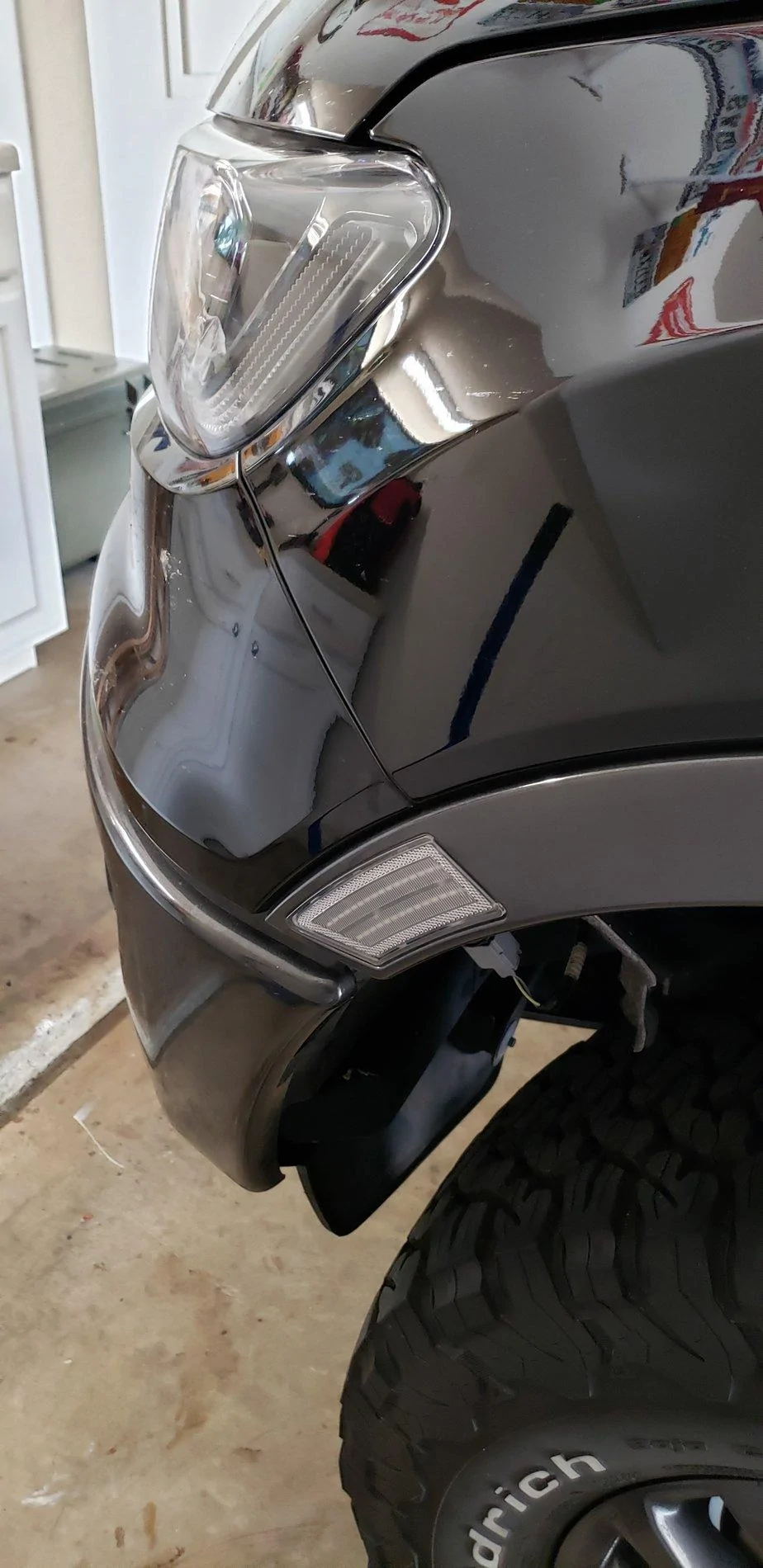

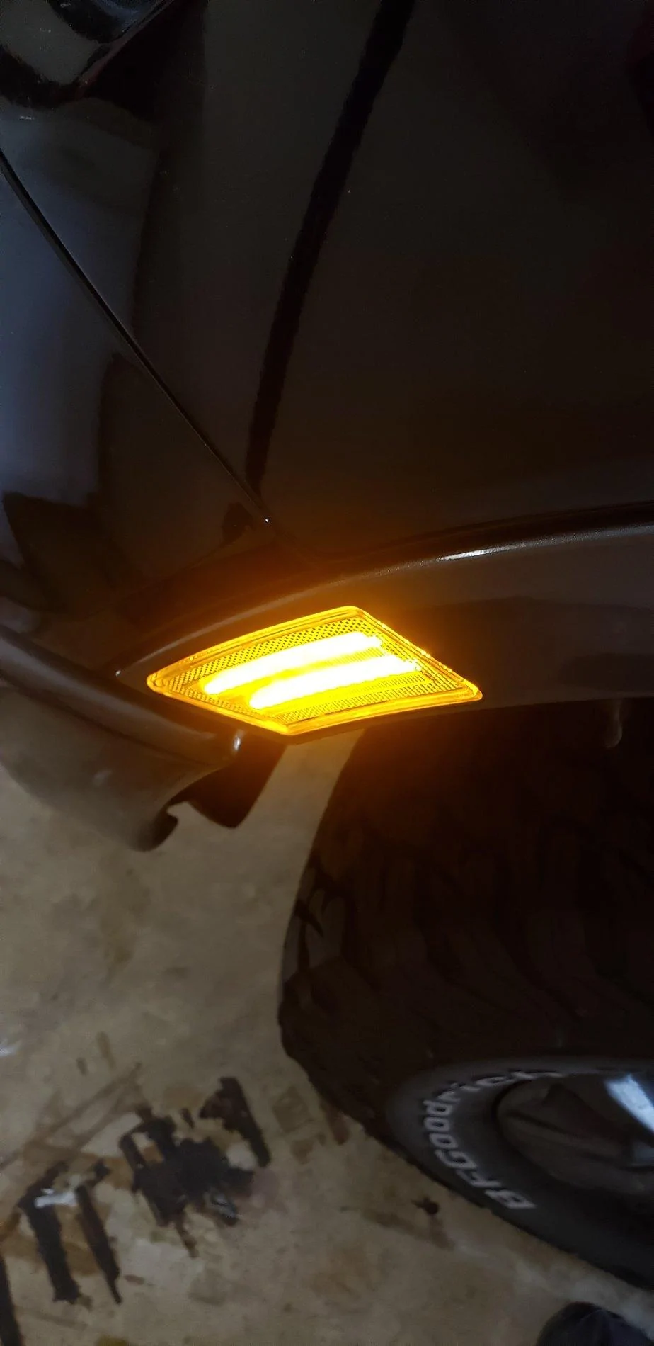

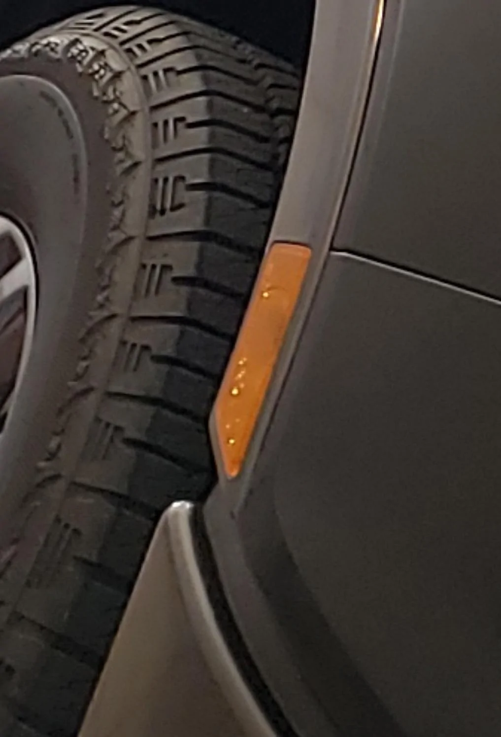

These are direct replacements for the marker lights on the wheel fender... they don't blink, just illuminate when the truck is on. They work great!!

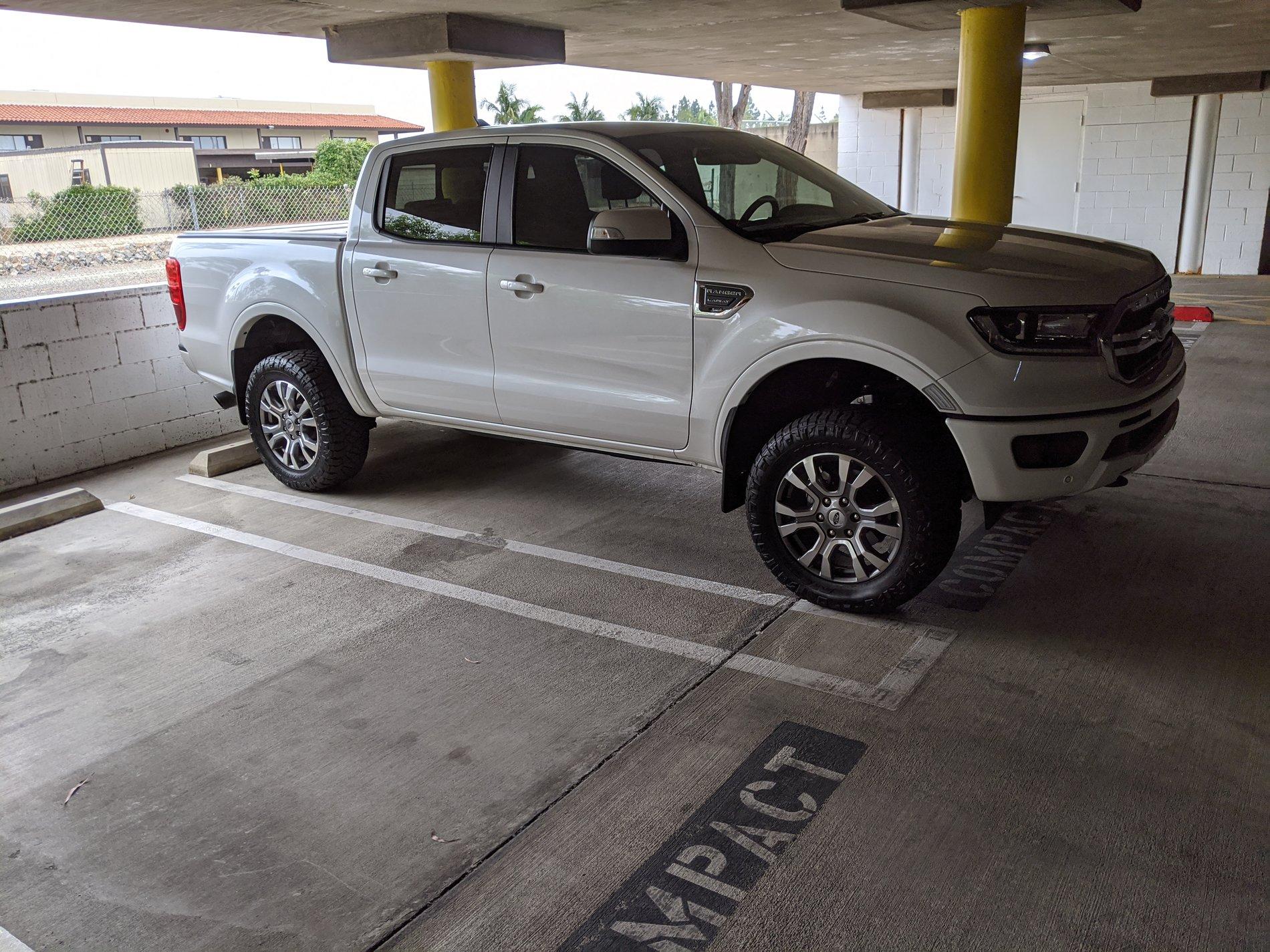

I think smoke on the magnetic trim will look better (since I tinted my headlights) Vs the clear.
clear looked good on the white.

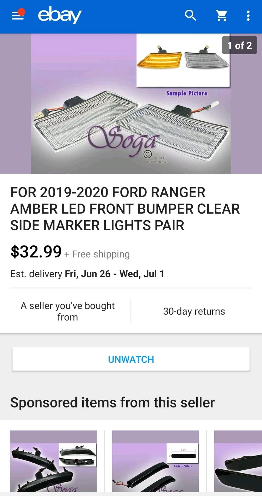

I like the smoke, $33.... so do they work or not? I want them to function like stock, no blinking.
I added the smoke ones last week. Drop in replacement with no fitment issues at all and so far they don't flicker/blink.

I got them off Ebay. So they may ship to Canada, or you may get lucky and find a seller on your version that's selling them.

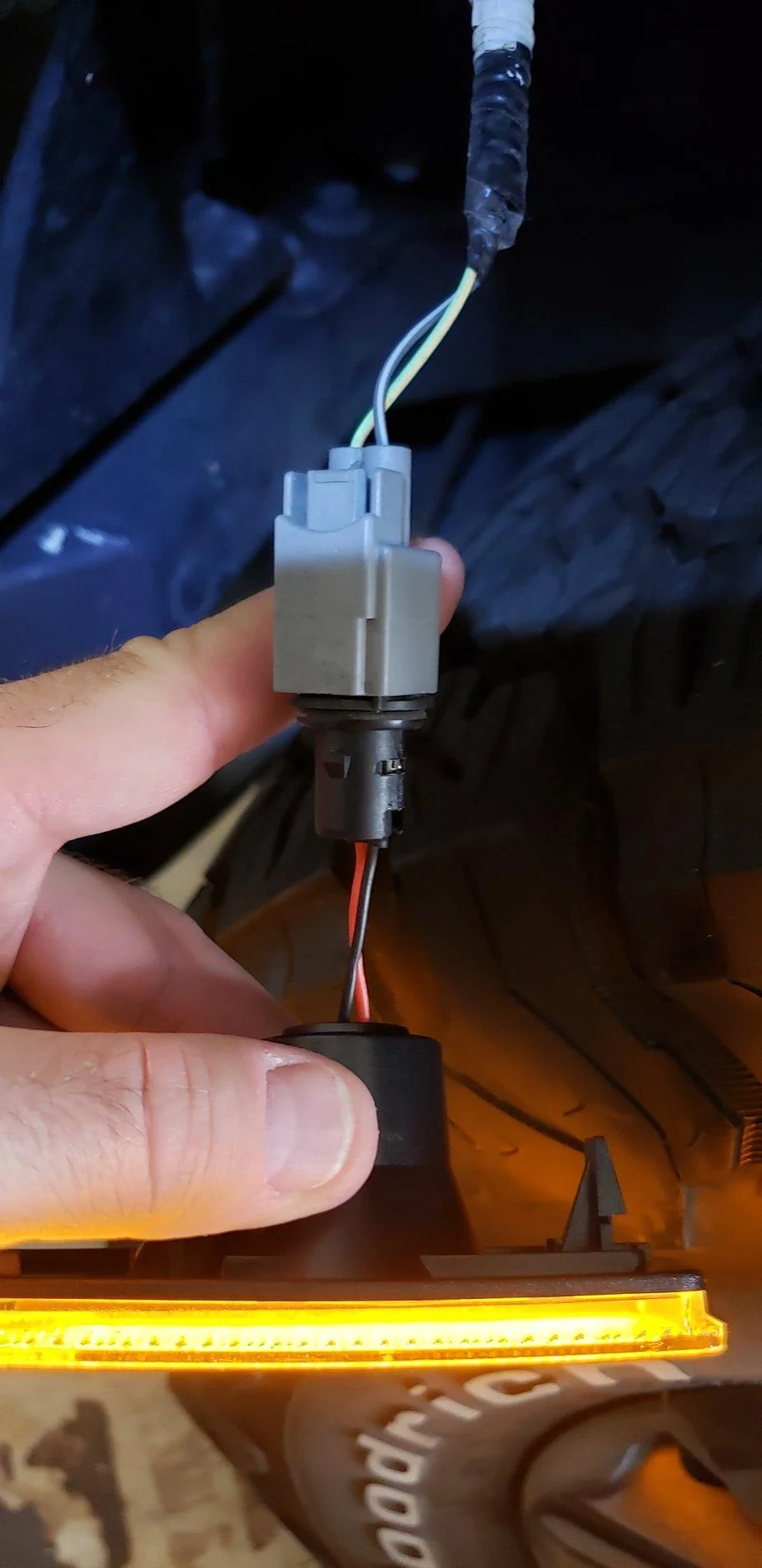

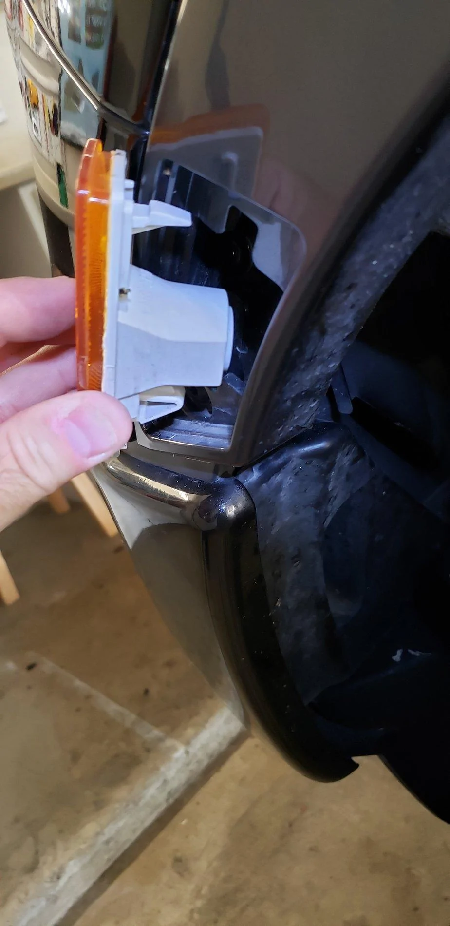

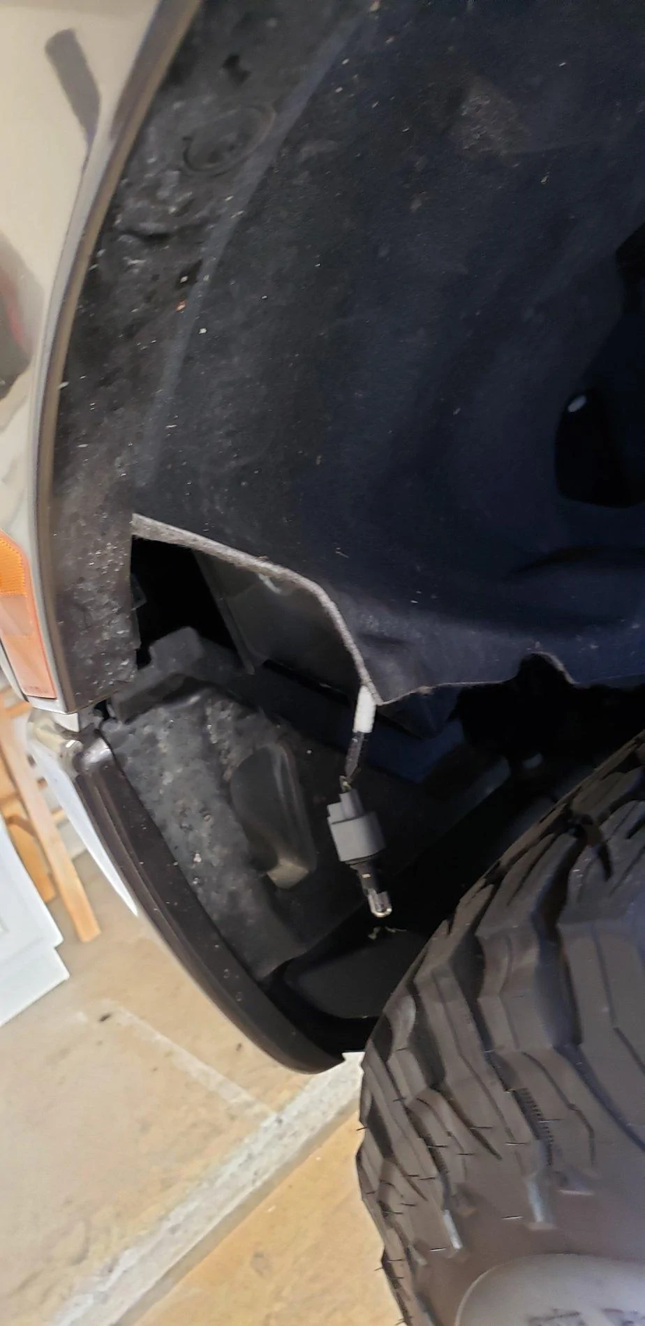

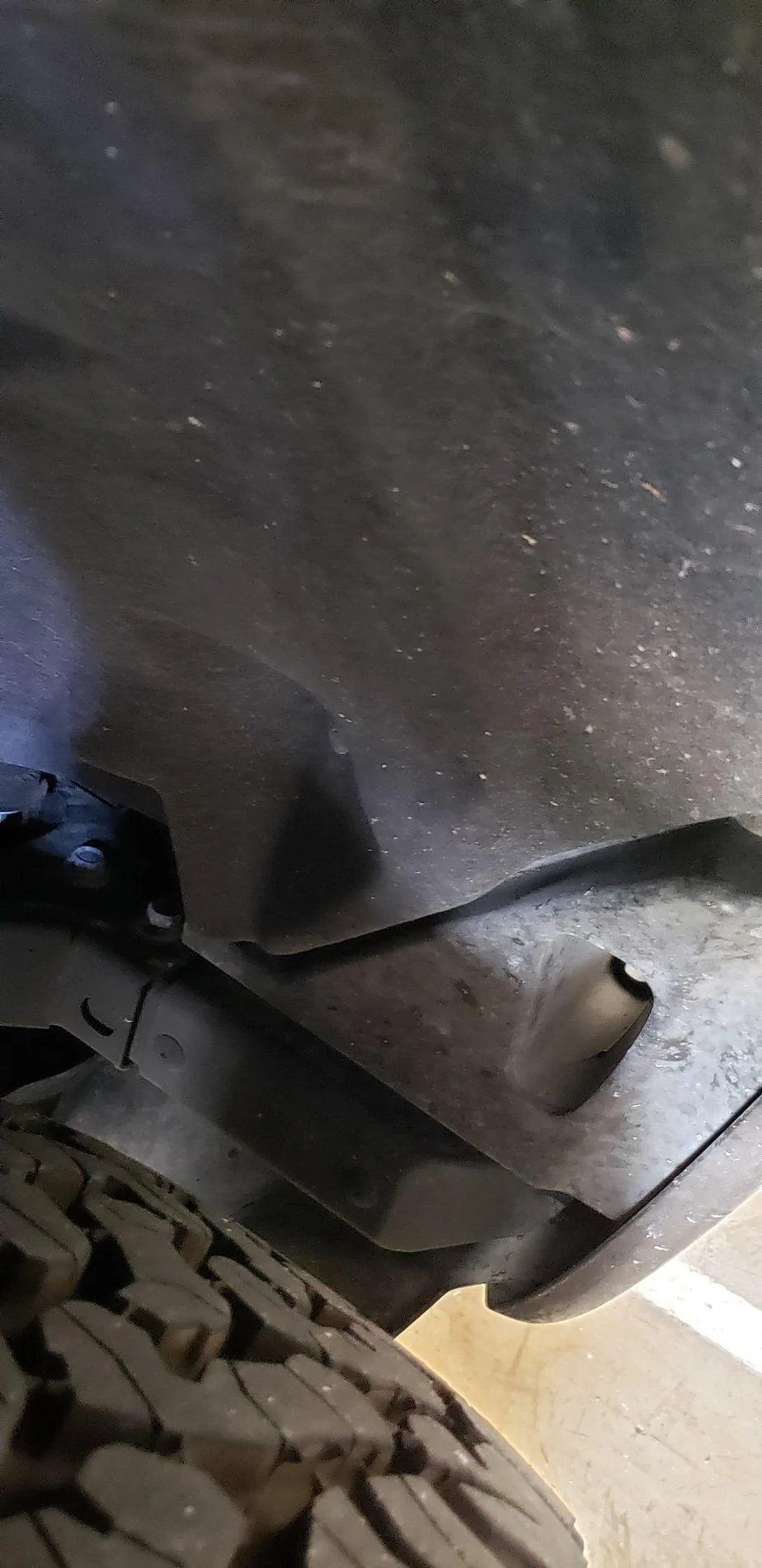

5 min install if you take the time to drink a beer when you’re done. No need to remove a push pin or the wheel liner. Use your new part as a guide, you can push past the edge of the liner and feel for the clip.
