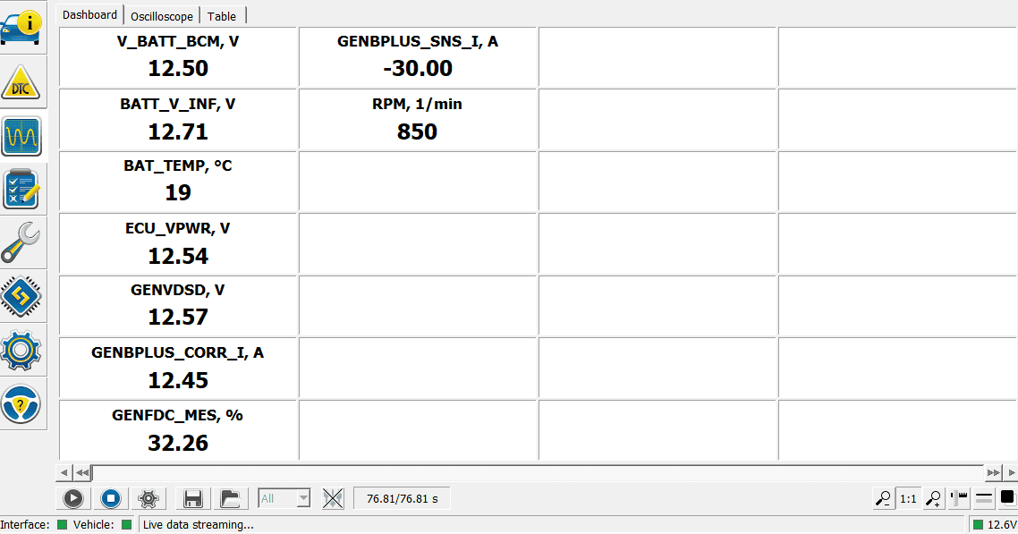

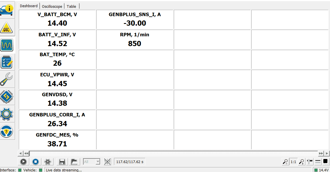

I am working on a hunch - but when you get it back together, I need to know any other issues you are having other than throttle limitation.
Anything else noted - hard starting, IPC Messages, door locks not working and I am focused on the Gen Desired Voltage - defaulting to 10.6
Plus, it would help to know, what has been Replaced and or checked so far - Detailed
I have a hunch that the PCM is losing the ISP-R. (Input)
Ignition Switch Position Run - This data is sent across all the data busses.
But for the PCM:
BCM to PAM & PCM - via HSCAN 1
With KOEO (Key on Engine Off) that is the normal Gen Desired Voltage 10.6 Volts, so it MAY possibly be an issue on this circuit, the PCM is thinking the engine should be off as it may be losing the ignition switch position.
