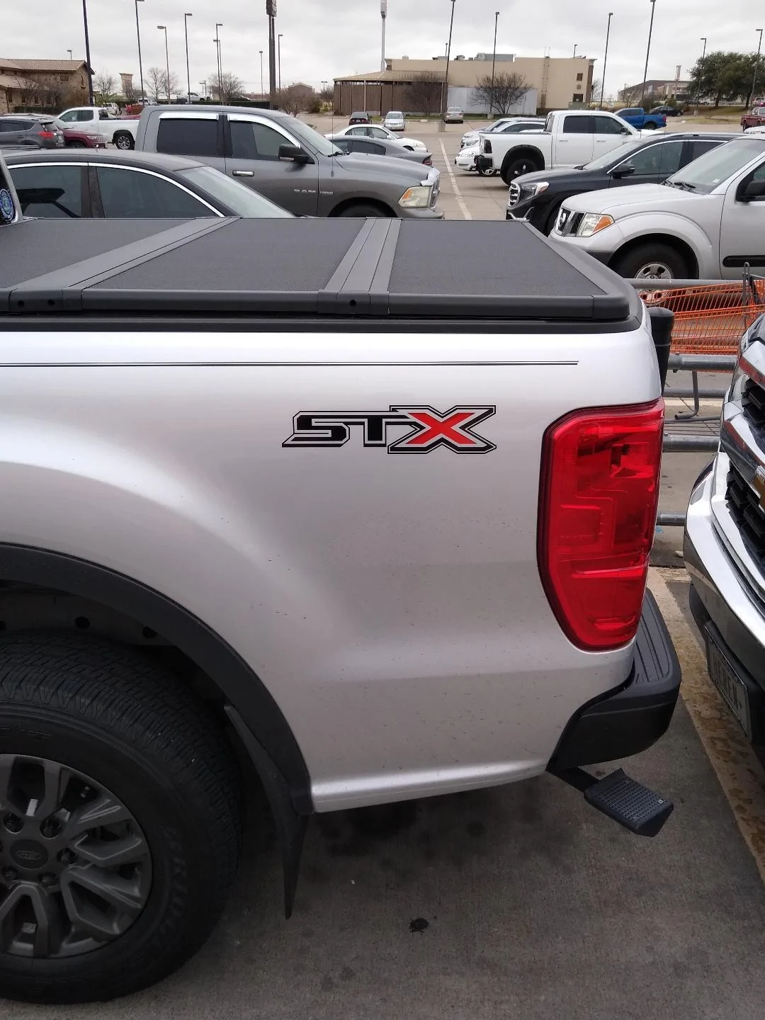

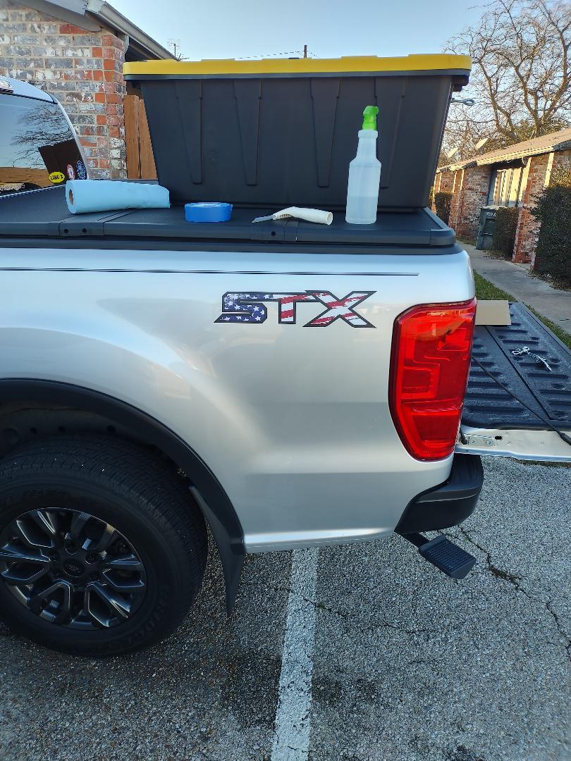

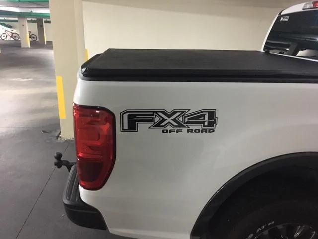

Just a minor change to the STX logo.
Looks good. I changed out mine too. I didn't care for the red FX, but your flag motif looks good.

How did you guys change those? I wanted to change mine but the guy I talked to just stopped talking.
Run a piece of blue painters tape just above or below the old decals, unless you want to change the location. Then heat them up a bit with a hairdryer and they peel off in one piece. Clean area. Apply the new decals using the wet method. Squeegee the excess water and let dry. Decals can be found on either ebay or Amazon. Pretty easy to do.

I see, I was looking for the sport decal with more red on it, a custom designed decal.
My STX decals came off all in one piece and left no residue. Didn’t even use heat! Got super lucky ?
