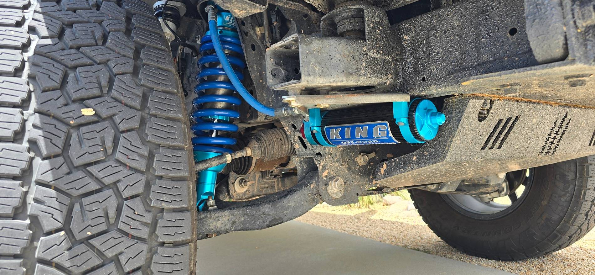

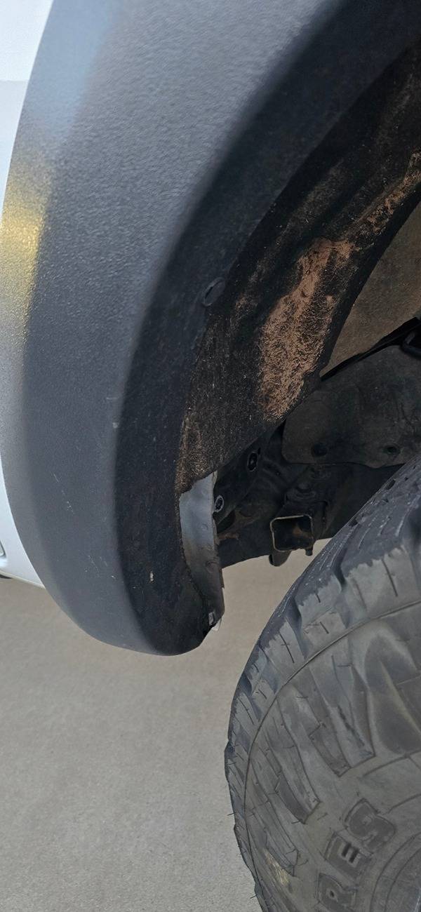

did you cut the crash bar before you seen if it was going to rub?
I see a lot of guys cutting theirs off....
I have bigger tires than most and I still have mine and it dont rub, mine kind of hit that bottom plastic rain flap but not bad enough I want to waste time to do anything about it LOL

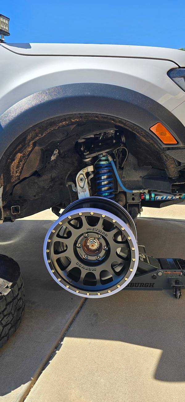

With the 3 inches of lift it didn't rub when I had +25 backspace but with zero back space it rubbed pretty good till I removed the crash bars and the plastic waffle. Now it's free an clear.
