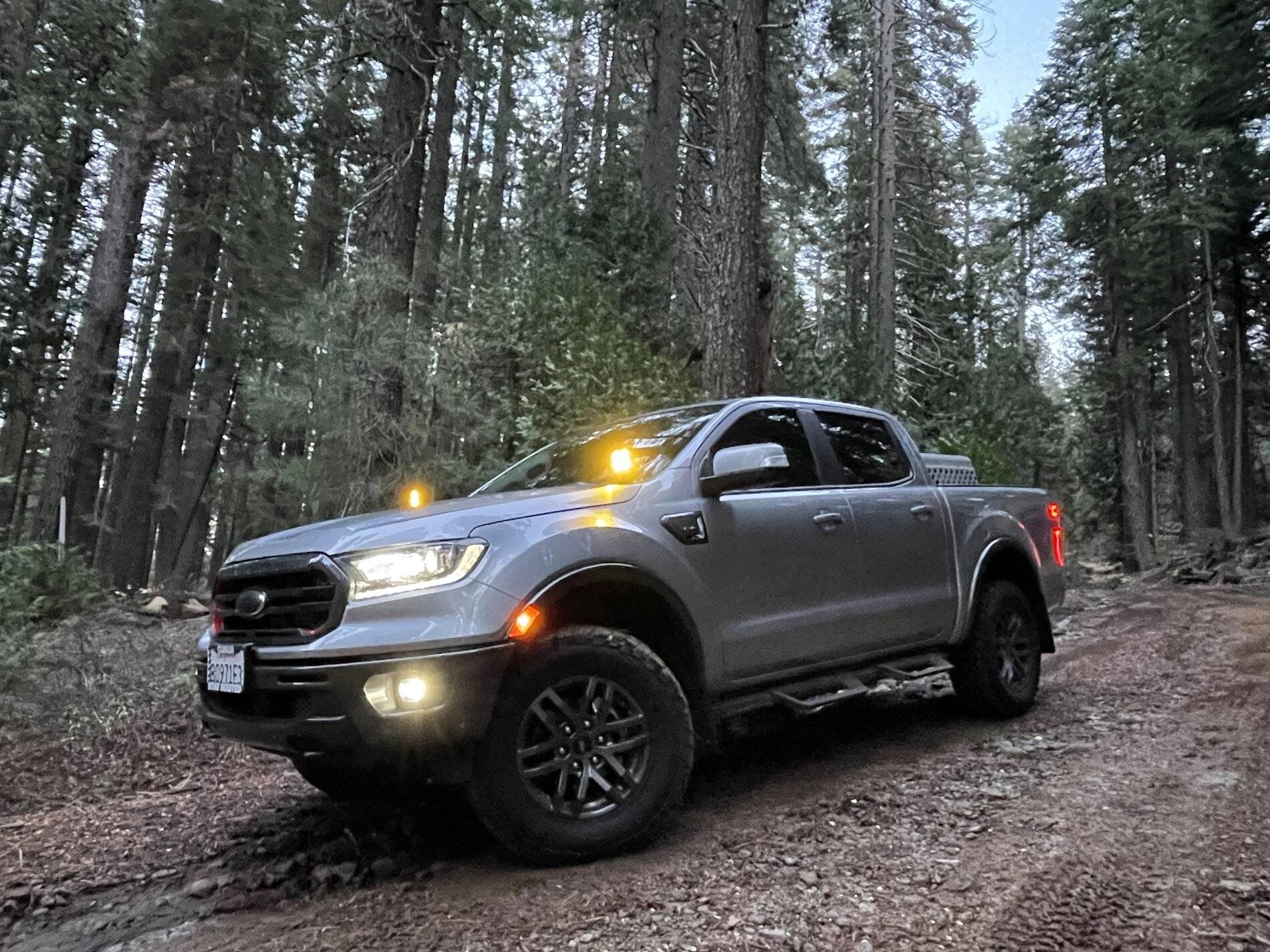

I have the specialty performance ones with rigid lights.
