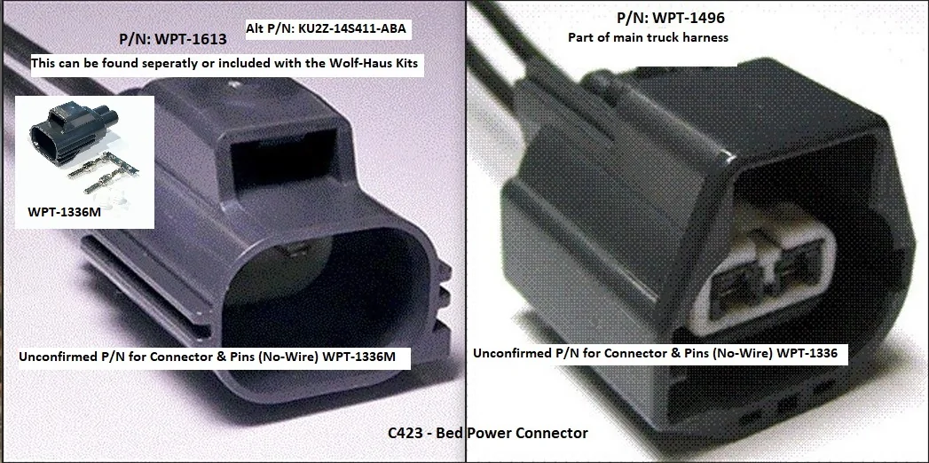

I’m sure this has been beaten to death here but I can’t find a good source for the bed accessories male pigtail plug or connector. I’m sorry but I will cut the wires and splice them before I pay $30 Or more. one guy had them on Etsy for a few bucks but he is out of them. Any help would be appreciated!

You may try searching for this Part Number: WPT-1613 (Pigtail) or WPT-1336M (Connector & Pins -Kit)
Yes the connectors are pricey but to do it right - You have to pay to play
They are environmentally graded and sealed - thus the price.
I can only confirm the WPT-1613 is correct @ this point, but believe the WPT-1336M is the same connector without the wiring pigtail and you simply would have to crimp your own wire with the proper crimp die.
Wolf Haus Off-Road offers this as well, but the actual part number of the Male Half is noted below from my notes on the wire connectors.
It is sometimes difficult to find the part numbers for just the connector and parts without the wire pigtail as the Ford manuals do not give that info to you, you must dive in online (connector vendors) and locate a matching connector.
