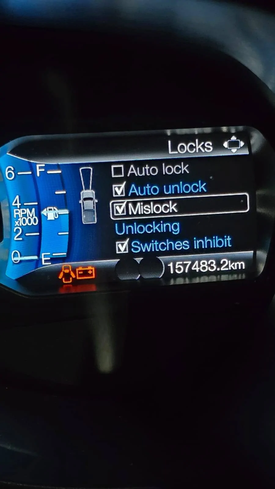

Auto lock on 2019 Ford ranger Wildtrak X greyed out

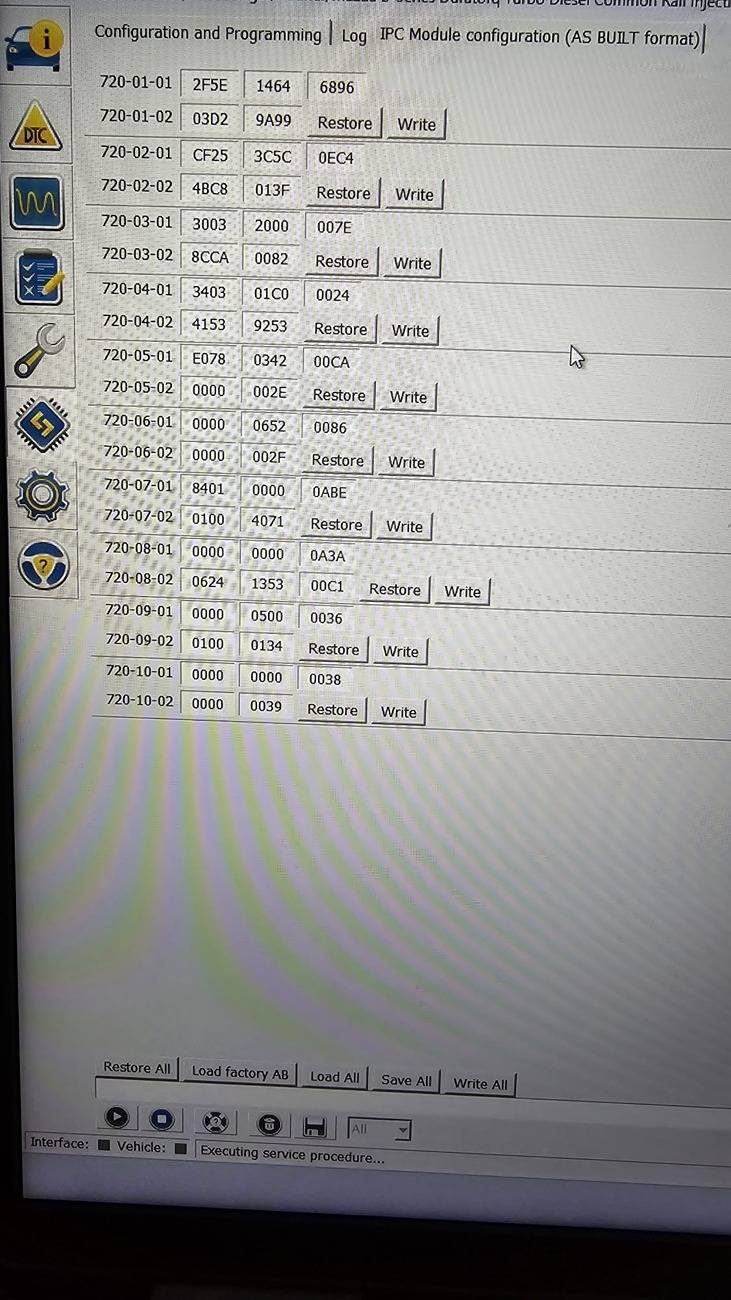

I should also point out as far as the IPC setting - only change this
xxxE-xxxx-xxxx to xxxF-xxxx-xxxx
Note: The (last 2) characters of any line are the (Checksum) and they will automatically change when anything on the line is changed - It's basically a validation sum (is the line written in a valid code)
So, when you change your (E) to an (F) - the last 2 on that line will change automatically

And by your posting
for IPC
720-01-01
It appears you DO NOT have ASS (Auto-Stop-Start)
as
xxxx-1xxx-xxxx indicates ASS disabled, I am one of the fortunate ones who has this disabled from the factory (covid delete) chip shortage, so my line is also xxxx-1464-xxxx vs all others as 3464 (3 indicates enabled.

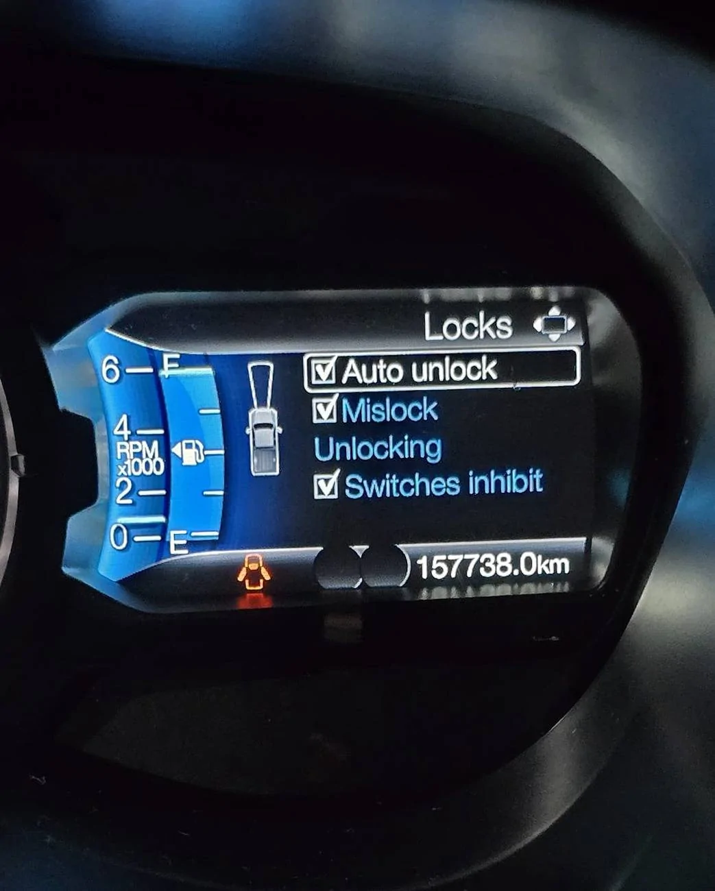

I do not know what kind of magic you swallowed but it WORKED!!!
THANK YOU VERY MUCH, I really appreciate it.
YOU ARE THE BEST. I am sooooo happy.

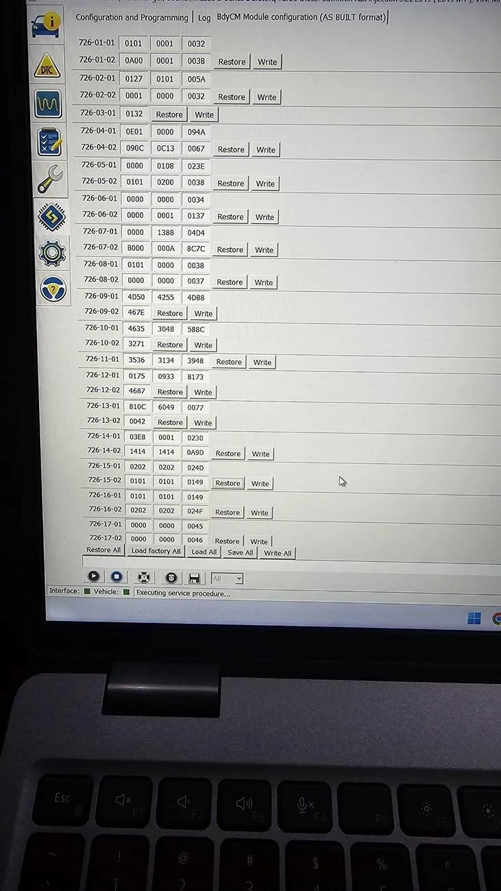

I would also like to point out that for BCM I used this exact value in full (all numbers)
BCM:
726-15-01 - 0101-0101-0148
But for IPC I only changed the value from E to F and left everything else as is. I did get a message saying that the checksum is not correct and do I want to continue and I clicked yes and auto updated the correct checksum:
thank you very much @airline tech!!!
