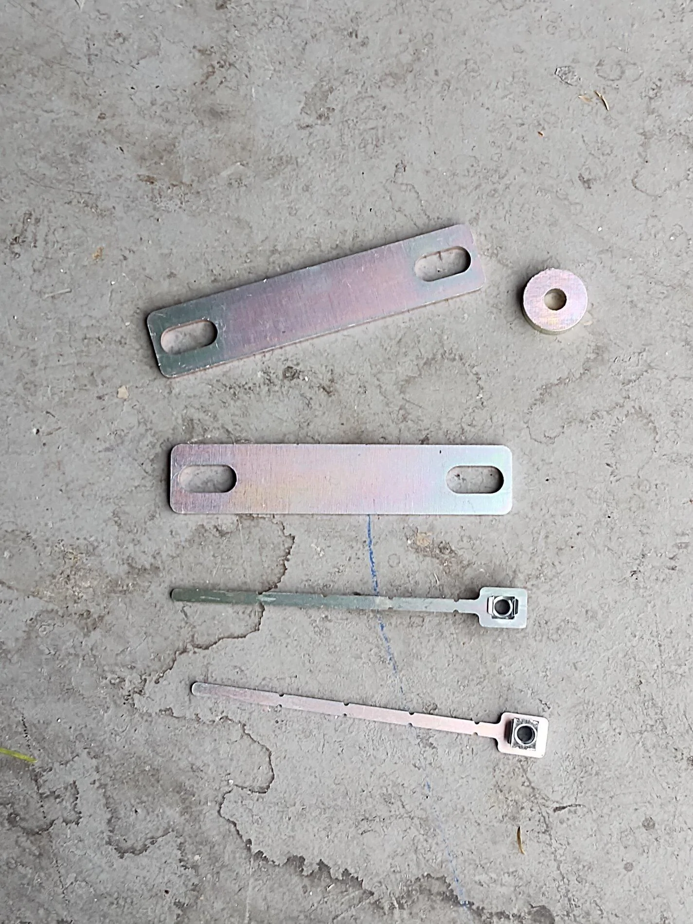

What are these and where do they go?

I saw one. The one with the 2 beers/3 hrs? Didn't go deep enough. Didn't talk about the fasteners.

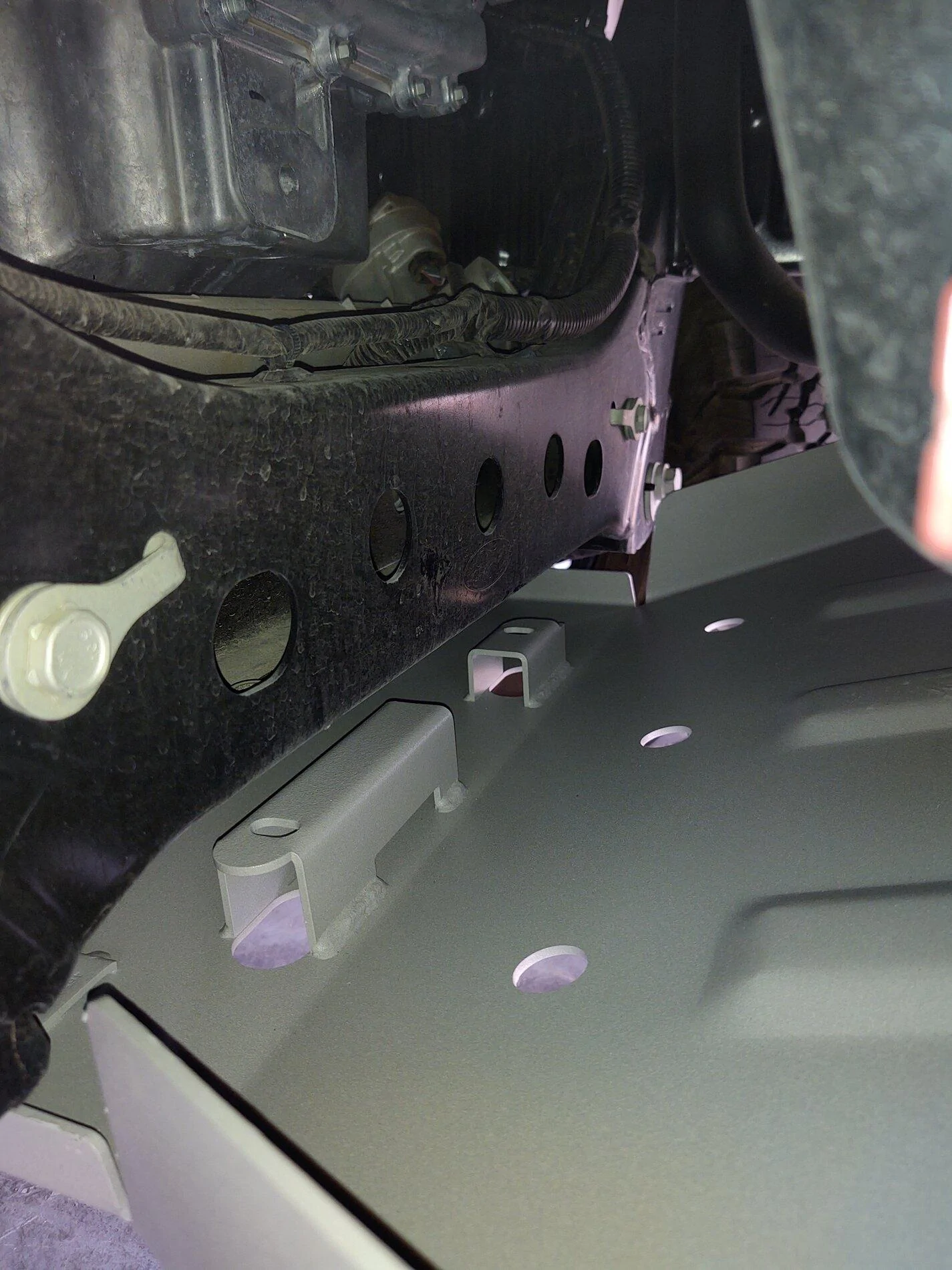

Seriously? These two points will not meet up to the crossmember. Is that right? Doesn't feel/ look right. I finagled the fuck out of it. That's the only way they'll line up.

Well I gave up! Idk if it's the right one? I can't get the front one to fit.

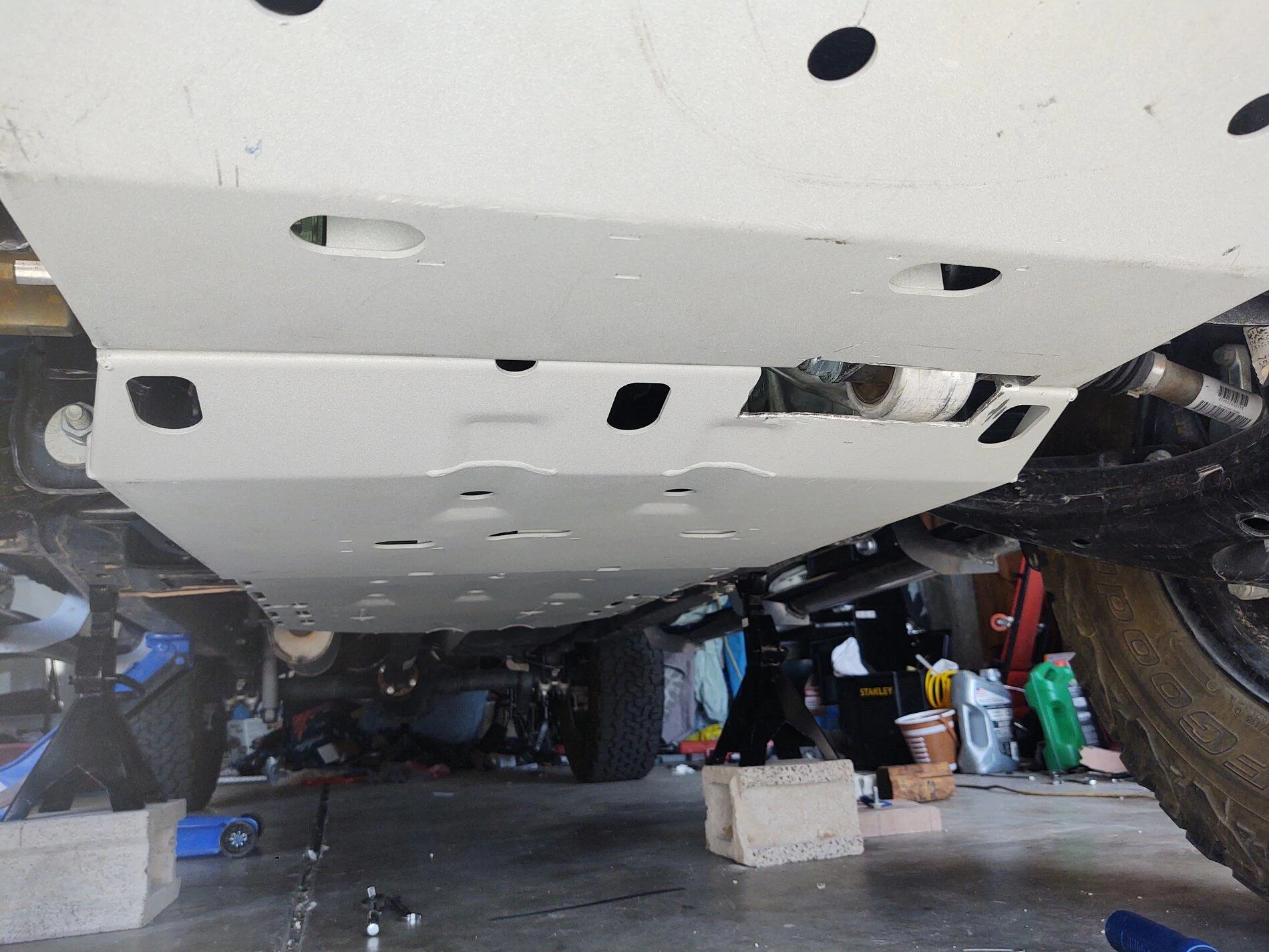

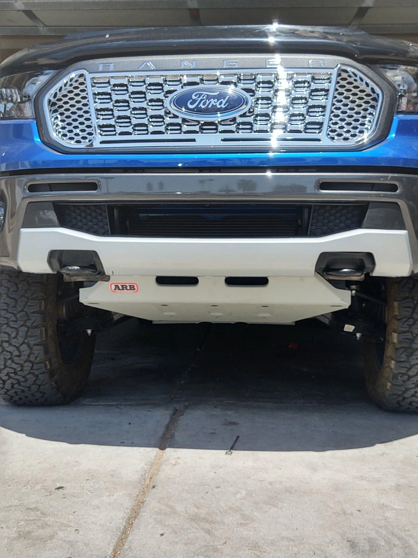

So she's done. Beware if you do a diff drop, as part of your lift you will have to modify the two front ARB skids. The dude at ARB confirmed this and told me what I did was the "necessary steps" that had to be taken for them to fit and it's exactly what he would've done.
I'm glad I didn't know beforehand or I wouldn't have purchased them. But I added an angle grinder to my toolbox which is never a bad thing.
