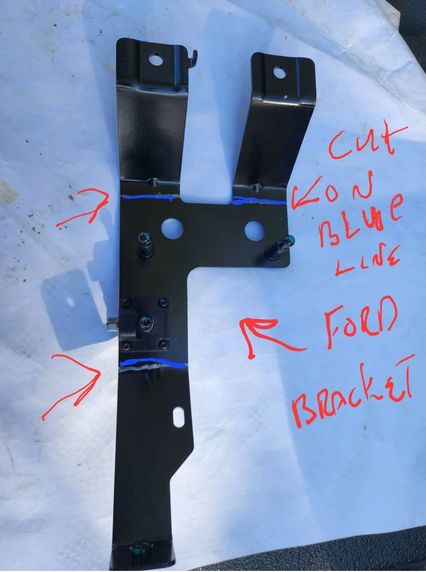

First pic Ford bracket needs cut on blue lines.

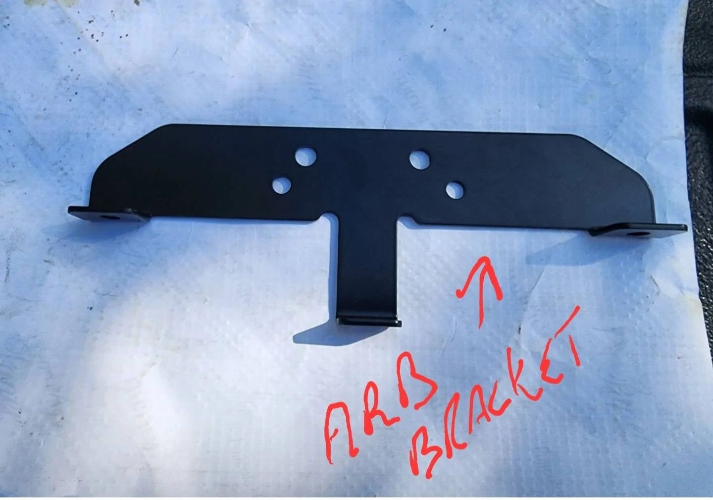

Second pic ARB bracket

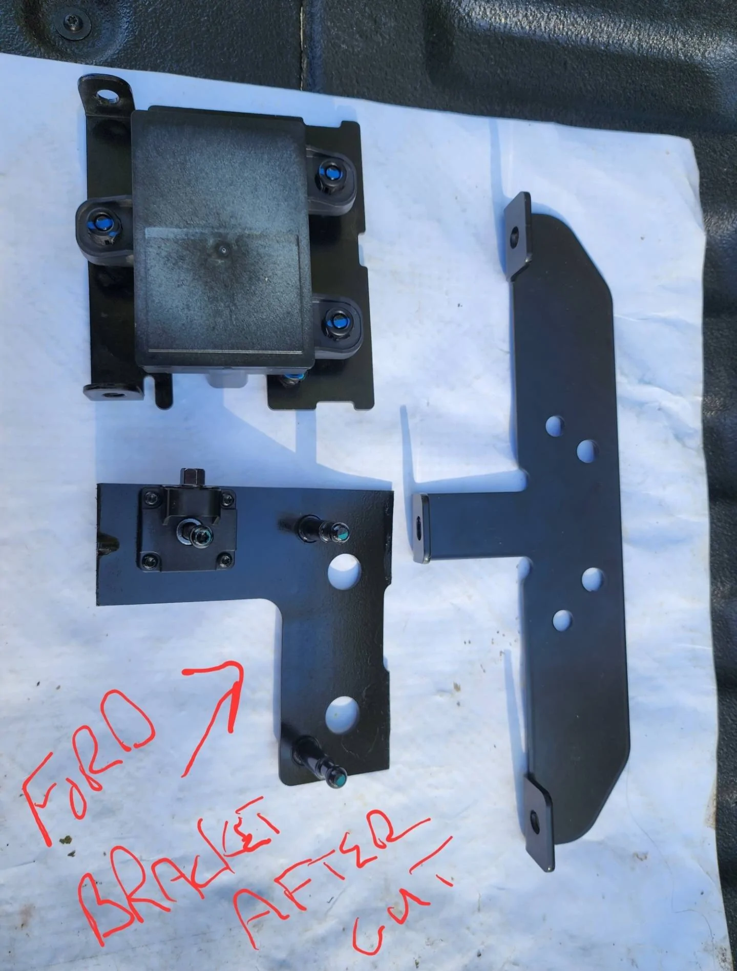

Third pic Ford bracket cut with ARB bracket and radar unit

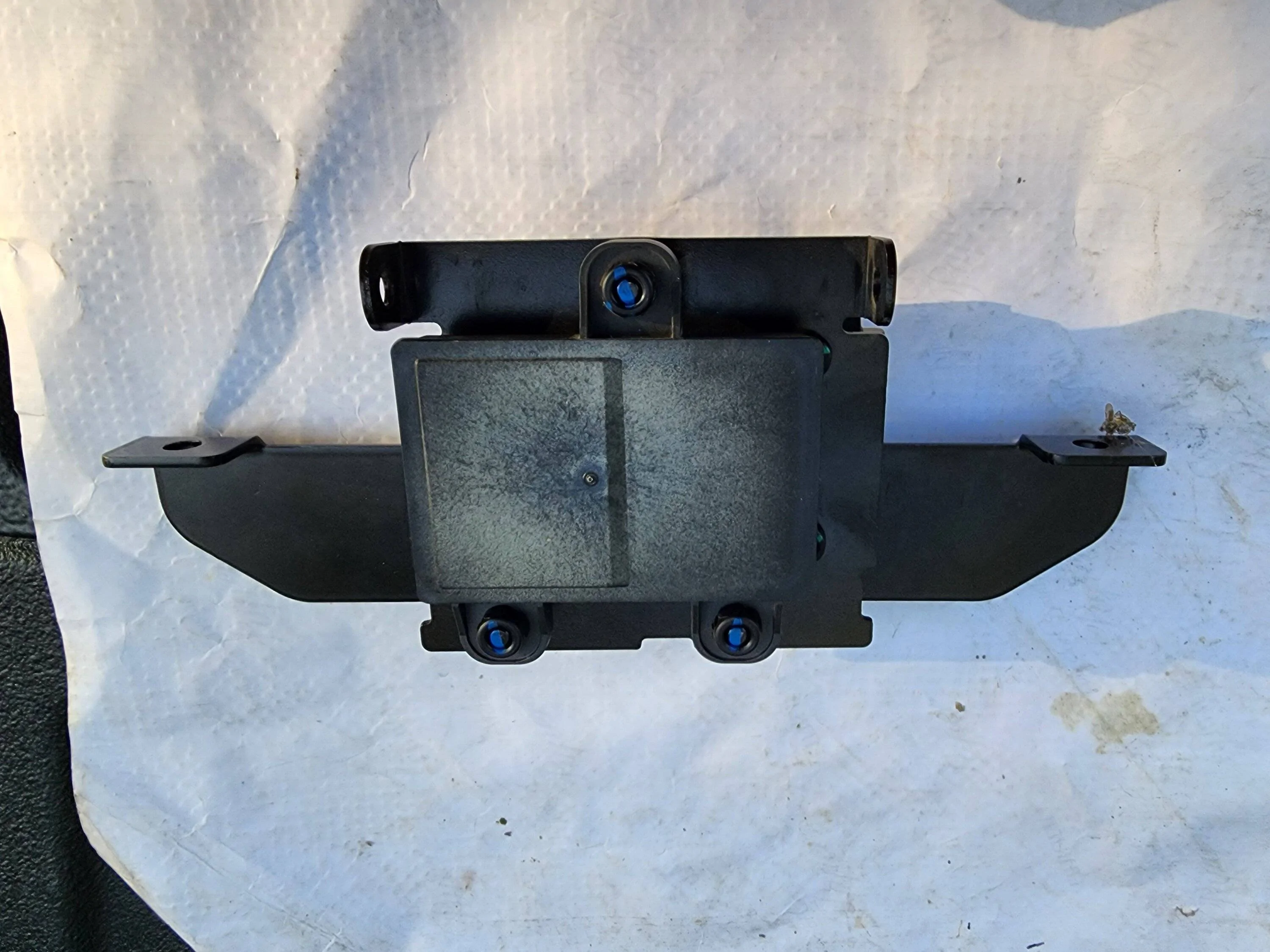

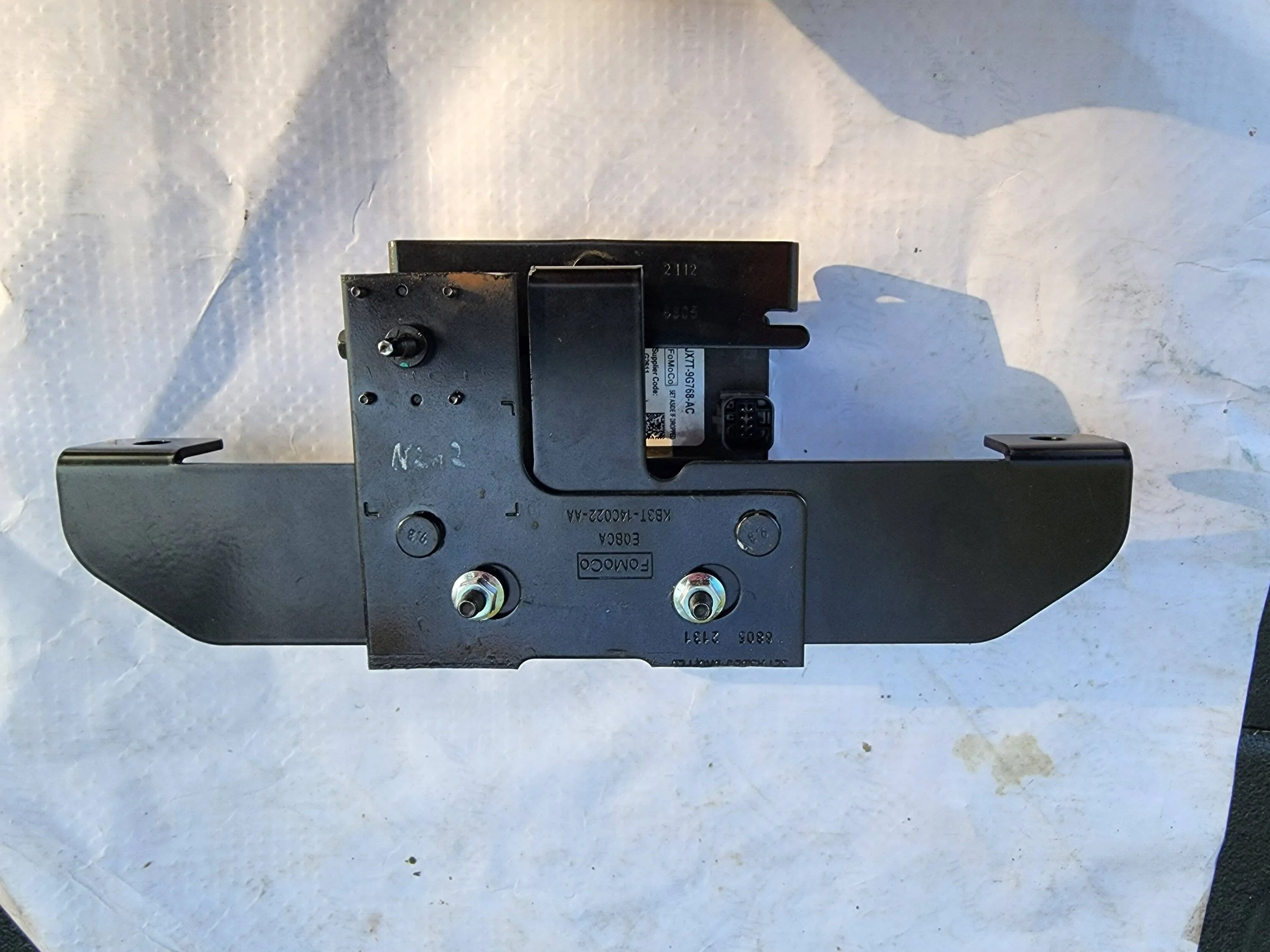

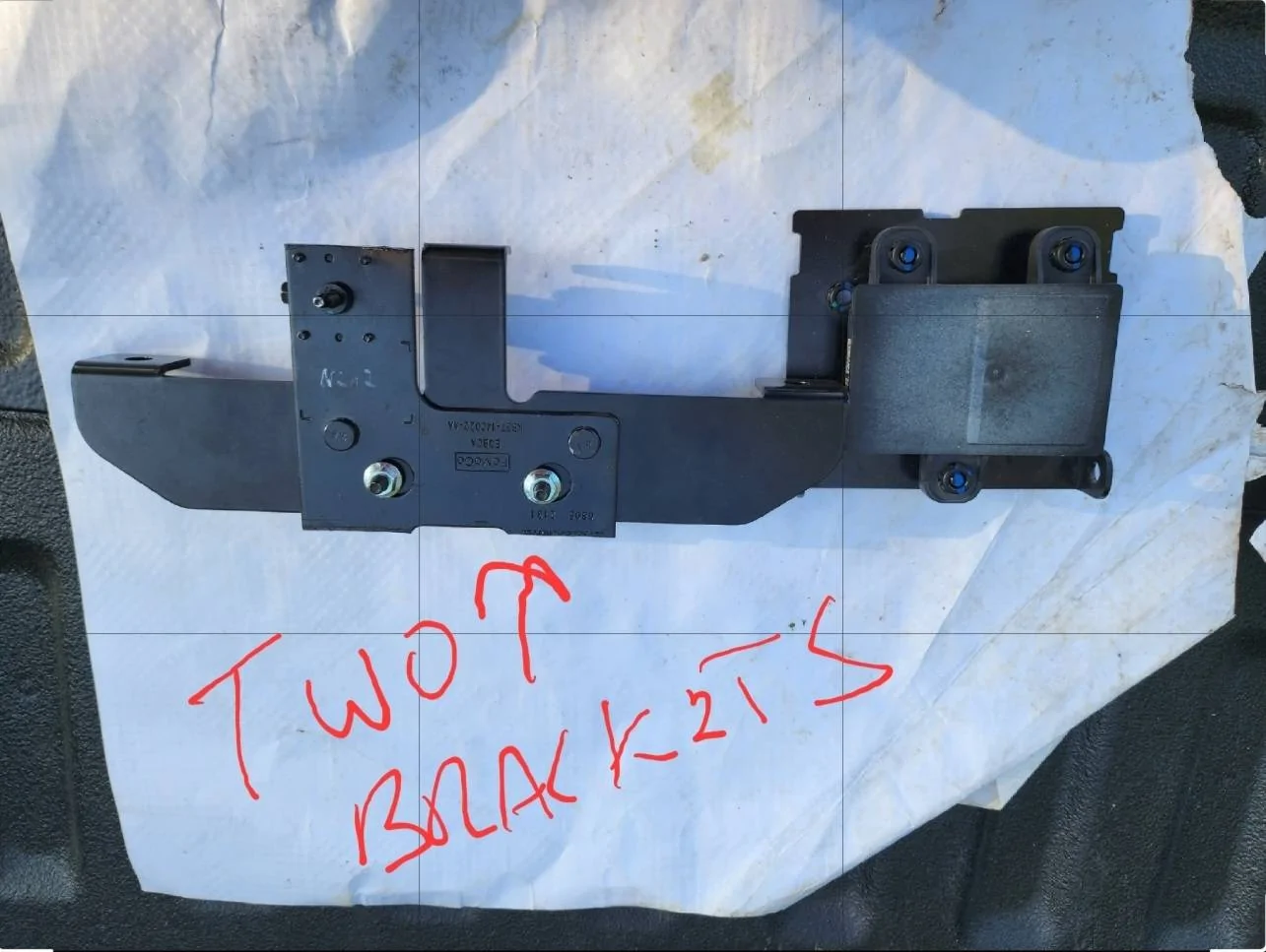

Fourth pic the Ford and ARB brackets combined
Last pics unit complete
