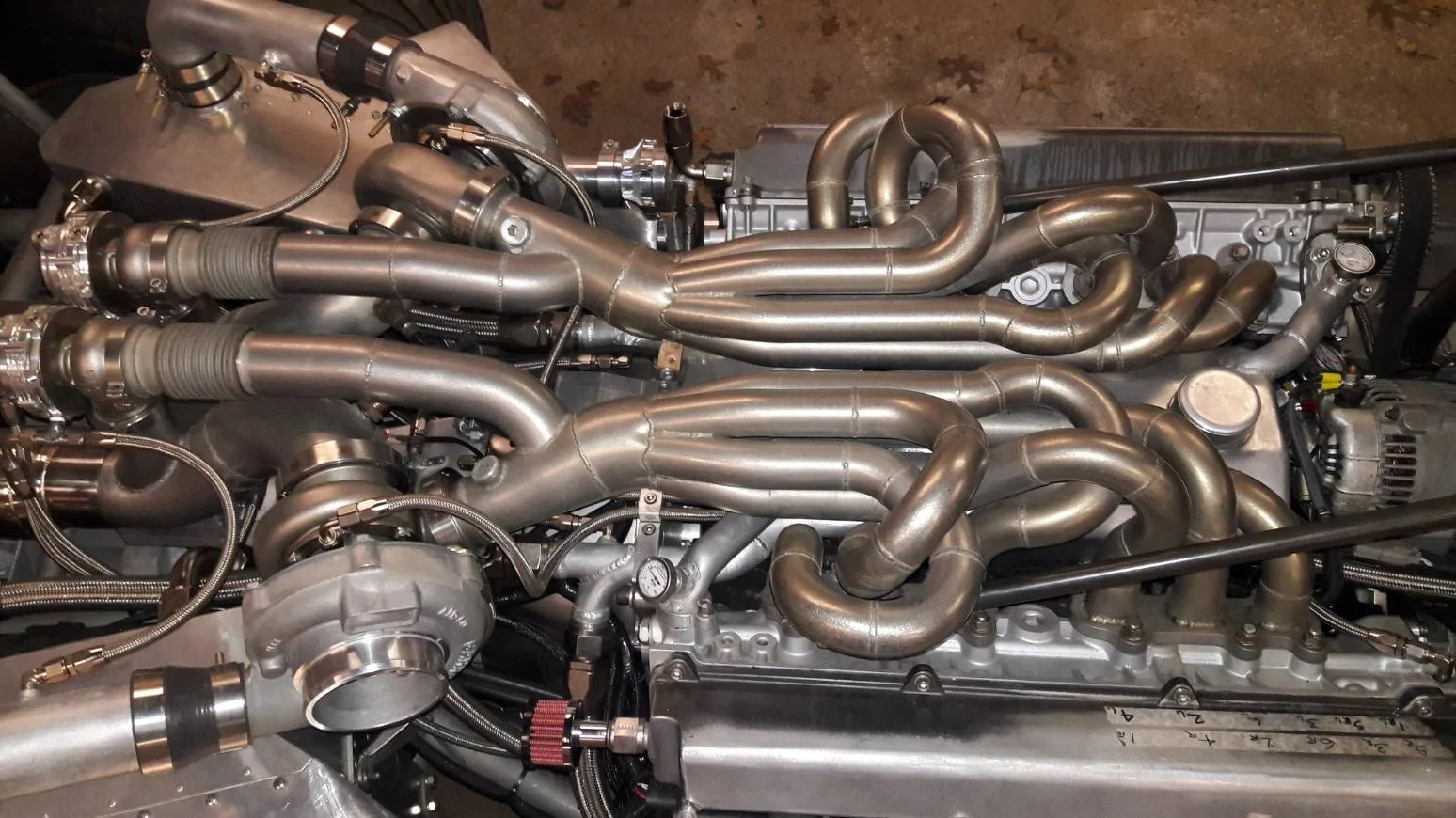

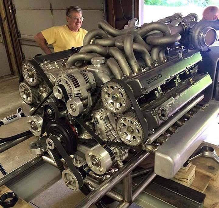

Also notice the heads are inverted, with intake manifold at the bottom and the headers rising from the typical "intake valley" between the heads of as V style engine! Such a tight fit for the headers. Some serious out of the box thinking going on. Also note the headers grouped in sets of 3. Two V6s back to back to make the V12.
