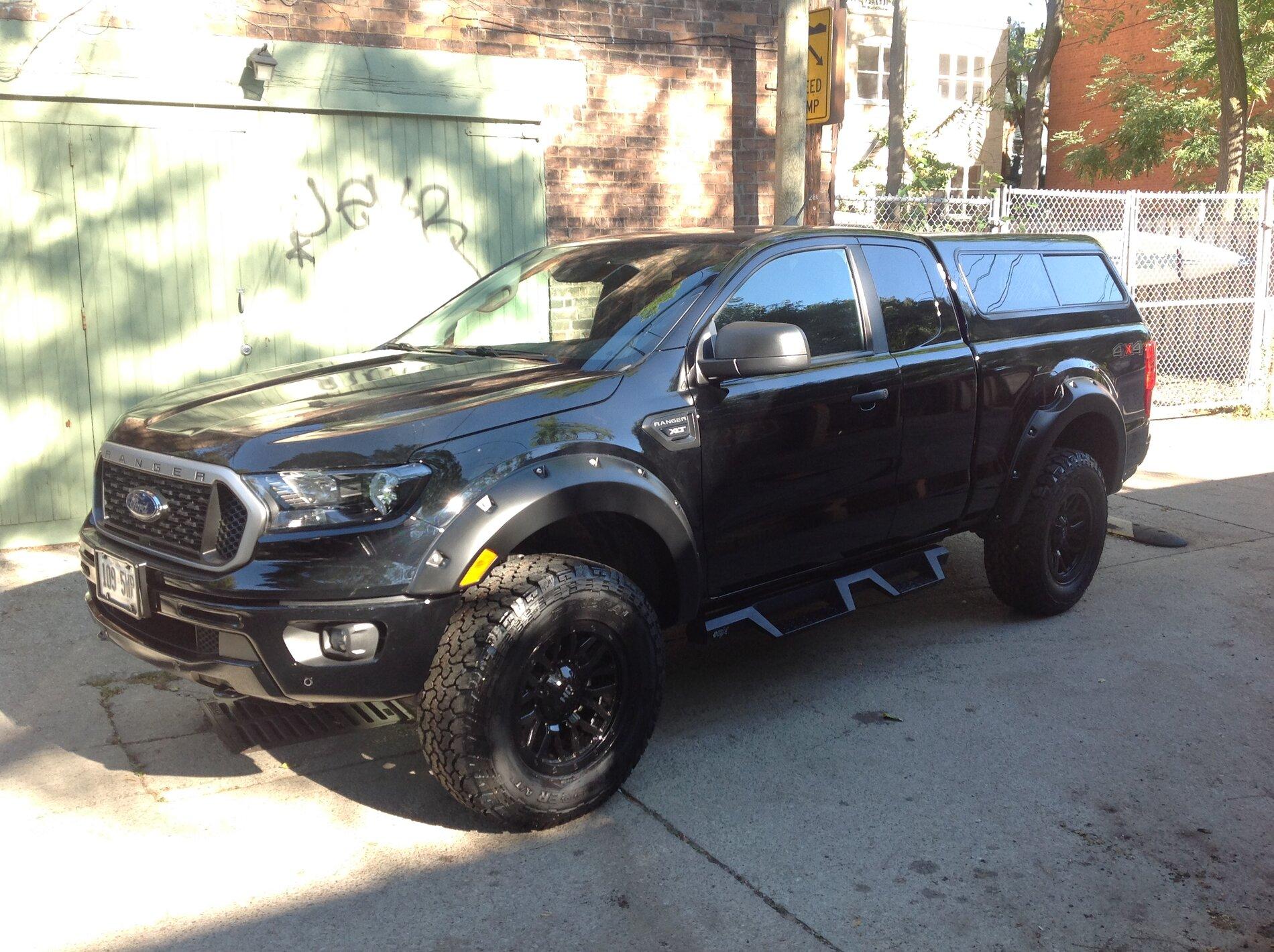

Between yard work and some shopping I managed to resolve the strut issue and get True North levelled. There's a way to install level kits by removing the lower control arm from the frame and removing the tie rod end - I couldn't usee myself doing that without a hoist, so I did it like most folks. There are few things to make this easier:
  • Remove the caliber and rotor - they are crazy heavy when heavy is what you don't need
  • Remove the axle nut and push the CV out of the way
  • Remove the sway bar link from the knuckle
  • Absolutely remove the lower studs from the strut

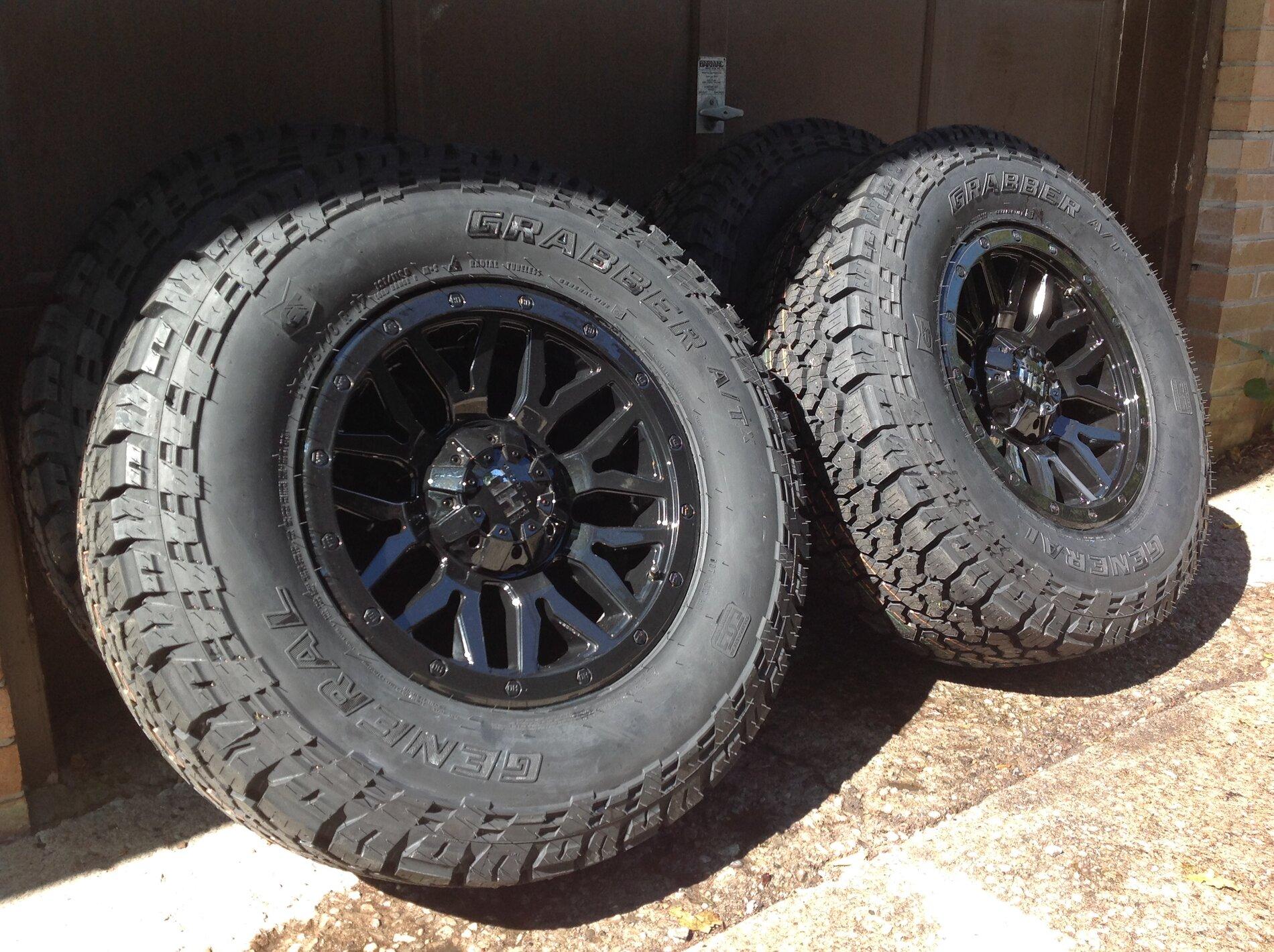

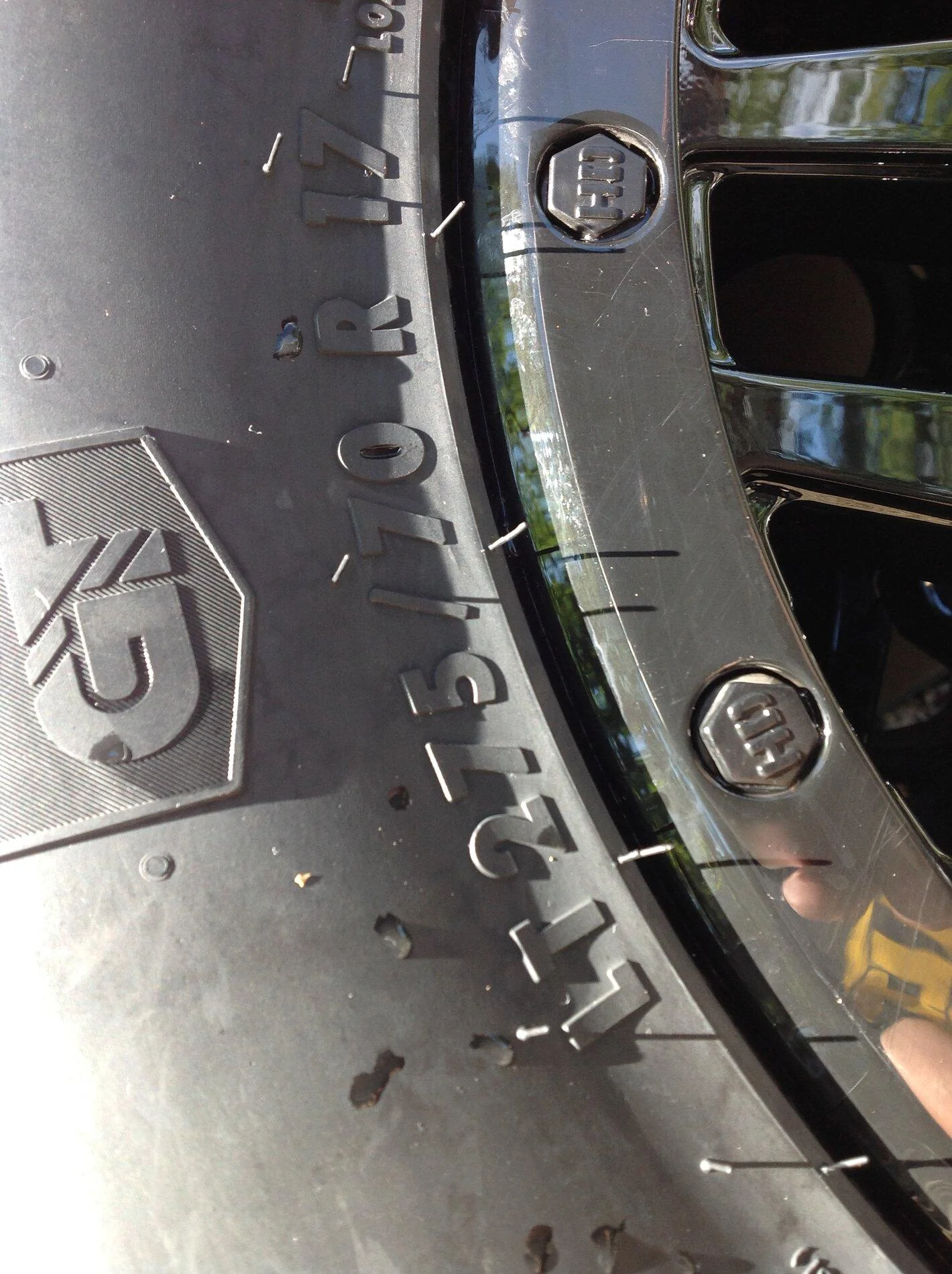

General Grabber A/T 275/70R17

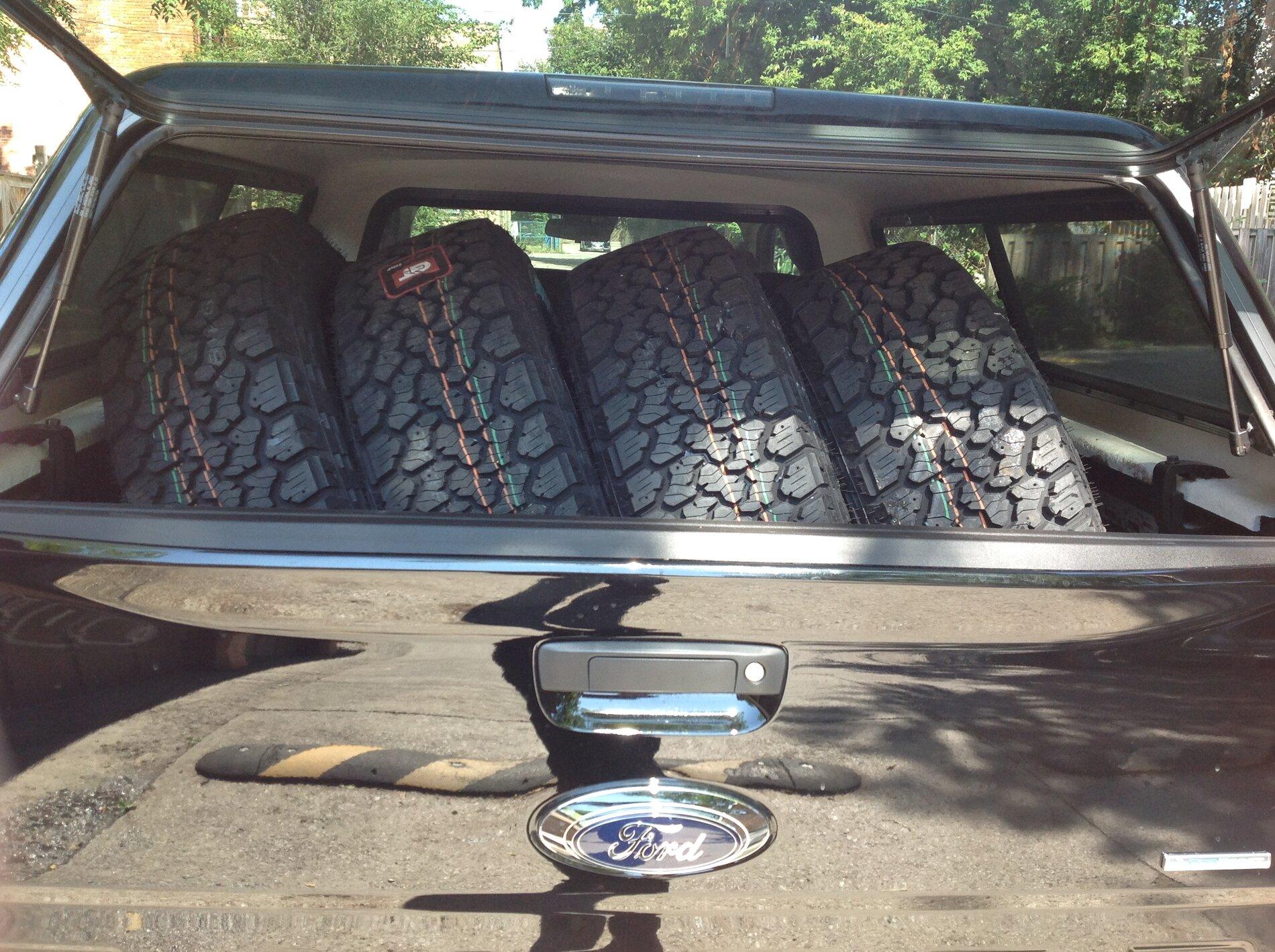

Wow, these are a lot of tire - a full 32.2". My dealer could not get Falken's or BFG KO2s (back order) but I am more than pleased with the look of these big tires.
Menace 17x8 +15mm Offset

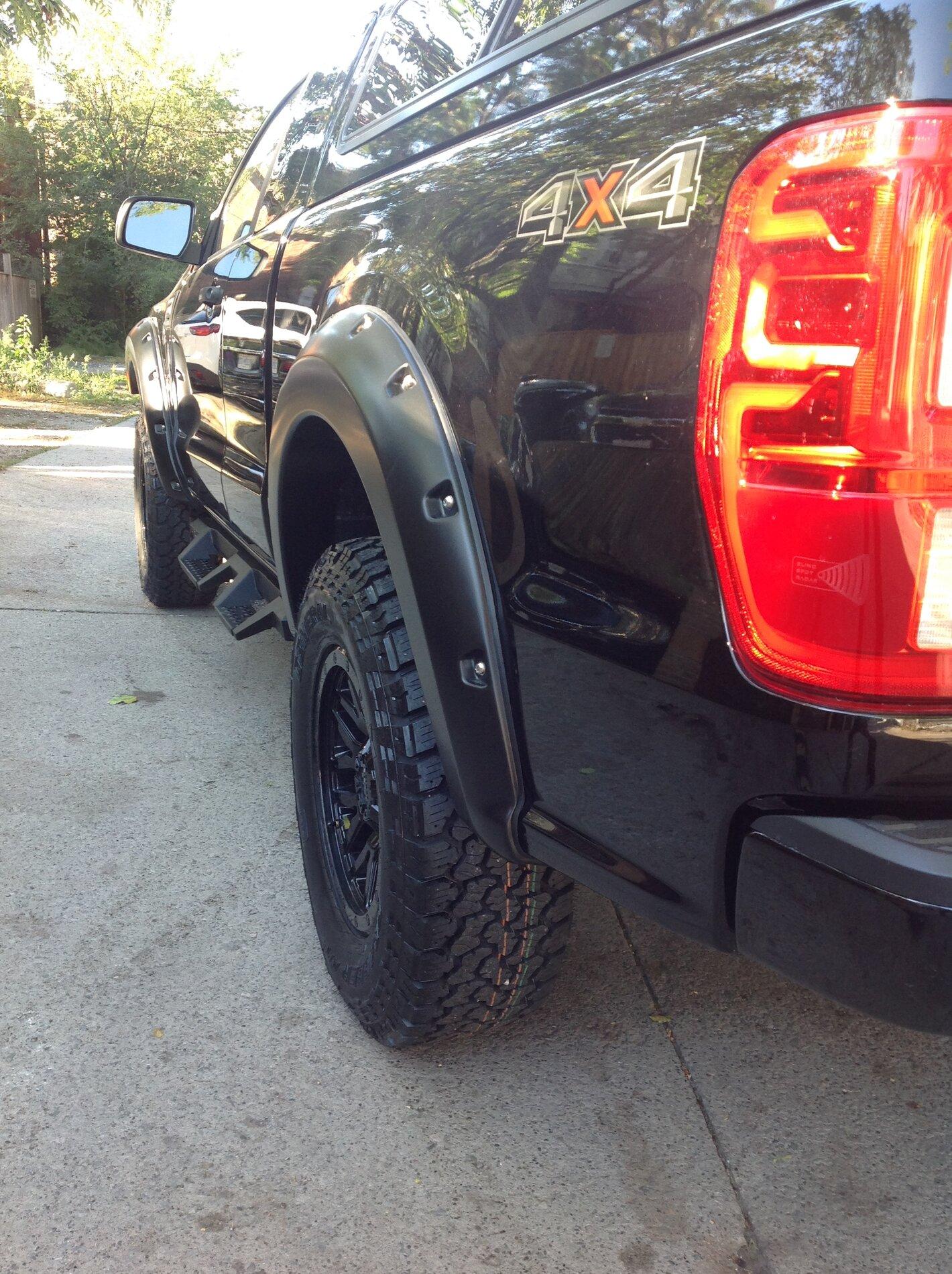

Enough offset to more than clear the knuckle (actually further than the stock wheels) and push those tires out to just inside the fender Flares. Gloss Black for a Shadow Black Ranger.
Note: No rubbing at full lock, no cutting, no trimming. I loosened and angled the intrusion bars and removed the plastic covers while I was doing the level.

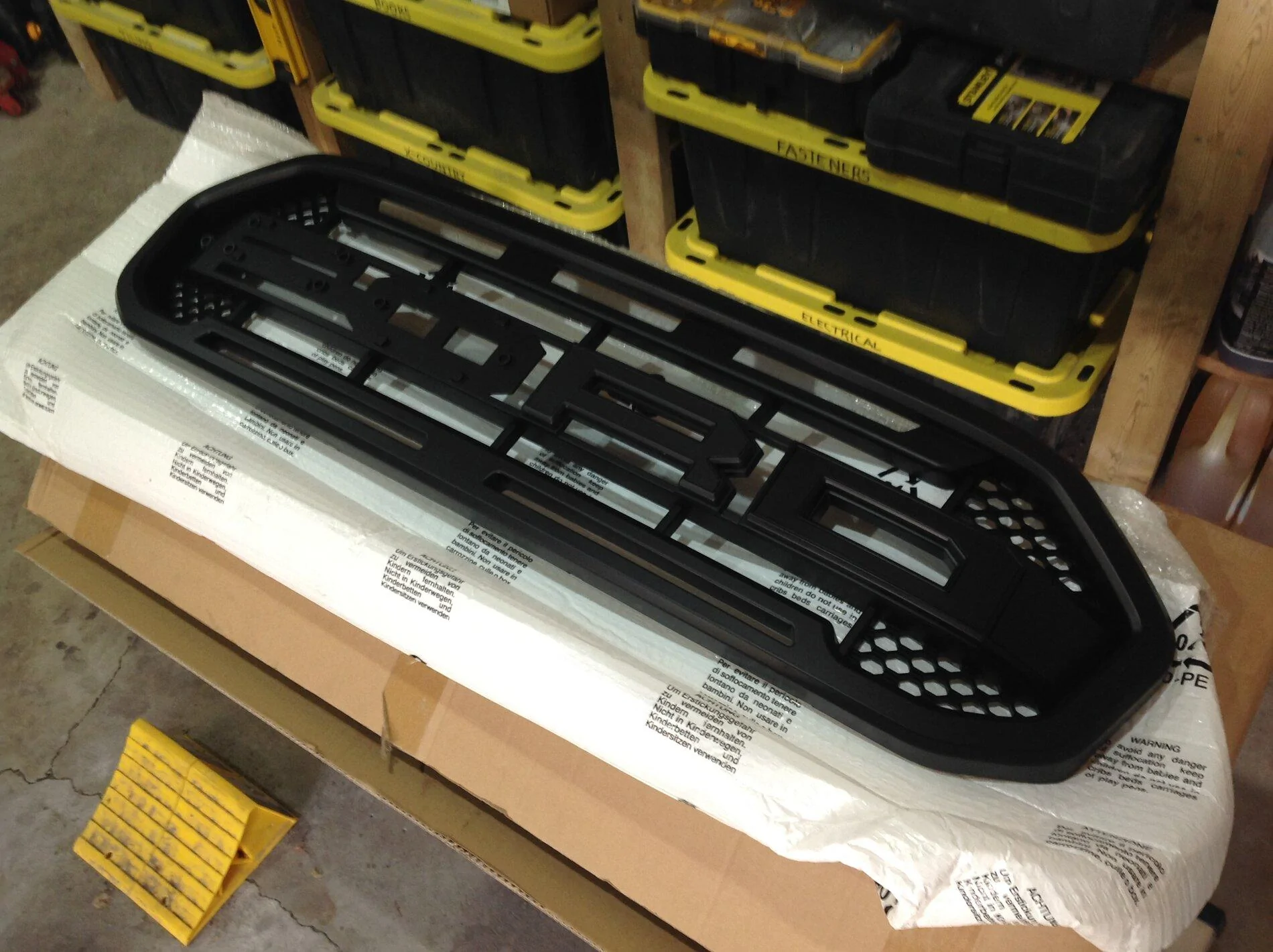

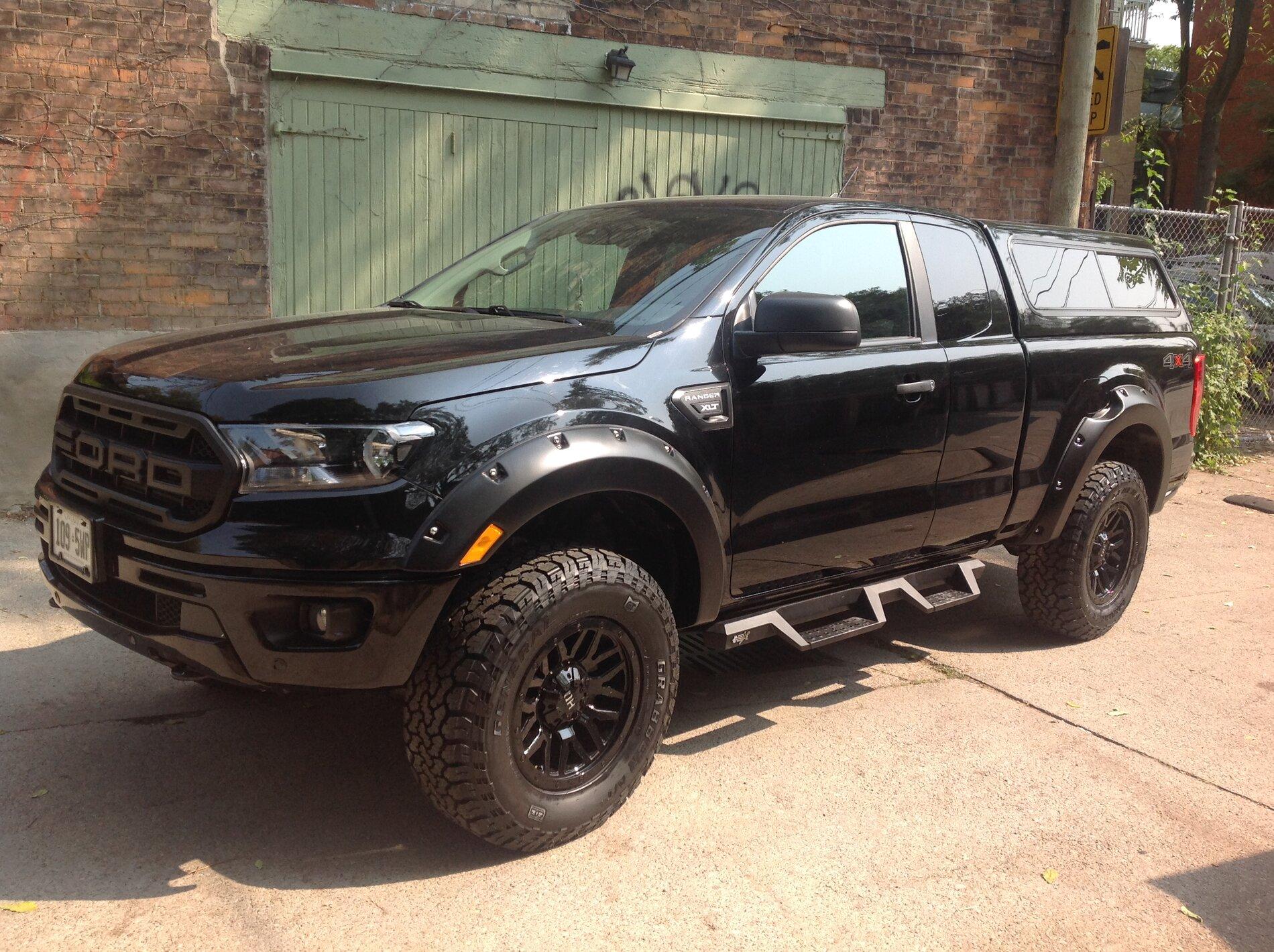

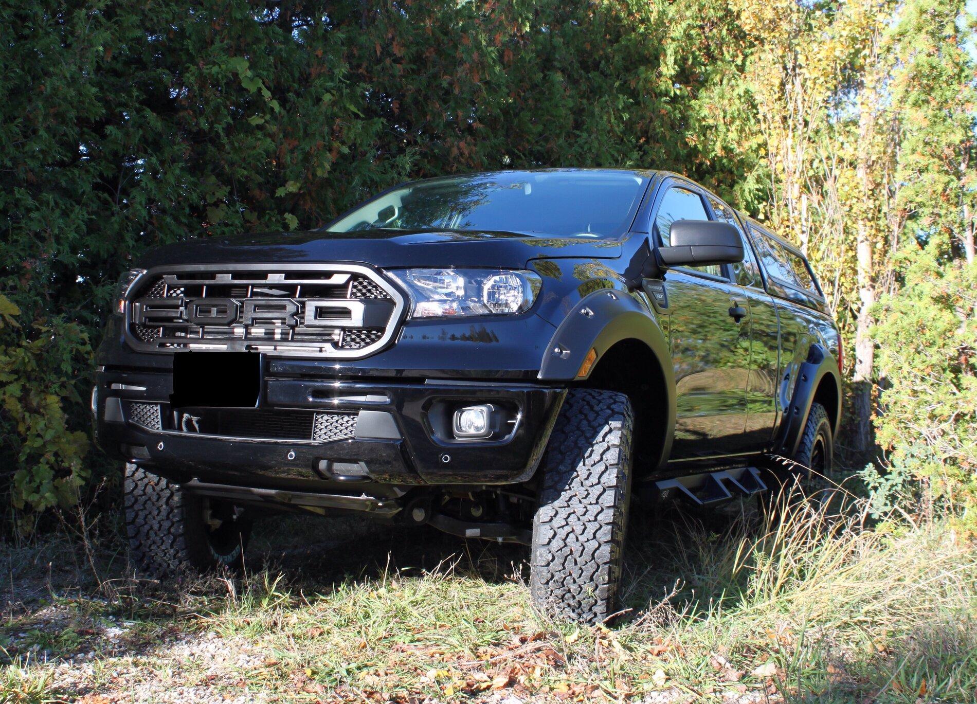

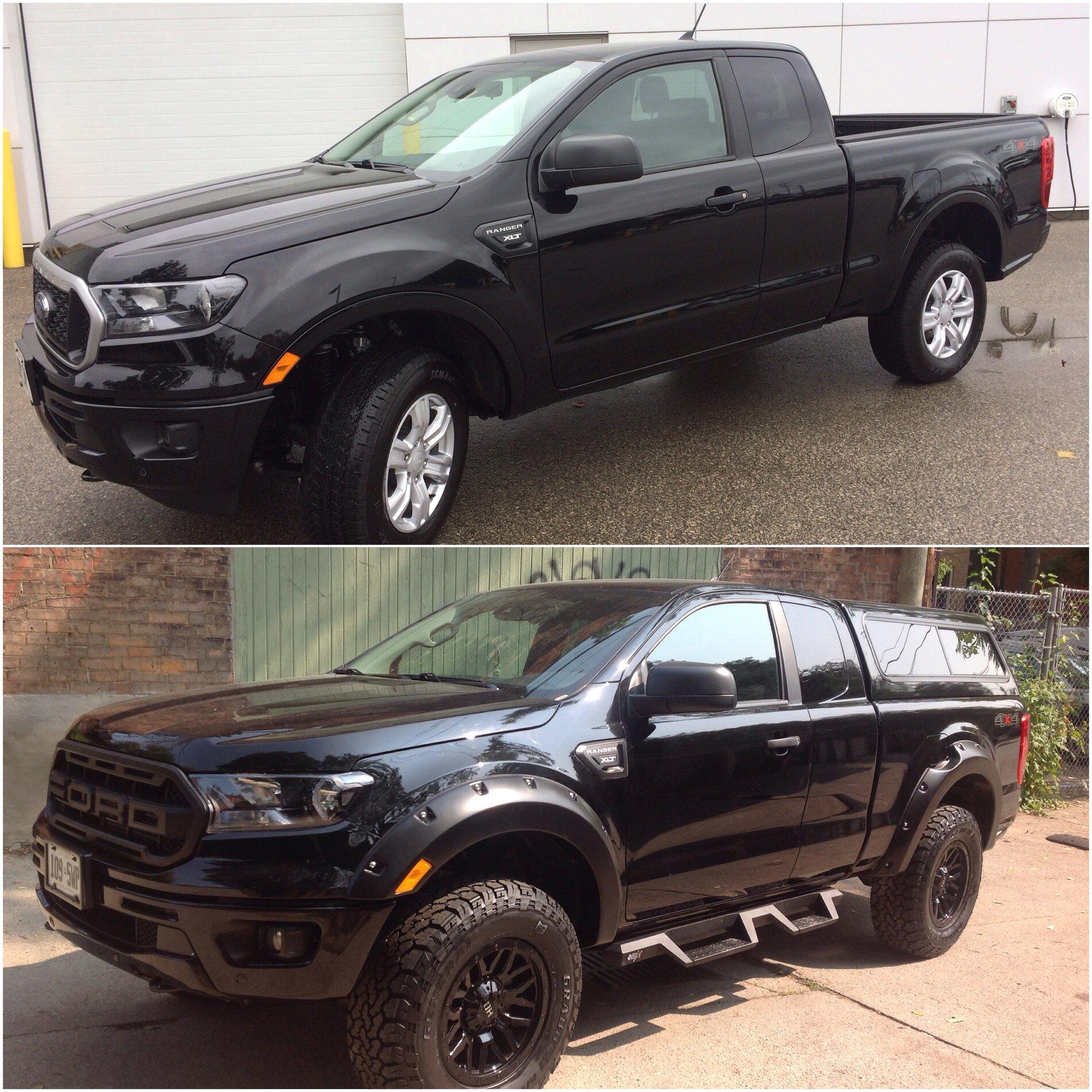

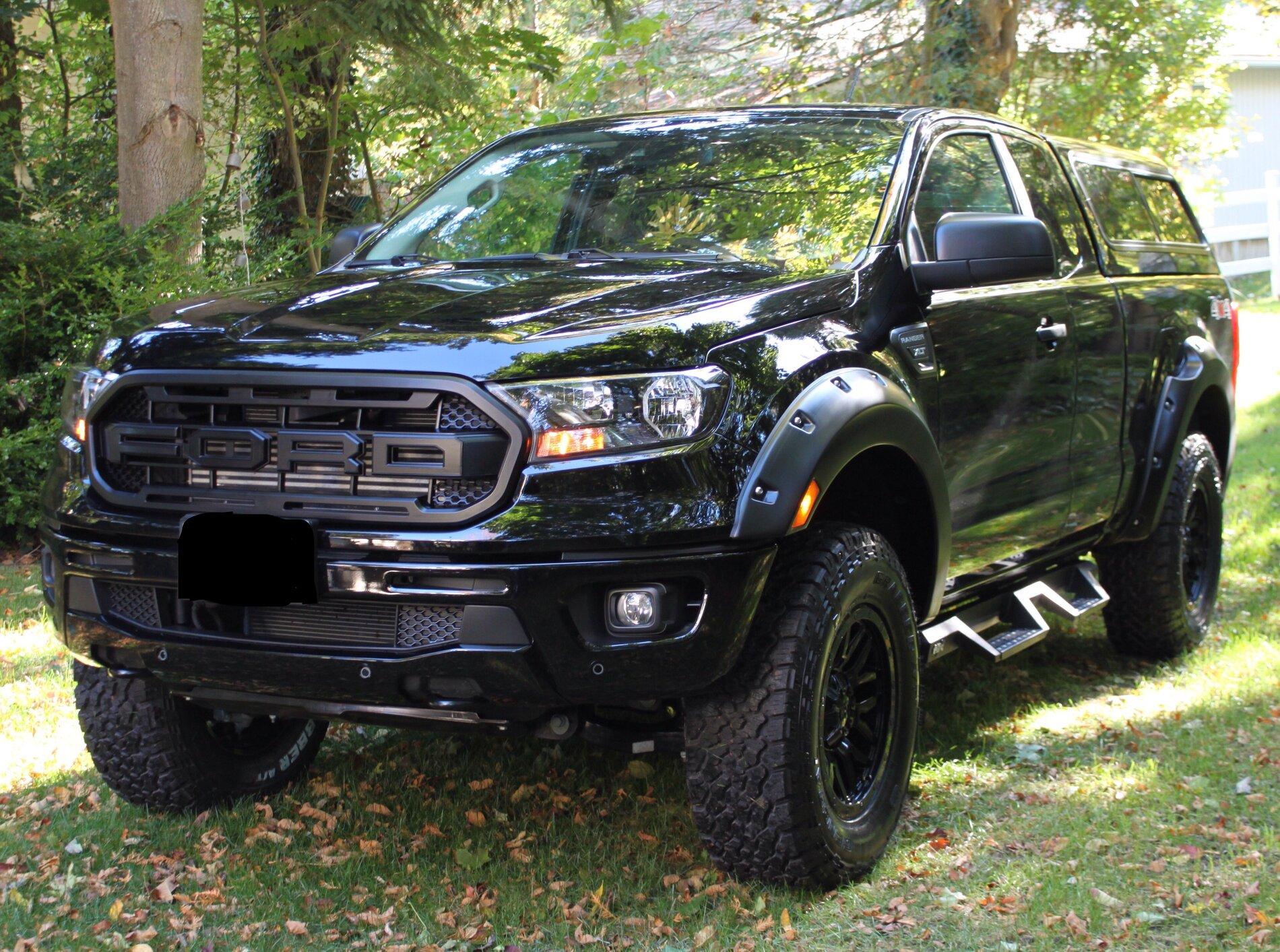

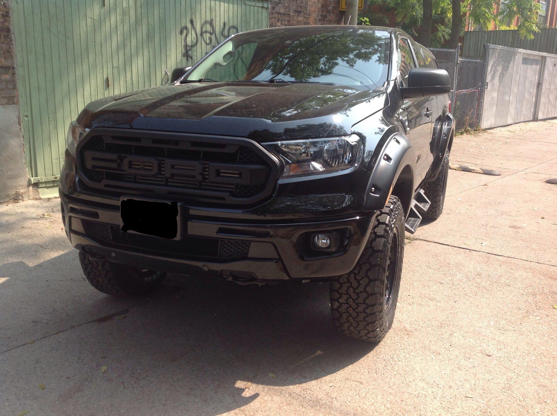

Well, the last item in Phase One of the True North build is now complete. The new grill went on at noon today and it really completes the look on a black truck with black wheels, canopy, drop steps, etc.
So, that's it for a while - Phase Two will include a few things that help a work truck do its job while looking a bit like an adventure rig. Stay tuned!
Here's a little before and after pic...
Well Duke you can't even tell its the same truck. I mean that in a good way. Congratulations that is a gorgeous looking Truck :like:

Wow, that is quite the transformation. Your hard work has certainly paid off! Looks terrific!

Sweet looking truck! Very nice work, mate.
Where did you buy your steps and grill in Canada? Love them.

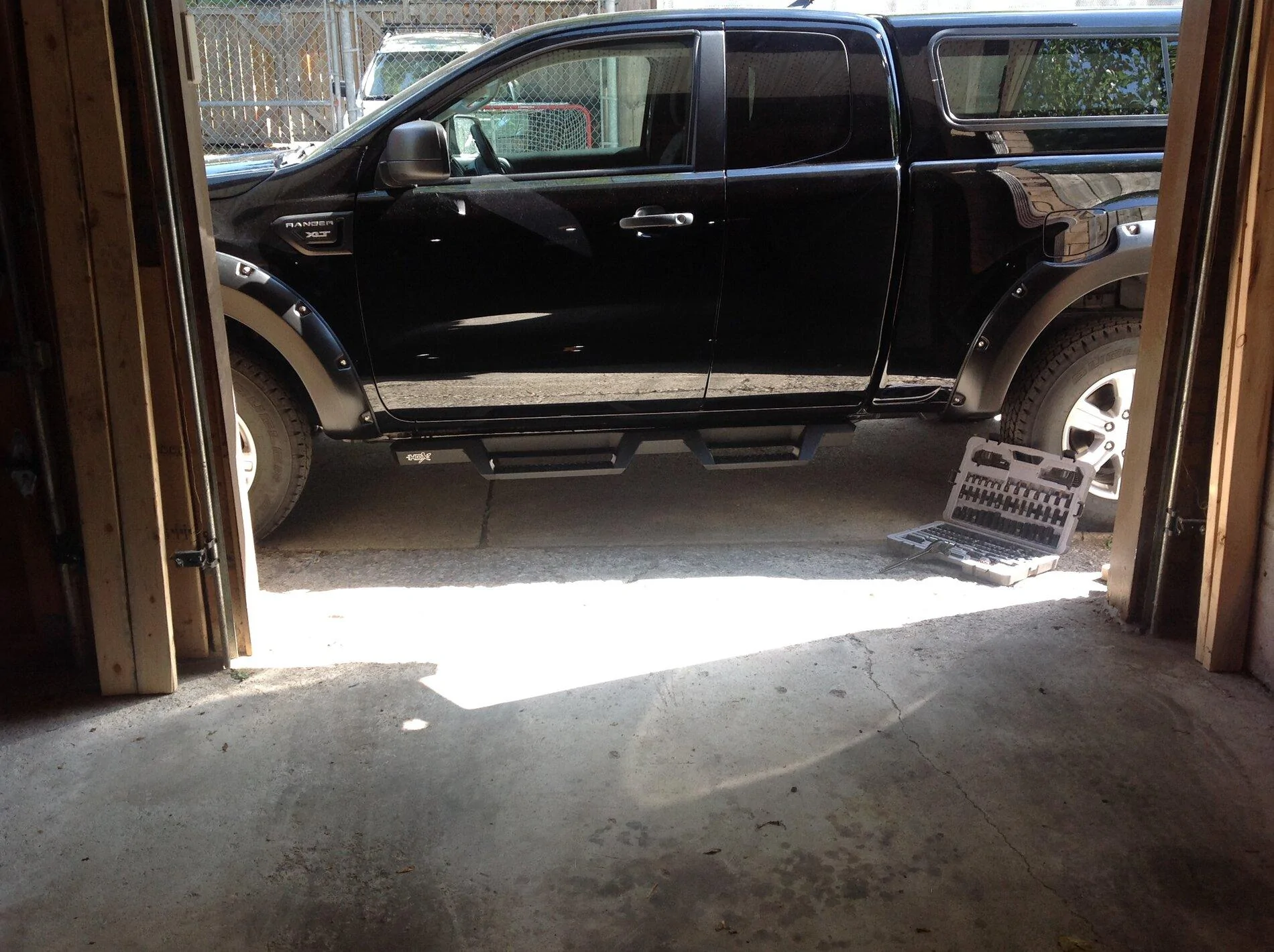

Rhino Rack Pioneer Platform
Well, like a lot of mods or accessories, this install is better suited for help from an extra person - preferably someone who has done it before. The toughest part is figuring out just where to drill the holes in your expensive canopy. Second toughest is wresting the platform on and off to dry-fit things before that moment of truth with your drill.
Hats off to Rhino Rack for good packaging, an easy install and a great design that offers a bit of forgiveness if your mounting legs aren't perfectly square.

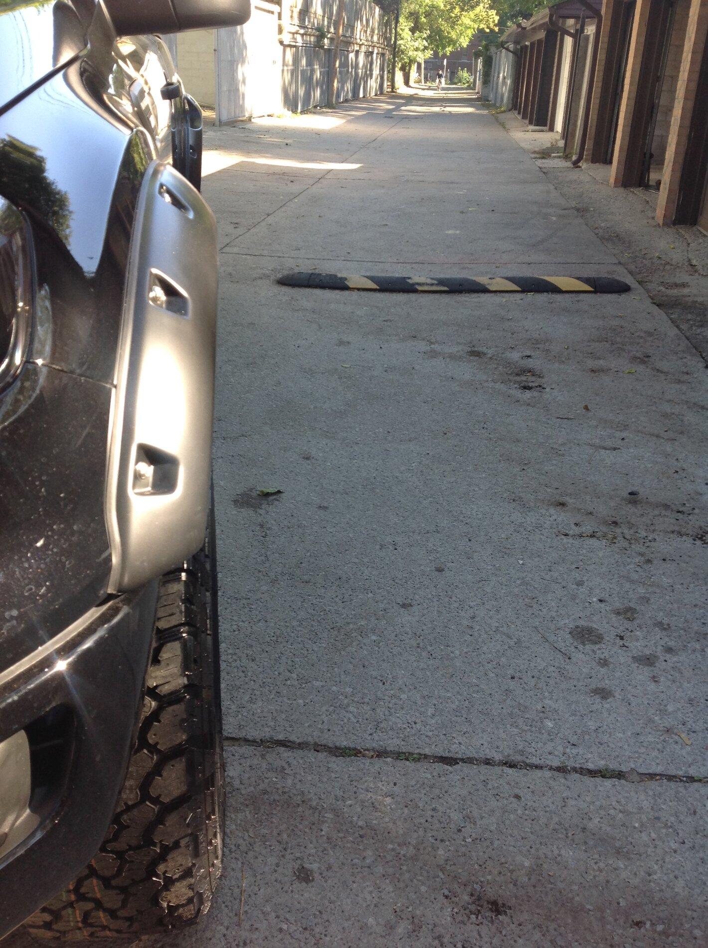

Please forgive the completely naive question...how Is it your new wheel/tire combo is further back than stock? I’m still learning about offset etc so I’m most likely missing something. Seems the stock wheels and the new wheels are both 17X8 with the only difference being 40 mm less offset in the new wheels. The new tires are 0.8 inches wider (0.4 inches (10.4 mm) either side of center). So if the center line of the wheel is moved out by 40 mm and the back edge of the tire is 10.4 mm further inboard than stock it seems you should have more room than the stock set up?
Also - 2” leveling kit and crash bars in tact?
Looks amazing - wish I had your mechanical skills, I’d likely kill myself trying to install a leveling kit!
Menace HD 17x8 +15mm Offset
These wheels have enough offset to allow 275s to more than clear the knuckle (actually further than the stock wheels) and push those tires out to just inside the fender Flares. Gloss Black for a Shadow Black Ranger.
Note...
No rubbing at full lock, no cutting, no trimming. I loosened and angled the intrusion bars and removed the plastic covers while the wheels were off.

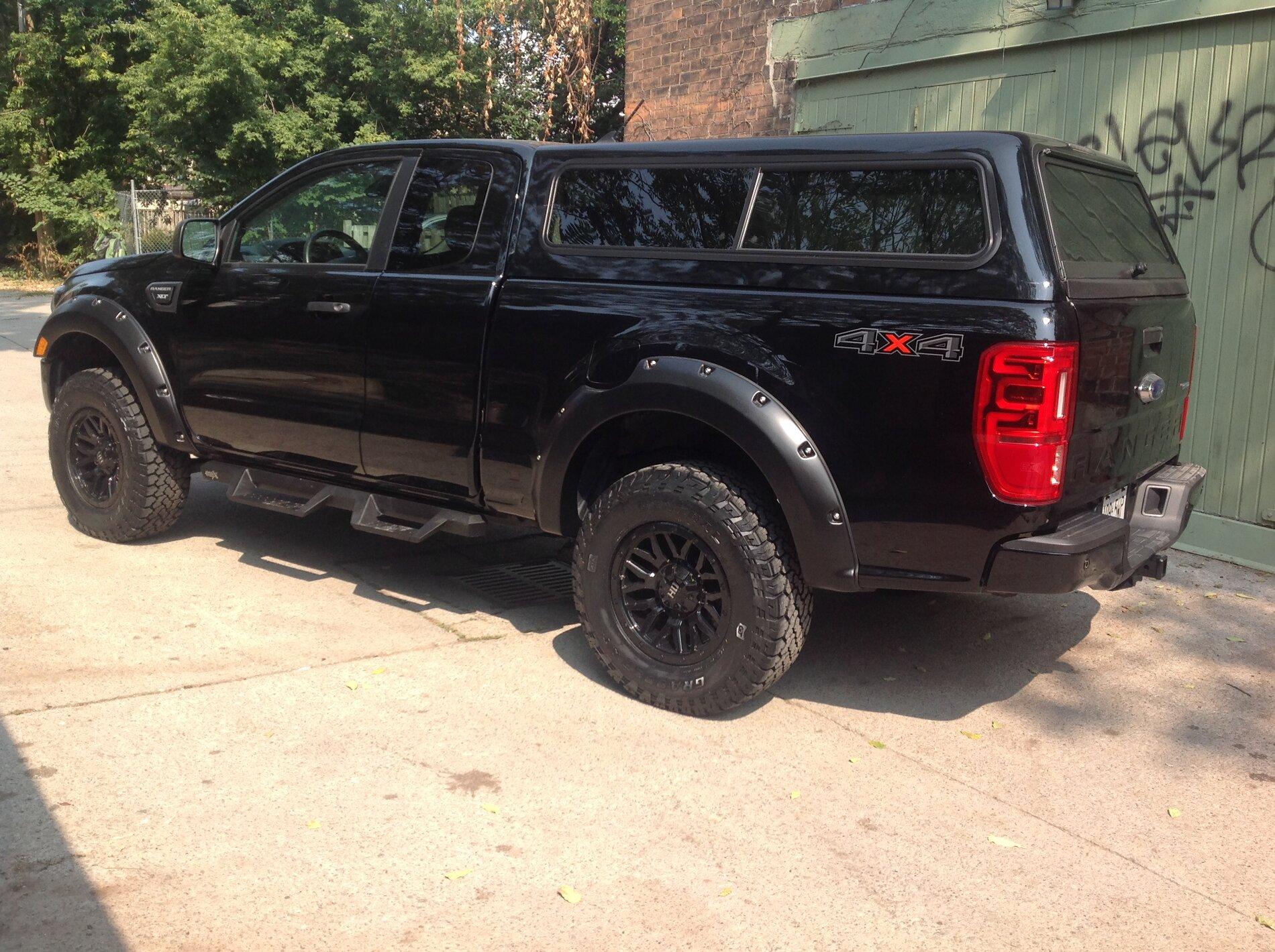

General Grabber A/T X (275/70R17)
This is the main reason I levelled True North - the agessive stance of wider, taller tires. Wow, these Grabbers are a lot of tire - a full 32". My dealer couldn't get Falken Wildpeaks or BFG KO2s (back order) but I am more than impressed with the look of these big tires.
Note...
FYI - Because people on these forums ask...
Before I installed the level kit, I put the wheels on the front just to see if they would clear the crash bars without the lift - they DO NOT and if you try it, they still won't. If you want 32s, level your Ranger.
Up next...
But first, True North needs a bath - I need a beer - it's happy hour and just about time to start the BBQ.

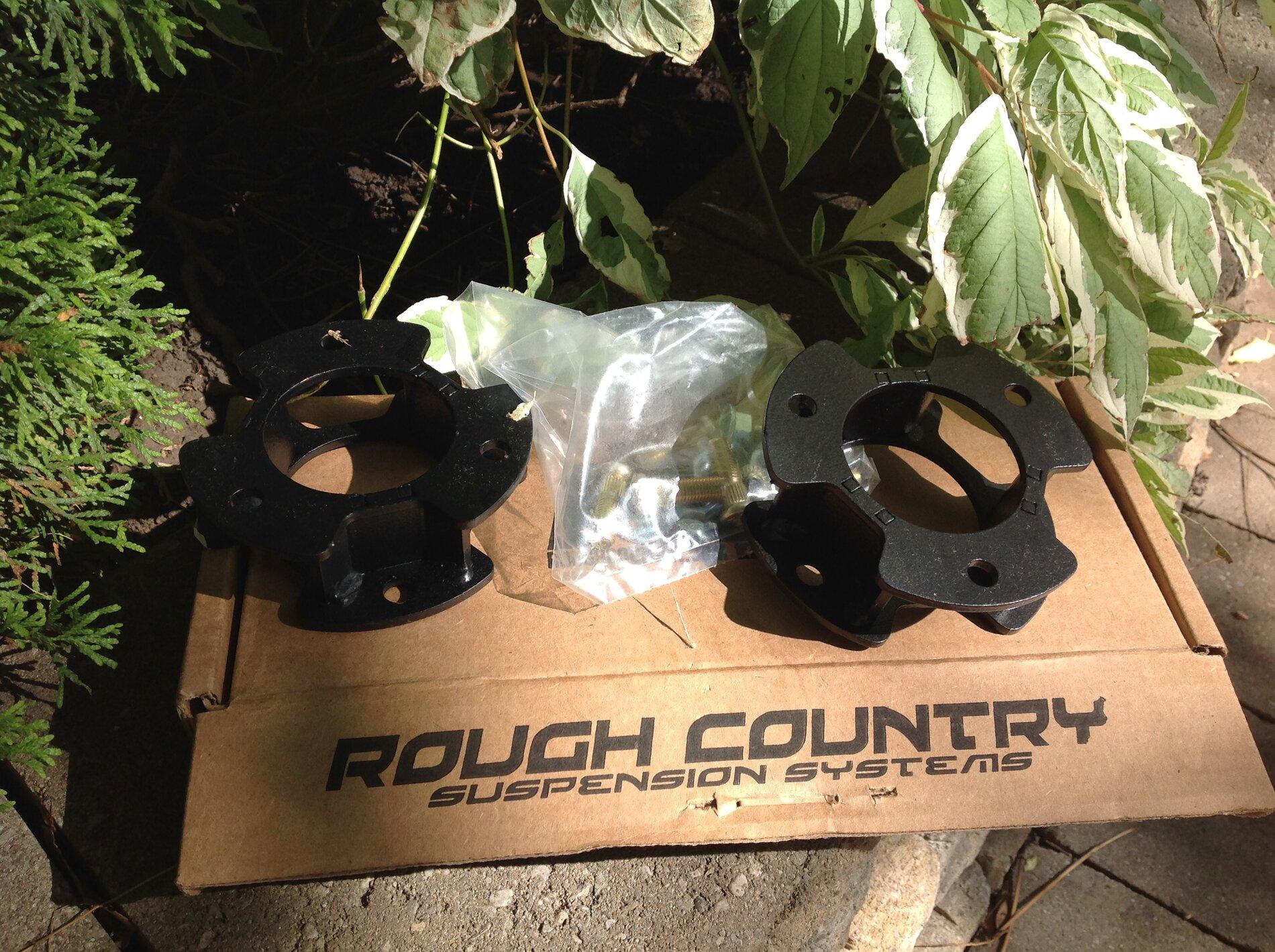

Rough Country 2-1/2" Level Kit
Between yard work and some shopping I managed to resolve the strut issue and get True North levelled. There's a way to install level kits by removing the lower control arm from the frame and removing the tie rod end - I couldn't see myself doing that without a hoist, so I did it like most folks - unfasten the upper ball joint and tie rod end. There are a few things that help make this a lot easier:
  • Remove the caliper and rotor - they are crazy heavy when heavy is what you don't need - especially at re-assembly
  • Remove the axle nut and push the CV out of the knuckle and tuck it out of the way - I zip tied mine to the sway bar
  • Remove the sway bar link from the knuckle and loosen both sway bar mounts
  • Remove the lower studs from the strut! Got a press? Use it. No press? Then thread the nuts back on the stud, upside down, and have at it with a heavy hammer.
Sure, these steps add a bit of extra time and effort, but they make it so easy to move the knuckle around and to get that upper ball joint re-attached. You also won't pop your CV or a sway bar link and you won't get frustrated trying to get your new, taller strut into a space designed for one that's, well, um, 2-1/2" shorter.
Note...
Up next...
